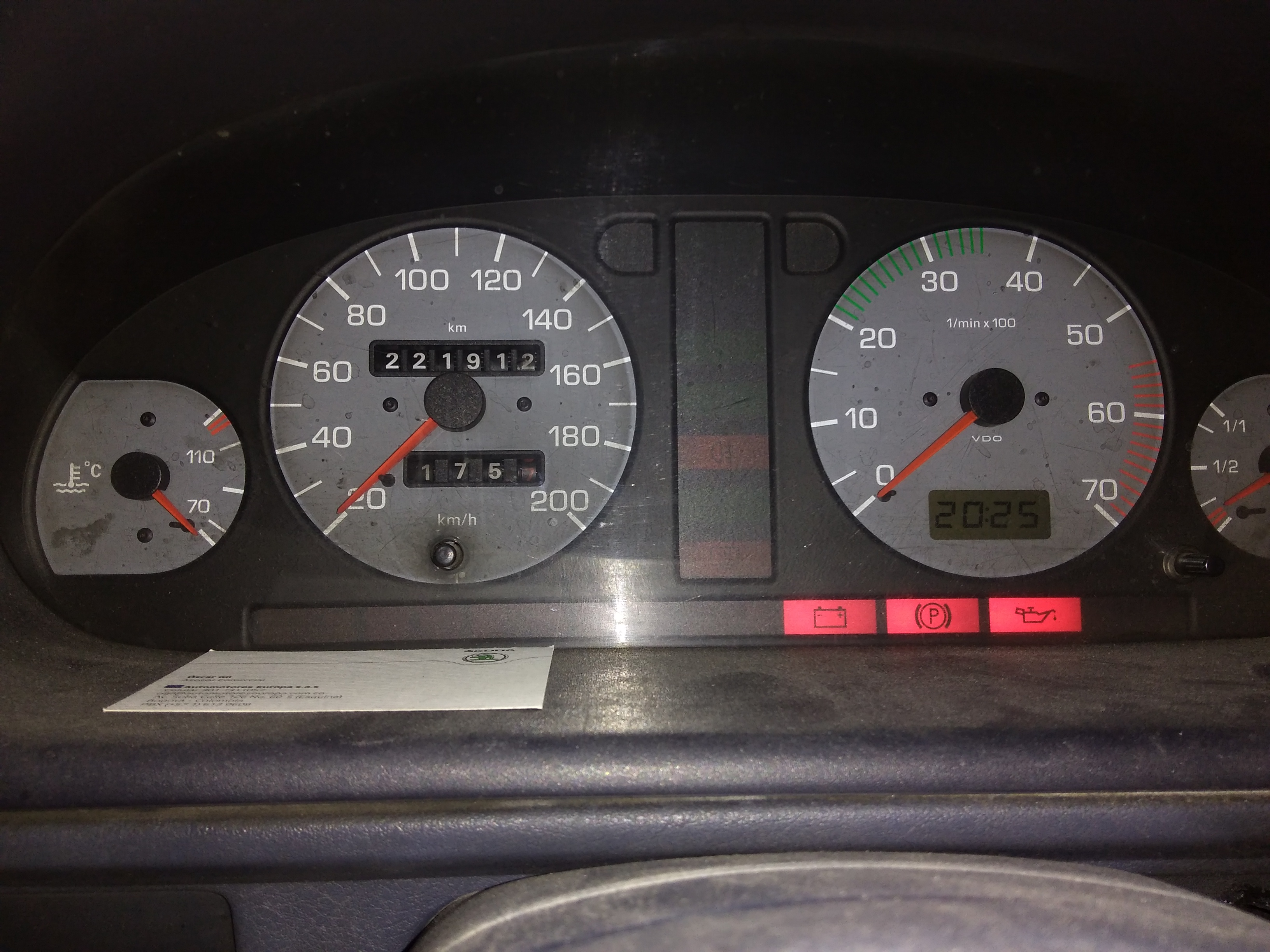

Hello everybody.  This is an old tread, but I was reading this and some other info on the web since my old 1996 Felicia with 220k Km and I decided to dismount the instrument cluster.
I ve found that (i guess)  all bulbs are the original ones.  As described above in this tread, blue and green.
All bulbs lit (indicators and background) but it seems time has made its own wear.  Light seems to be diminished and i found not too bright the inside of the panel. As i ve said.. the years my friends. Time time time..
Anyway the job is halfway. Just some cleaning, checking connections and plug it back on.

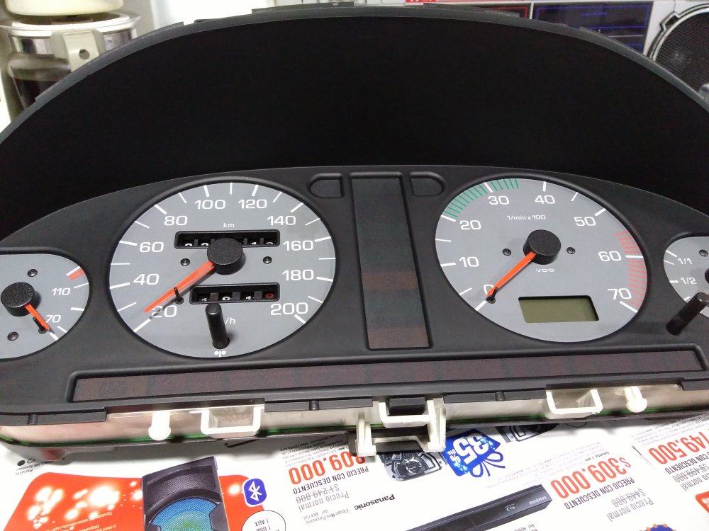

Report: Job done.  Same incandescent bulbs.

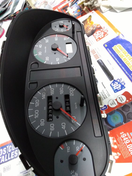

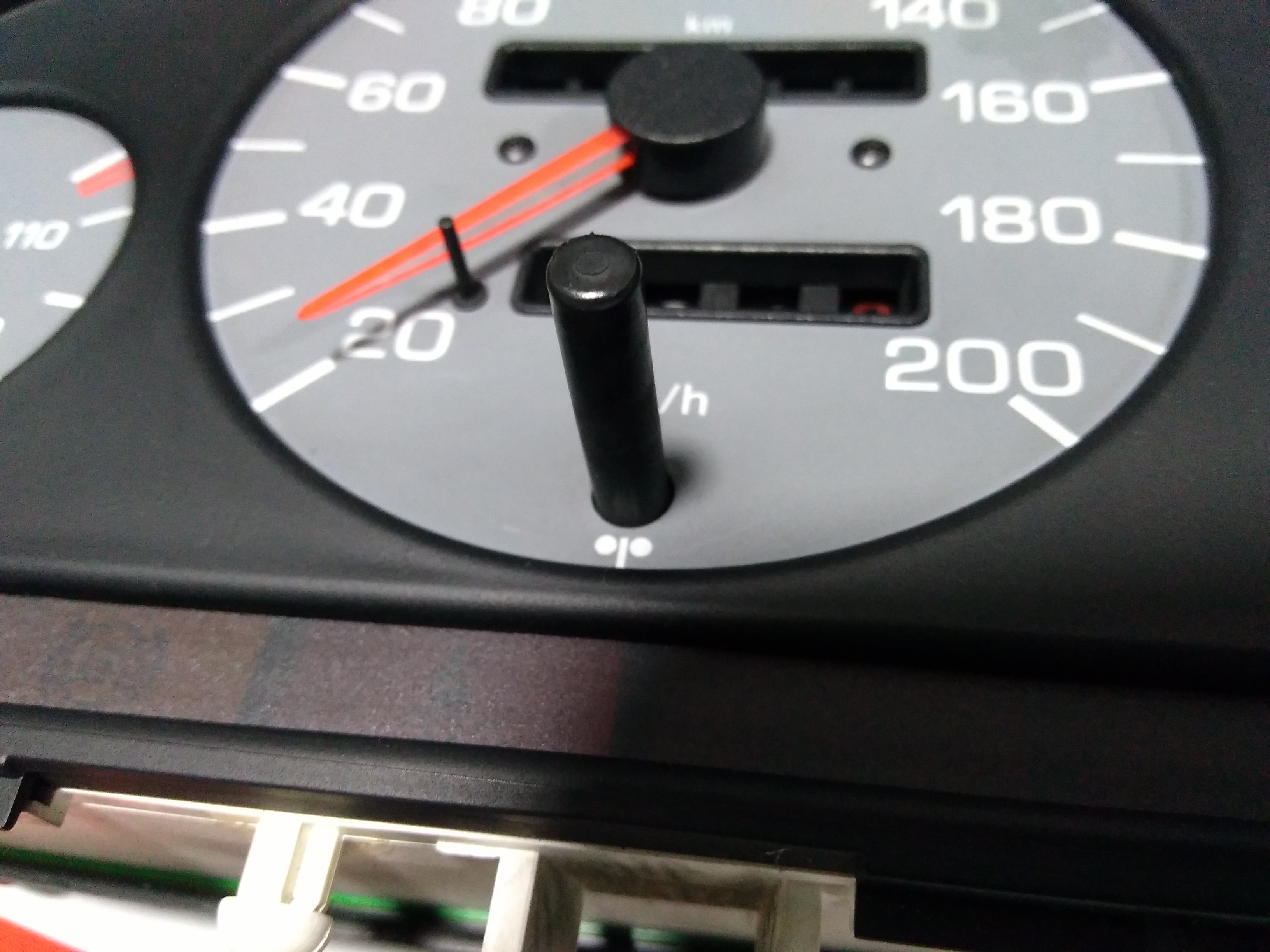

Indicators and background ok.   It took a bit more time cause i noticed the instruments were looking a little dirty.  Of  course  after  2 decades too much contaminated air made a trace.  The cluster is not fully sealed. It has 2 holes,  were the mechanical push resets the partial odo and the control of the digital clock (revs meter model). Those holes act like a vent and catch all the dirt, so the faces of the clocks became cloudy and messy.  Anyway just remove the plastic/acrylic glass by pushing the 5 tabs on the top and loosen it very easy.  A dampf cloth ..(just a part of the cloth)  and clean  very slowly and carefully with the needles. repeated the proces twice and done. Also washed the glass.
Reassembly and ready to go.  Difference is notorious.
Cheers

The cluster prior to dismounting.
Please note the dirt on the reset odo pusher and the clock pusher.
