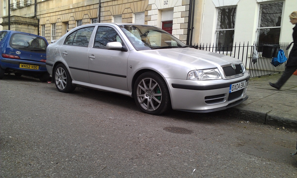

Good luck buddy , post pics of the car as it is sitting from front side etc so we can see if anything looks odd. Seen a few where the car has taken a side hit on the wing and suspension leg has been pushed in.
Get the picture up ASAP but you mention the spring sits off to one side, Even if its been fitted wrong, which I can't see how, it should be straight. Its most likely snapped, which is a common, not major problem.
Hi again. got the car from the garage last night with out the spring being sorted. the chap i bought it from is being very difficult so now I'm going to take it back. The rad is nice and tight but the clattering is still very much there. I assume this must be from the spring. bummer as it has just been MOT'd.
The photos are linked below. sorry they are not very good.
That spring looks like its not for the car..... or broken..... i would Demand money back or tell them you are reporting their MOT tester to VOSA. ;) that will bother them.

From the look in the pic I think that you don't have wrong spring but a broken spring as it looks like it is missing one or more rings which is why it is sitting odd and probably why easy to move under force. A broken spring is common and caused by a seized top mount bearing.
Sent from my Galaxy S3.
That really does not look right, from that angle, Almost like it broken a coil or 2, that has come clean off and the bit that has come off has just been pulled out and chucked..... any chance you could get a photo looking in the spring rest.... where that coil is resting on the bottom of the shock.
Although like i say, that angle is awkward to tell.

cool thanks for having a look. here are the pics attached. I took the near side front calliper and carrier off today and the back pad just fell out. maybe this be the cause of the rattle. should there be a retention clip of something to hold the pad on the piston side back? there was a very un-sticky patch on the back of the pad. which looked like it should have done something. but never seen this before. they are almost new ferodo pads and new disc.
