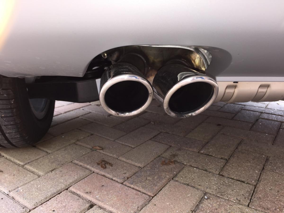

This is interesting, that is after just 2 weeks (they were polished 2 weeks ago)
My Superb never sooted up anywhere near as much (over months) surely a DPF should have stopped this??
