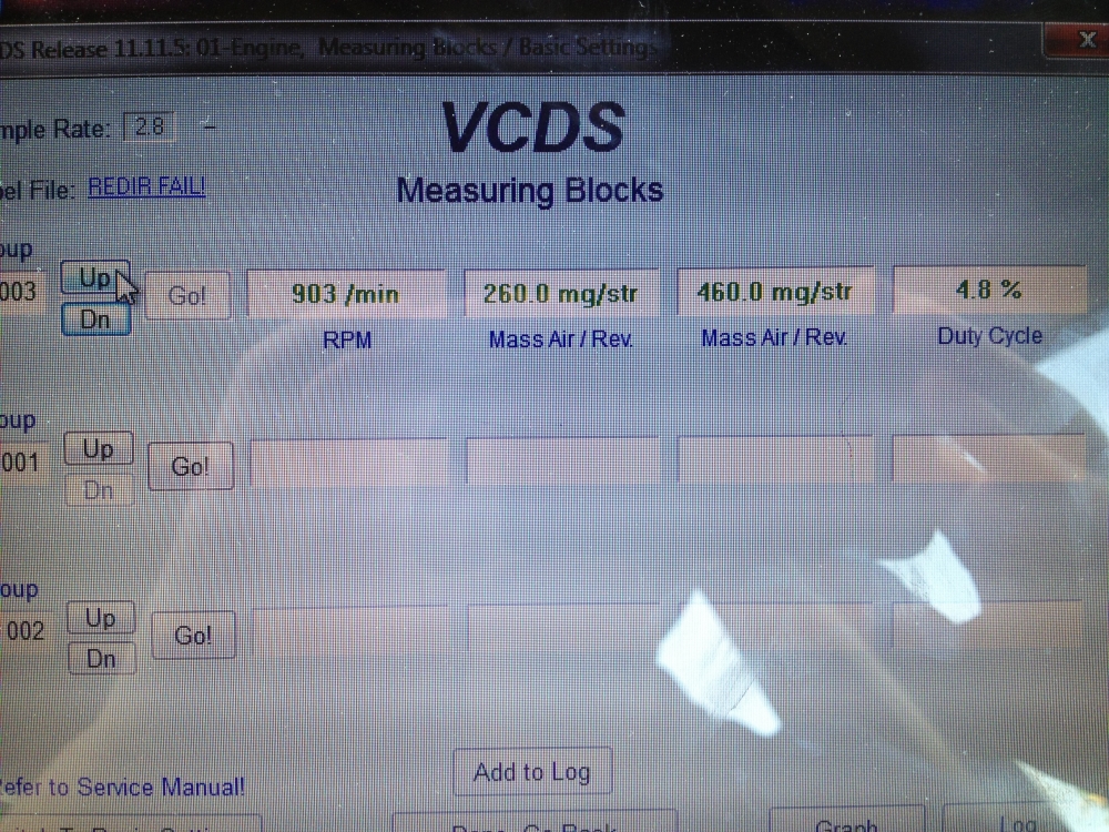

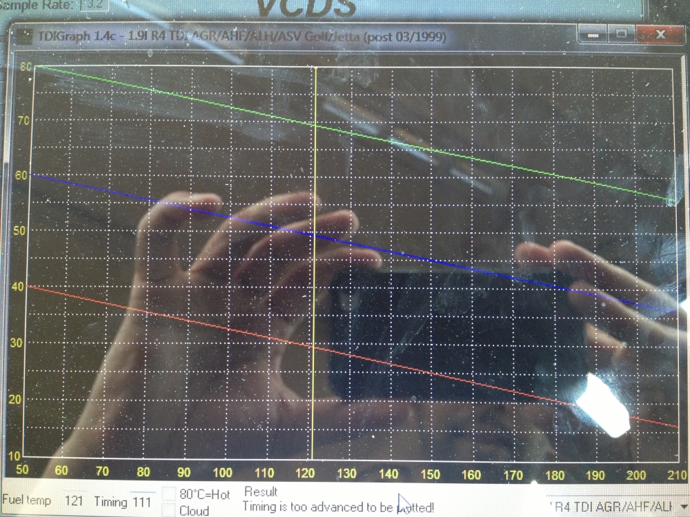

Ok as an update
I scanned my car using SnapOn Ethos but that only found one code see pic.
Then i met up with someone who had VCDS and found these results. Please advise guys as i dont know what it all means :(
sorry guys the forum doesnt allow me to upload any more. But do they make sense.
Measuring Block 015 Test
924/min 2.8Mg/str 0.40l/h 0.0 mg/str
RPM inj.quantity fuel consumption inj quantity
Test03
903 /min 260.0 mg/str 460.0 mg/str 4.8 %
RPM Mass Air/Rev Mass Air/Rev Duty Cycle
Test 01
903 /min 3.6 mg/str 1.660 V 85.5 *C
RPM inj.quantity Voltage Temperature
The timing is waaaaay out, far too advanced.

If the timing is "advanced" does that suggest its over fuelling? And my consumption is poor due to this?
Also will it reduce the engine noise if it comes into timing as it sounds alot louder then my brothers 1.9 TDI Seat Toledo and his is a 150bhp sport, whereas mine is a 1.9TDI 110.
Second quesiton would you guys suggest i change CTS sensor? Is it the green or black one that is good? Eurocar parts any good for this or are there parts cheap quality?
Your help will be much appreciated.
I think it means it is injecting the fuel into the cylinders too early in the cycle rather than too much fuel. This can make it noisy iirc. There is some adjustment on the injection pump sprocket which may be able to correct the timing or worst case is that the cam belt will need to come off and everything reset.
As for the CTS get a genuine one from the dealer/TPS, the revised ones are green and cost about £30.
As Trundlenut says, the fuel is being injected too early. This both makes the engine noisy, and reduces power, which most people compensate for with a heavier right foot, causing poor consumption.
Tbh the engine is noisey but most ppl tell me its common on skodas and the insulation is poor. Secondly the power is ripe ive never had issues with it feeling gutless on motorway stretches.
