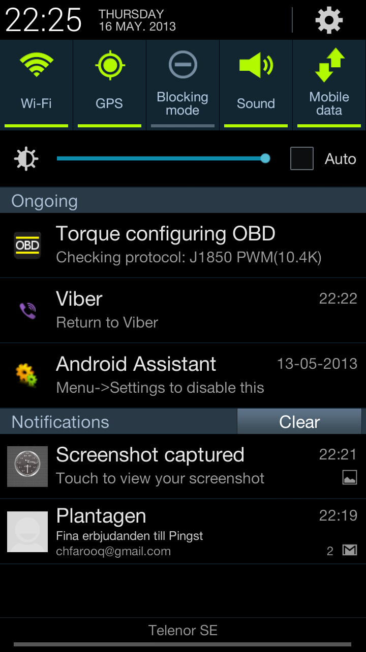

I bought a Bluetooth ELM327 adaptor from Blocket. It is not working on Skoda octavia 1 2000. I am trying to use it with Car gauge. Can anyone help me about it. I want to read a fault code in my car.

that how i am doing it. It is available in Torque. but then torque stucks with "Torque configuring protocol with different protocols". I continue getting this message for a long time.

It looks like its looking for the wrong protocol.
Check the setting and leave it on auto iirc
