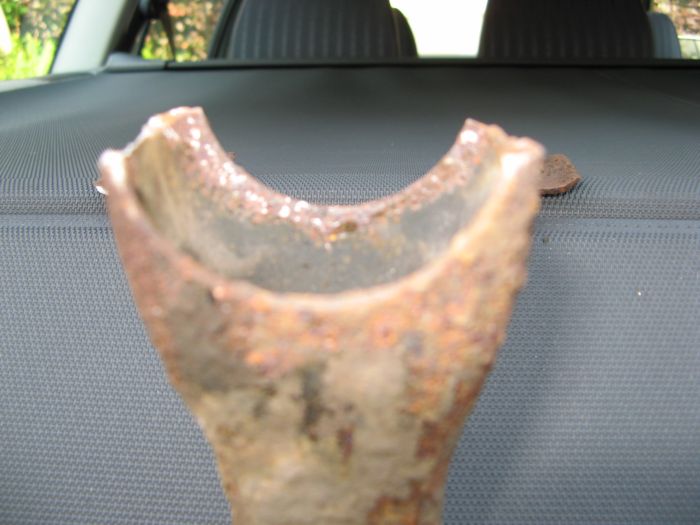

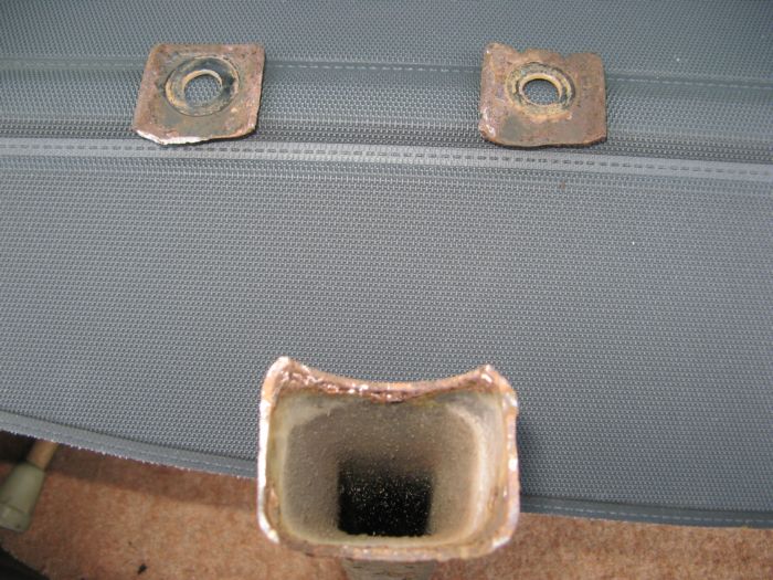

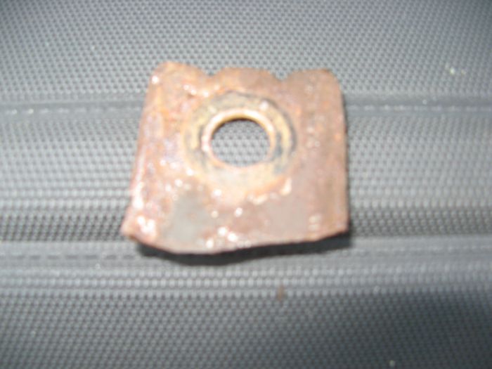

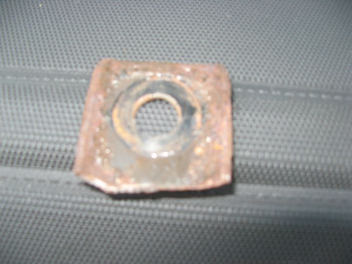

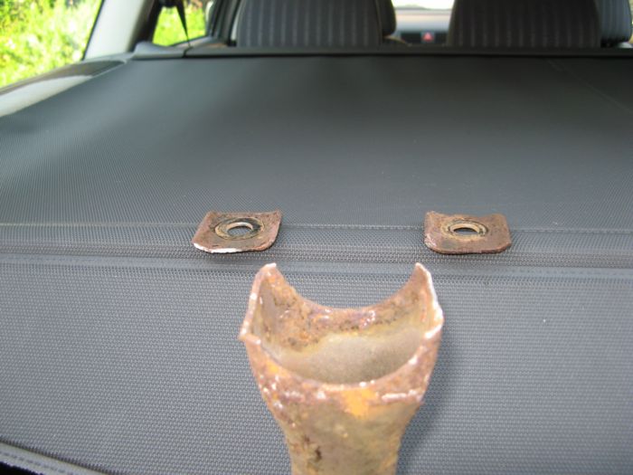

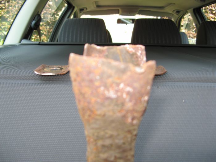

Pix. Sorry trying stuff. Think this is OK now.

i think "corroded to F£ck" sums those pictures up...
might get under my octy next week and have a little look around....
Blimey! has it been parked in the sea, Wasn't expecting pics like that I was expecting to see a mullered stub axle or something.
A lot of the damage is so old it's hard to see whether it's metal fatigue, or just a plain crack that's done it. No doubt massively aided by the corrosion.
My structural engineer's brain says it was weakened by the corrosion, which then caused slow progressing fatigue failure on the
Right hand side as seen in pic 1 - the failure line has recorroded i think which means it was hanging by a thread that side.
excessive load then shifted to a weakened left side which cudnt support the loading on its own and so
it failed - left hand failure line is quite clean, thats where it finally gave up.
