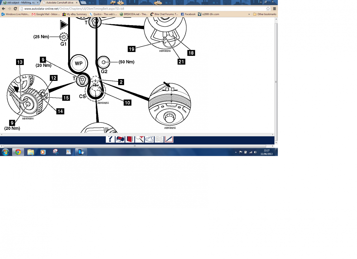

you set the crank timing at the right mark as there are 2 on the engine one says 4v next to it this is the one the ground tooth should line against.

the timing was done as the kit suggested... the two cams locked by using a bolt through to indents in the head casing like 2oclock and 10 oclock facing each other. the lower crankshaft was done with the shamfered tooth in line with the timing mark which is about 1oclock on the block. i didn't see any 4v but will go check. is it that likely TWO coil packs are bust?

so i'll try and post a photo of the timing... the shamfered tooth is on the righthand mark say 1 oclock and the line on the crankshaft pulley is dead centre 12 oclock in line with leftmost mark.

I removed the cam head and wasn't sure if once it was on the tensioner that it made the cam to cam belt one tooth out so reset the belt... could this be all it is? or should i go ahead and remove the HEAD again?
