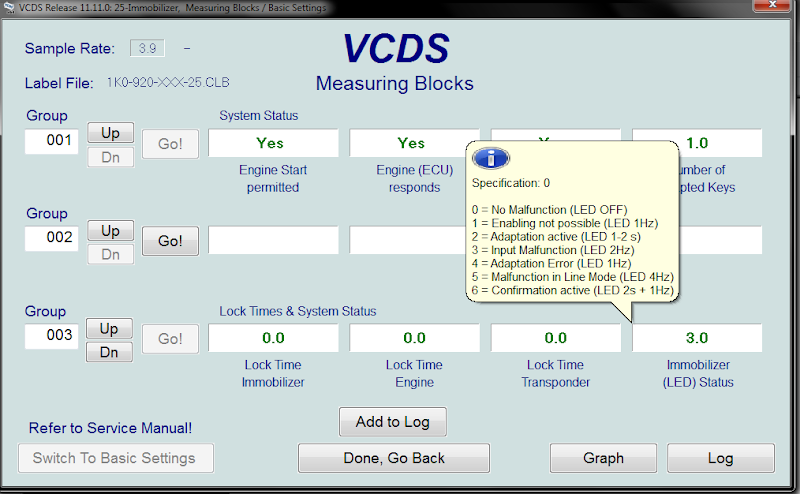

Hi,last weekend I replaced my Cluster (miniDot / Non-FIS) to an used maxiDot / FIS Cluster. Te process of cluster matching ended OK, but first attempt on matching keys failed.
First Time Instrument Cluster:
grp1 YES
grp3 0 0 0 0
Later times (now):
grp1 YES
grp3 0 0 0 3
I have no errors on Autoscan, car works, but the immo yellow led light is blinking
Please can you help me?

Solved !!!!
The problem was about key matching process:
- I had diferent messages on FIS when key was turned on (seatbelt warning and service remainder)
- During key matching, led didn't switch off indicating that it was all ok, due to this annoying messages on FIS (I hope)
Then:
1. Fastened seatbealt
2. Set Service Remainder to 0 on vcds
---> no messages on FIS (only immo not adapted)
3. Started key matching as described on rosstech
And finally solved !
If someone is interested, I discovered something about measuring blocks screen on Immo module (see previous picture). The screen showed a "3" only when key was turned on, but changes to 0-no error, when key was removed ---> great thing, because VCDS continues retrieving data without key turned on
