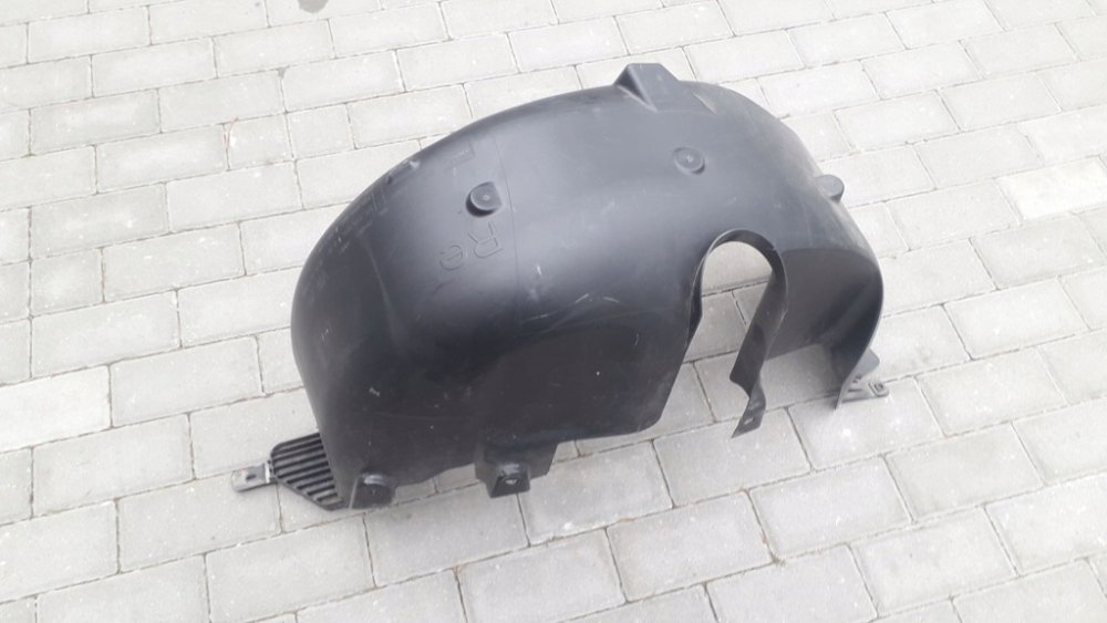

Does anyone know if E-Up! part number 1S0810971H will fit the Citigo ?
Looking at images online it looks like it's moulded slightly differently to 1S0810971C and as such wouldn't require the adapter 1S0810987 9B9.

Hi @Owens,
I just wanted to say a big "thank you" for this guide as I took the plunge and installed both rear liners on the weekend following your instructions.
A future point for anyone thinking of undertaking this job: if you order from Skoda Parts, don't chose the "Wheel Arch Rear Left/Right European Union" cheaper option. These liners are not designed to be fixed on in the same way that the official liners are.
I'm now crossing fingers that with the liners fitted, and a good dose of Tetroseal, I will avoid any future fuel filler cap rusting!
Mark

Evening all,
We've just acquired a 2017 Citigo Colour for my daughter and, following guidance on here I've ordered wheel arch liners and fittings from Autodoc.
They've just arrived and on unpacking them I've noticed that there are no holes in the arch liners for the fitting screws etc. that would allow me to find the hidden holes in the chassis...
Hence is anyone able / willing to do some quick measurements for me to give me a fighting chance of finding them? I can go off the pictures in various threads on here but measurements would also help tremendously!
