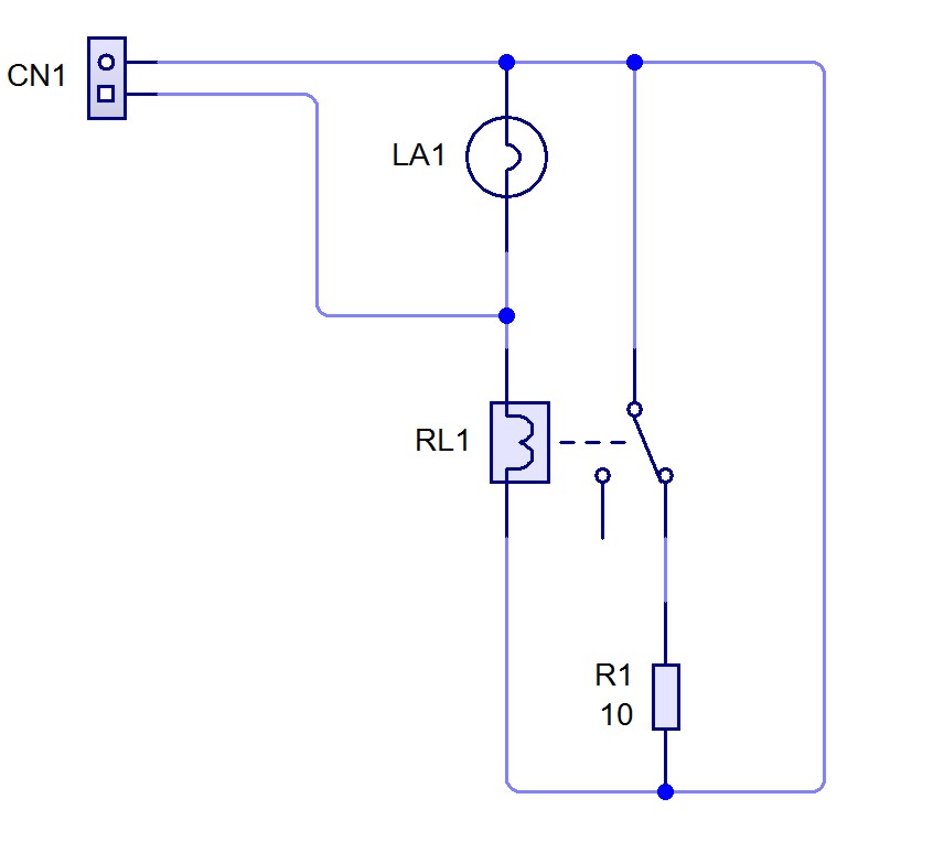

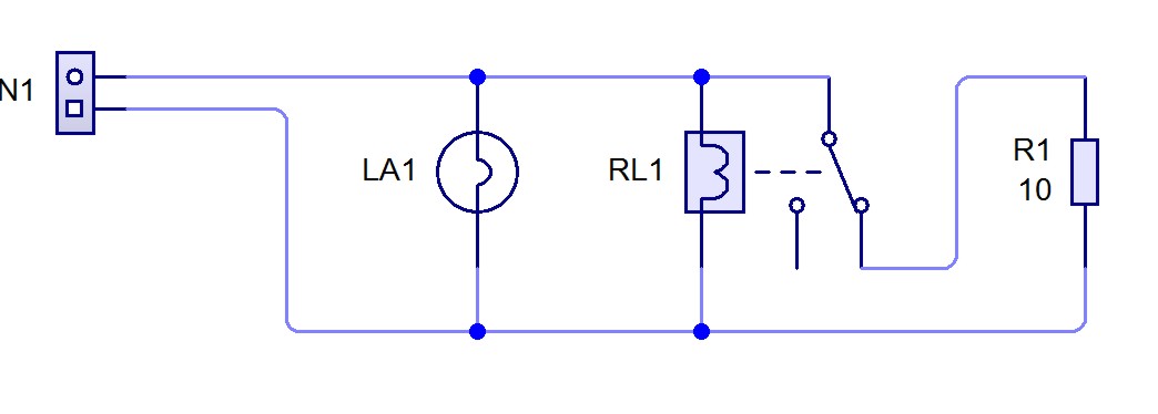

How about this for an idea to avoid CANBUS errors - put a small wattage load resistor for the CANBUS to sense, but take it out of circuit with a relay when power goes to the bulb
Whoops circuit error, this might work
So how little do I have to do to alter the lighting spec ? Would they get uppy about the LED boot light ? Anyway the original bulbs are going back in at the weekend. How about this for an idea to avoid CANBUS errors - put a small wattage load resistor for the CANBUS to sense, but take it out of circuit with a relay when power goes to the bulb

With a relay and a 10ohm resistor, the 'cold start diagnosis' sees the resistor as a bulb filament. When there is 12v across the bulb it lights up and the resistor disconnects, so the circuit only takes the relay current and the small LED current. If that doesn't work then the light control unit MUST be current sensing. I have yet to prove it by experiment. My relay coil meters at 502ohm btw. The 'ballast resistor' in this case only takes current when the light is switched on and is then immediately disconnected by the relay, so it would have little heat to dissipate and therefore need only be low wattage.
The normal P13W bulb has a cold resistance of about 2.7 to 3 ohms, when it is hot 21w at 13.6v is a current of just over 1.5A, which works out at 8ohms, so a 10ohm ballast resistor would not load the control unit any more than a P13W filament bulb.
As the cold resistance of a bulb is lower than the hot then there is an initial current surge in the millisecond (ish) when the bulb heats up. a resistor presents a more constant current profile.
All these assertions are based on Ohm's Law V = I*R and W = I*V which for DC circuits has proved a good friend to me for years.
