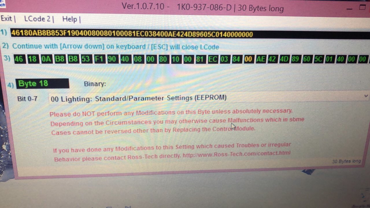

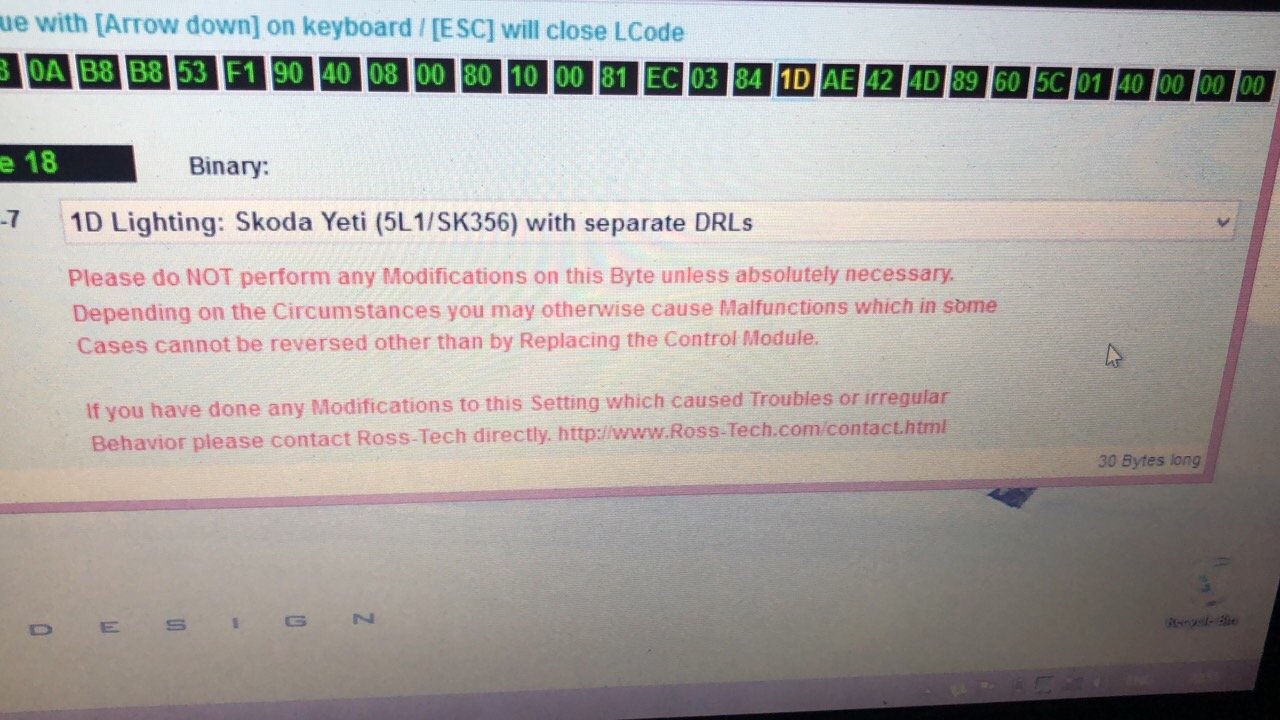

I found this in VCDS (look the pictures). In vcds is now set on 00 Lighting: Standart/Parameter Settings (EEPROM) (PICTURE 2). When I check other settings I discovored setting for YETI (picture 1). Which setting I need to choose?
As your original byte 18 is 00, do NOT use VCDS to change it.
It generally means that none of the byte 18 values are correct for your car so if you change it, you may never get the stock lighting configuration back.
If you want to make lighting configuration changes, find someone with VCP or ODIS-e. Both can be used to backup the original lighting configuration and make any changes you need including LED DRL (assuming the BCM supports LED lighting).
