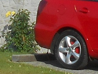

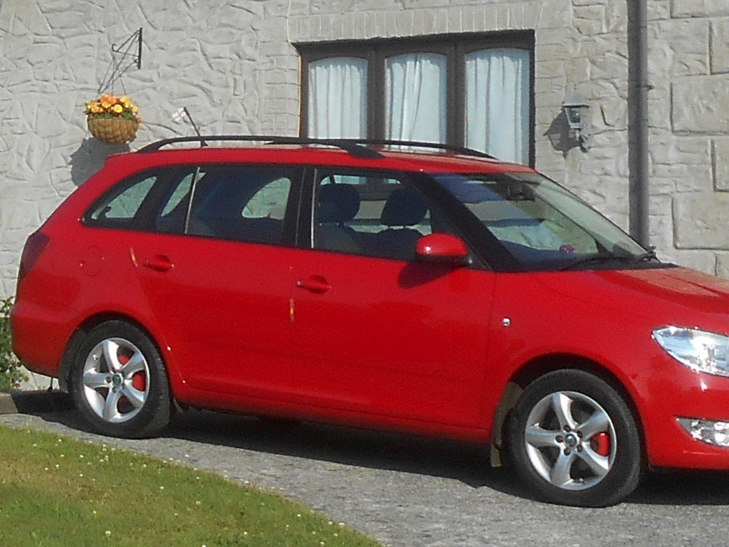

I drove straight home from dealers and painted my drums with hammerite smoot red. 11 months later they still like new. I am surprised how bad some cars look after just ba few months
A photo please :) .
Just tried to upload photo but it comes up file to big. When wife comes home in car will take another and try to post that one
You can use Photobucket and then post a link to the photo. That's what most people do.
Ive done it Kent. Here are a couple of photos of my red drums, don't know what colour I would do them on your car, not sure red would look right on a green carpost-5979-0-38178000-1374675855_thumb.jpgpost-5979-0-35834100-1374675874_thumb.jpg
They look great :) . A nice little detail. I think a darker green would be better for my car.
