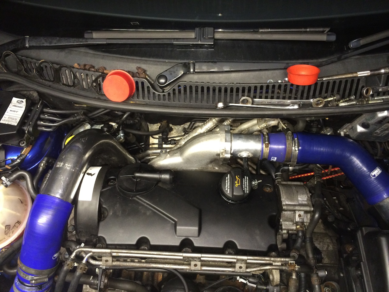

here is the comparison between the stock turbo and GTB1756vk welded onto manifold:
and the bulkhead clearance:

here is the downpipe i made for mine and my engine bay which is slightly different to most as the turbo inlet comes in from the drivers side
