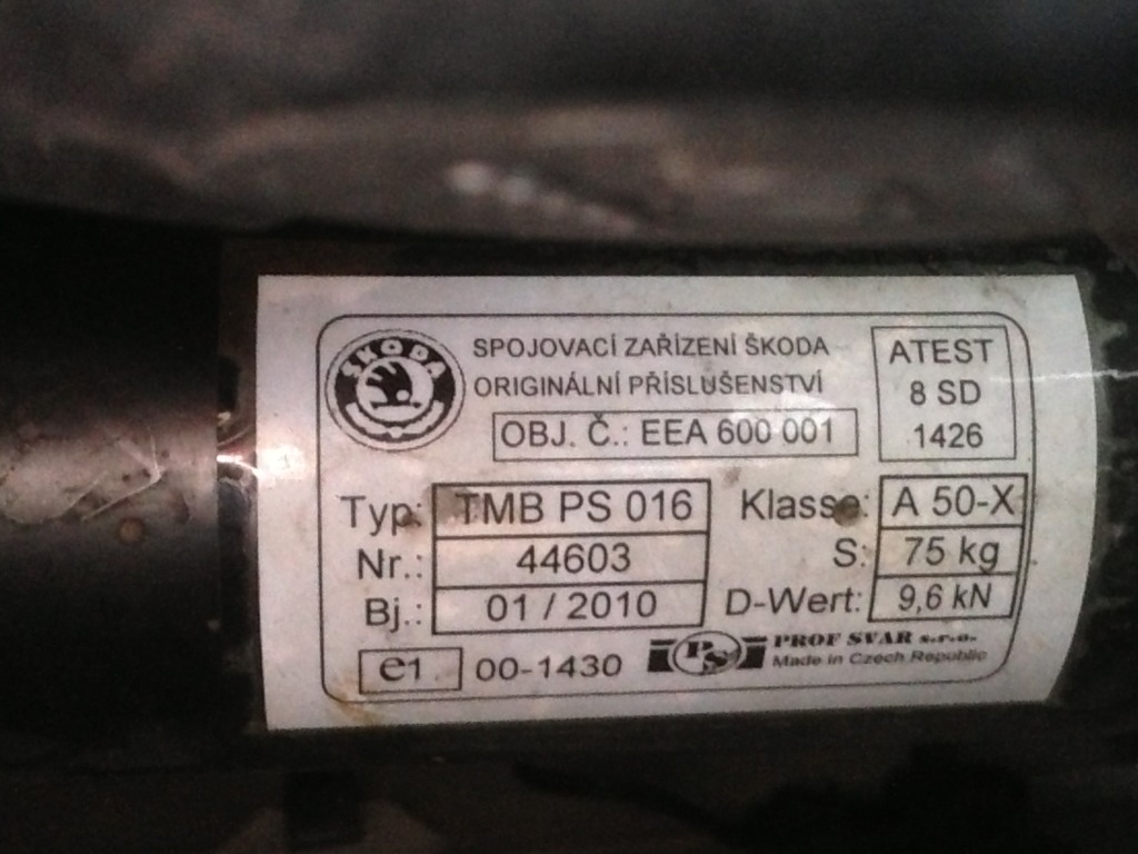

post-106227-13764743157718_thumb.jpg. I've had a route round and found this on what looks like the tow bar any ideas what it translate to or identifies.
I think EEA 600 001 is the Skoda part number of the full towbar kit.
Might be time to visit your dealer and ask them if the towball can be bought separately.
Thanks.
