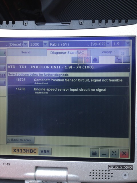

Ok so the RAC came out and got it started with a can of brake cleaner... He did a before and after on the vag com thing they have and came up with this post-104089-13759942957322_thumb.jpg
So I drove it to my Master techi and he's had it to bits tonight. He thinks it wouldn't run at all if the crank sensor wasn't operating and the cam sensor just syncs the injectors to fire in the correct order to start the engine efficiently and quick.
So..... Fuel pump primes ok which leaves tandem pump...
Ill update when more happens .
Crank and cam timing out so ecu is confused and injecting at wrong point
Uses crank sensor as datum then cam sensor for when to inject fuel.
Need to get it running and look at sync angle in vcds

Suspecting engine crank sensor g28 faulty.
Ill keep updating as it might save someone a heap of cash and garage bills . (Not me tho) lol.
G28 didn't cure it... Checked the signal on the osilloscope and the signals weak. Checking the wiring now and it looks like a short in the shielding wiring back to the ecu, I need to get a wiring diagram to double check. I think you can buy the piece of loom separate ill find out tomorrow..

Osilascope ? test found a weak signal going to the ECU, wiring loom joining block near the battery on the inner wing was corroded and shot.
Cut in out, joined the loom ( properly ) and booooom !!!!
It lives again. ;-)
