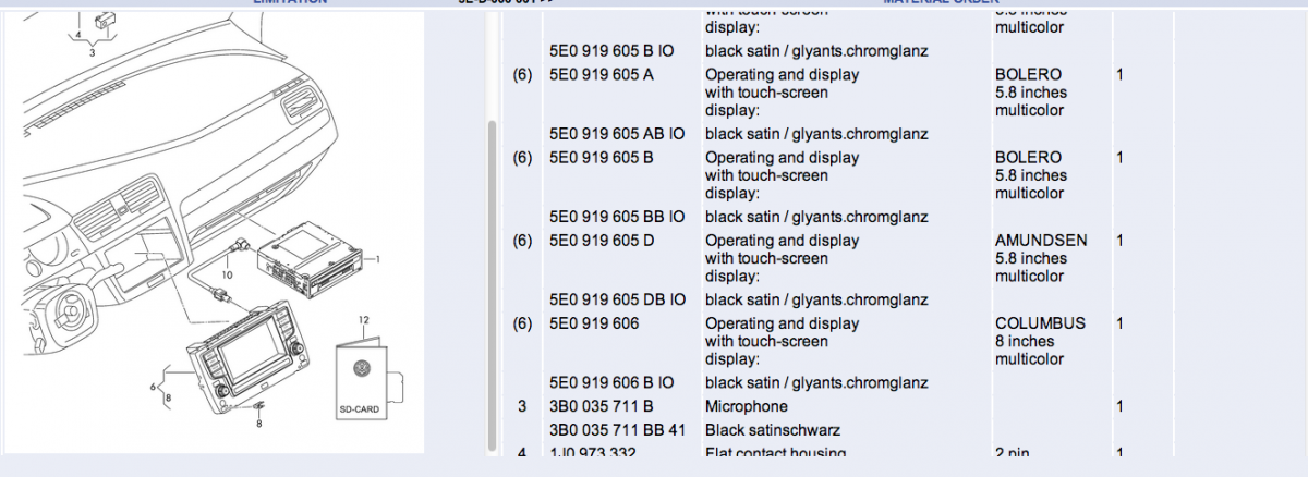

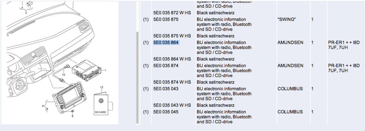

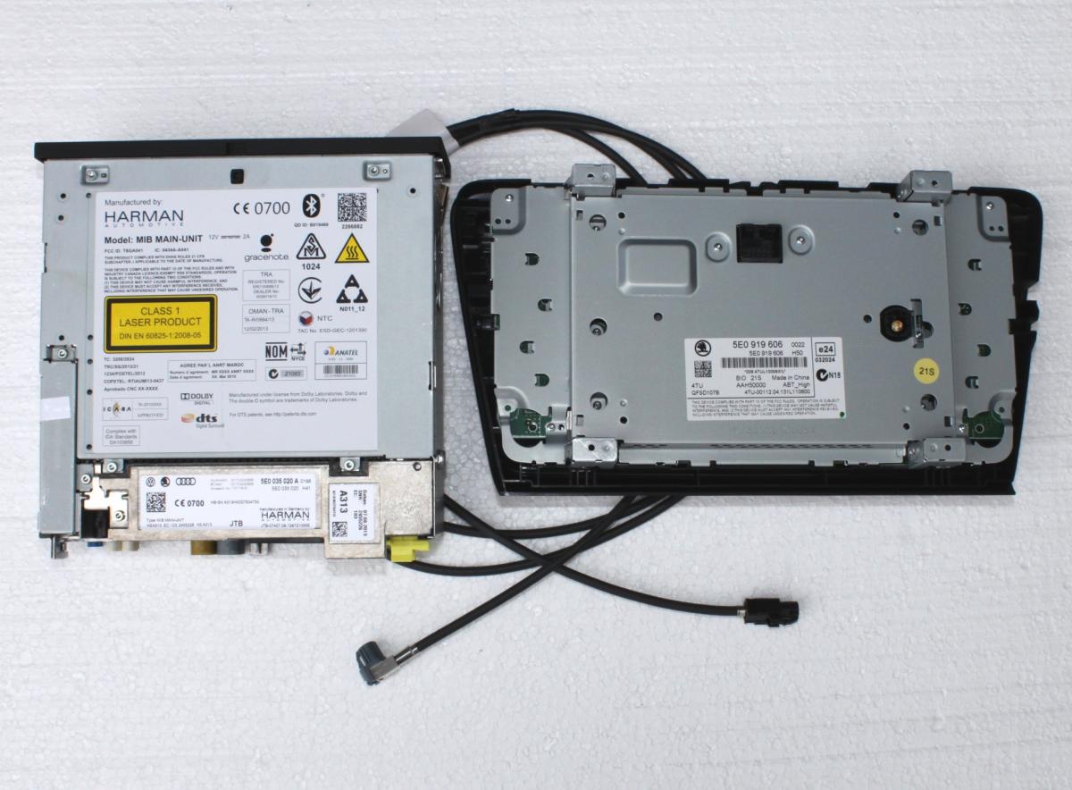

More digging - they appear to be made by Harman (Becker)  Retrofit shouldn't be too hard looking at ETKA to replace both bits (glovebox part and display).
Price from Skodateile - €900 - so cheaper than factory fit as an option!

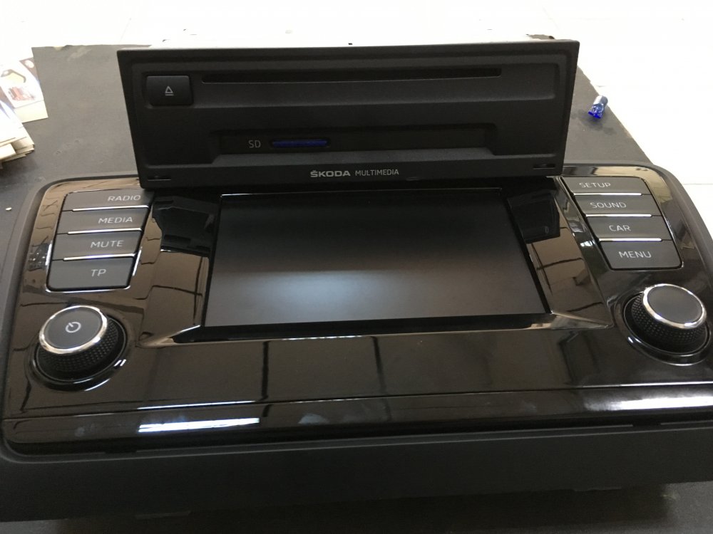

As its a two part system, i.e CD player etc in glovebox and then a headunit in teh console, could you not just change the head unit and connect the existing CD player etc into the unit??
unfortunately no as the nav units need the CD unit which has two SD card slots, one for maps and the other for music.

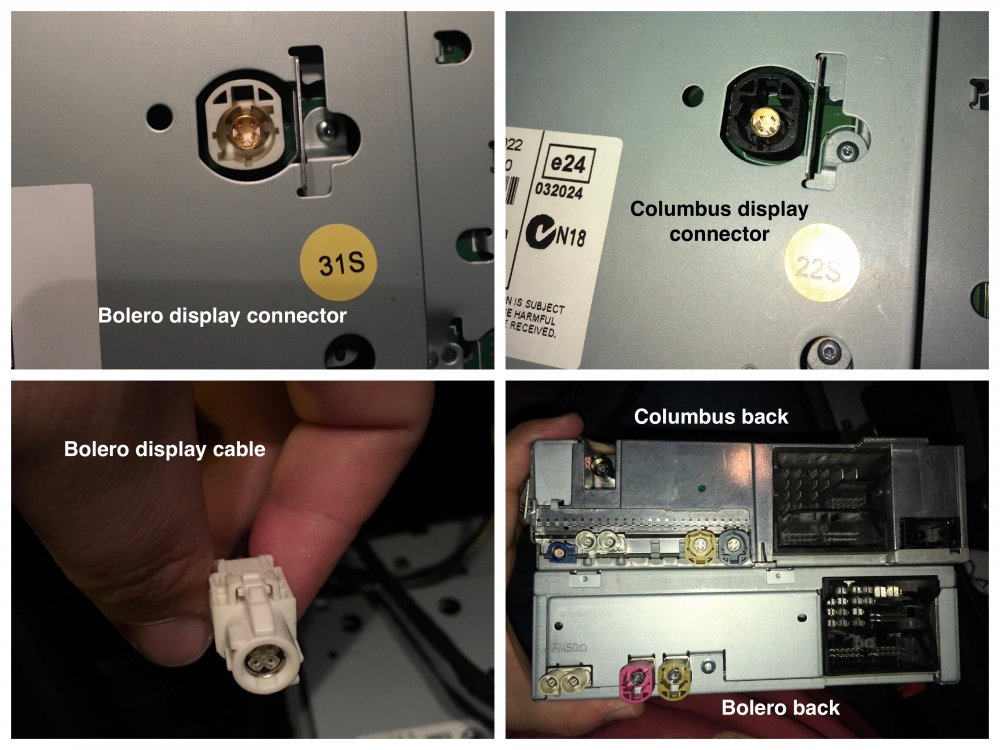

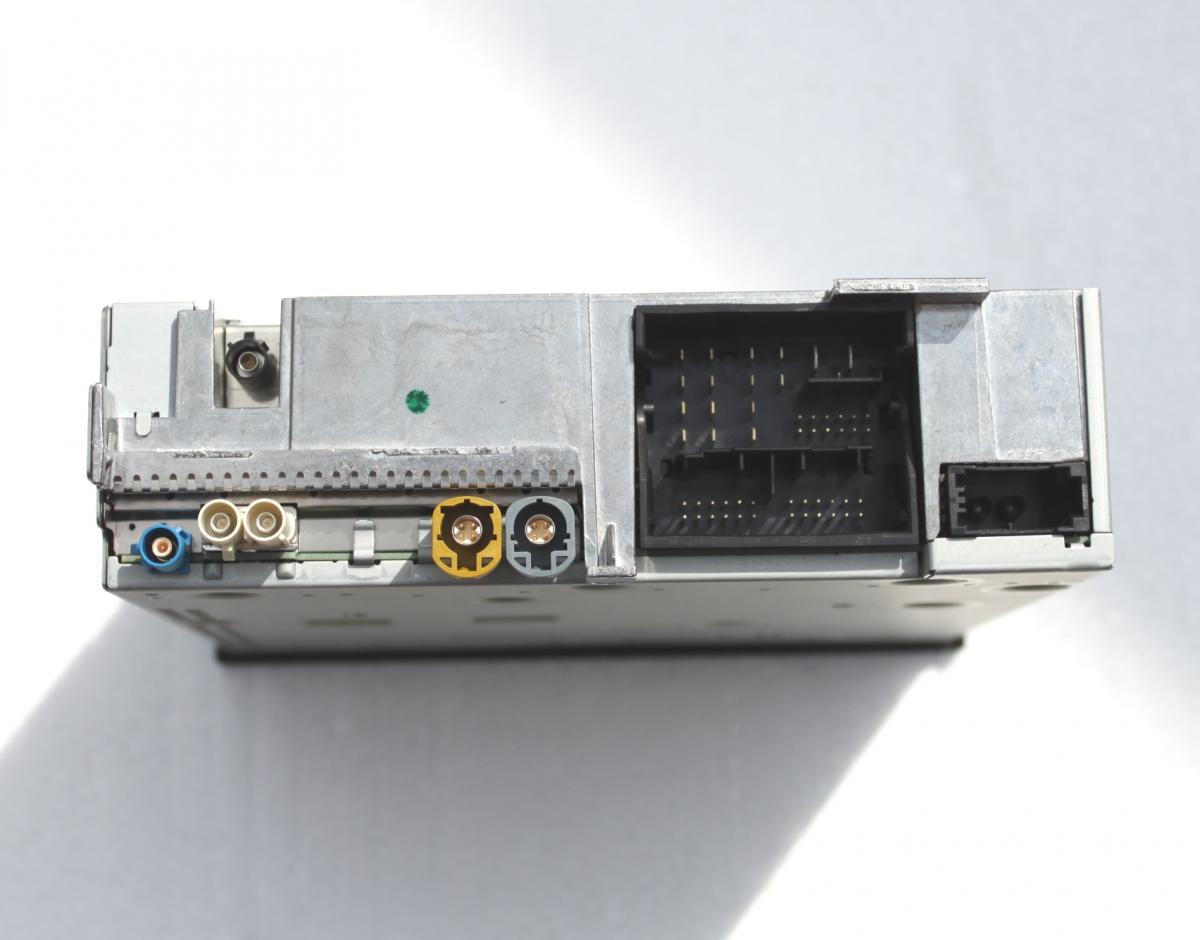

My only concern is how it connects to the car -is it a quad-lock or have things moved over to fibre optic?
still quad lock by the looks of things:
So assuming that the blue and gold plugs are for connection to the touch screen -the FAKRA are FM, DAB and GPS then it's all CANbus so you're in with a good chance of getting it working -But what is that to the right of the Quadlock?
I wondered that too! Optical maybe? It could be a MOST type connector for the Canton sub, but I'm stabbing in the dark here.
