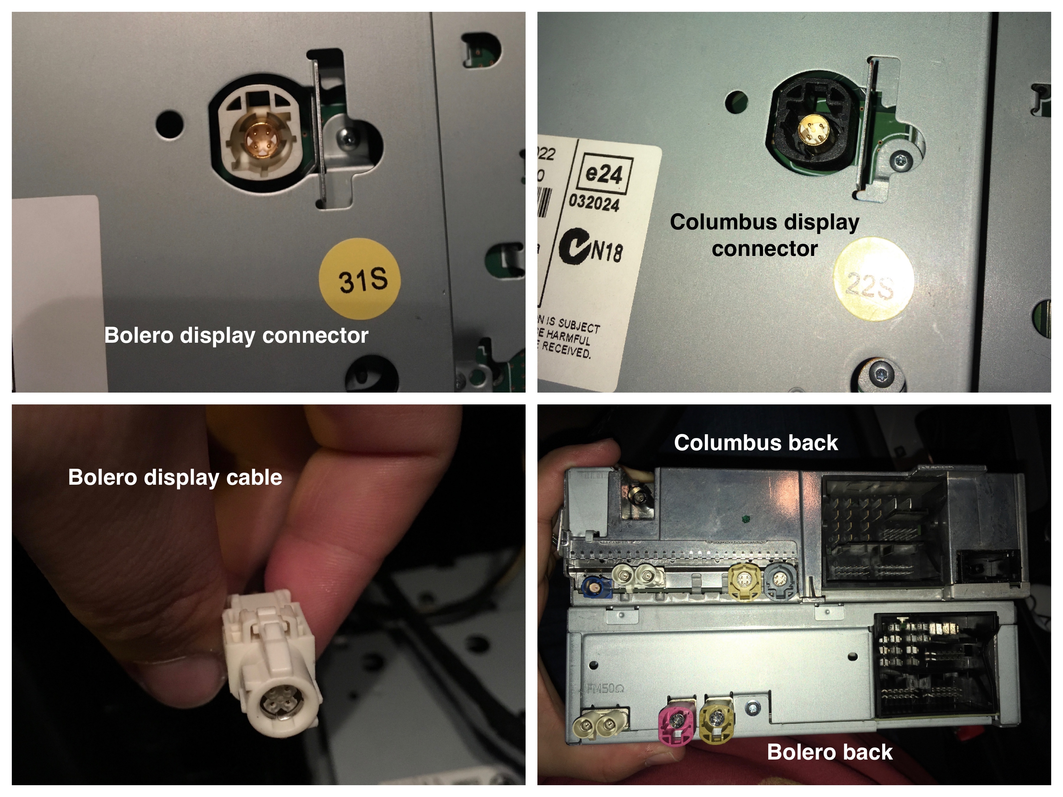

I just got the new Columbus MIB1, but I have some issues retrofitting it instead of the Bolero MIB1. If anyone could help me out, I'd much appreciate it!
The thing is that the new display has, just as the old one, two connectors, but one of them, the white one is not compatible, as the cable already existing on the car can't connect to the new display as the guiding signs are not aligned properly. How should I treat this?
Another thing is that the old Bolero has on the back of the unit in the glovebox a different set of connectors than the new Columbus unit. The bolero has the multipin connector, one yellow, one pink, and one white, but the Columbus has the multipin, one yellow, one blue and one white. All old cables can be connected to the new Columbus glovebox unit, but the pink cable can't be connected to the blue socket, and I don't know if it should be connected here. Also, the Columbus has several inputs that I don't know what to connect them to. Can anyone help me out with some info? I've also attached a picture of both back displays and the cable that should connect to the new display and also the back of both glovebox units.
Blue connector on the rear of the Columbus is the GPS antenna so the sat nav knows where you are. You'll need to provide a GPS antenna.
Thanks for your answer! Alright, that's a start. I do have the GPS antenna in the package and now, thanks to you, I know where to plug it in. One down and a lot more to go. Anyone else regarding the other issues I raised?
I managed to figure it out: all I had to do is trim the plastic guidances on the connectors that were not a perfect fit. That's it.

The above explanations and pictures are pretty much self explanatory. All that's required to do when retrofitting a Columbus instead of Bolero on an Octavia 3 is trim the little plastic guidance things with a nailclipper, for example, and the pink cable (mine was pink), connect it to the blue entry on the Columbus clovebox unit. For all other cables follow the color code (white to white, black to black and yellow to yellow), also the GPS antenna is on the far left on the backside of the glovebox unit. I'm guessing that the one entry on the far right side is for the microphone.
