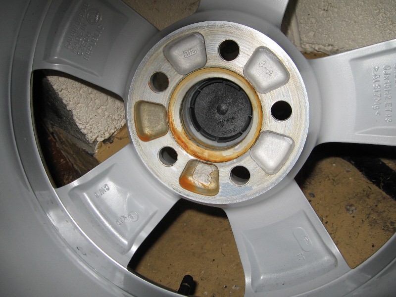

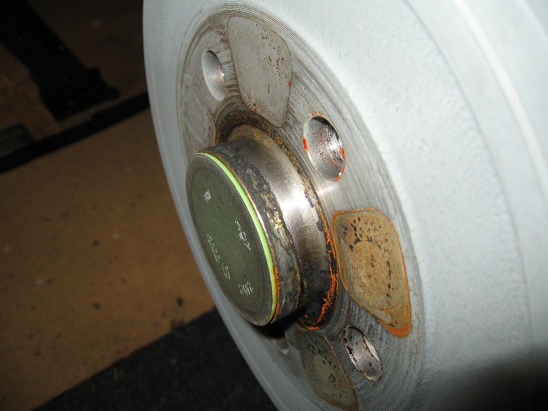

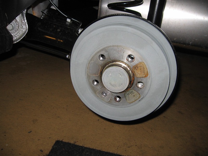

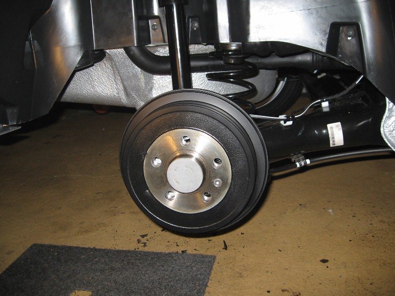

Usual story with drums - corrosion started - this picture is the better of the two sides!
Cleaned, painted with industrial black paint in 30 minutes, and lightly greased mating surface

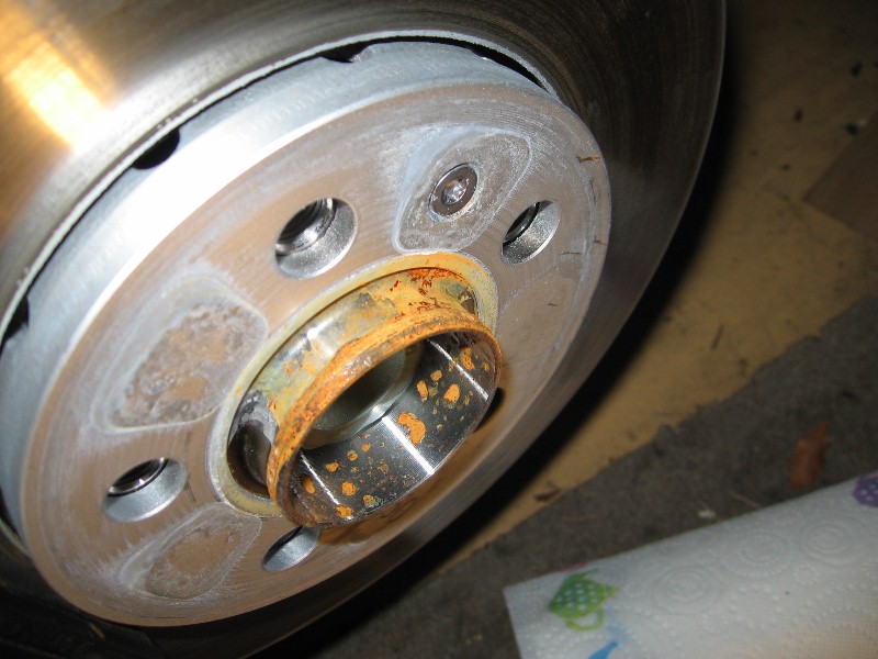

Similar story with front disks

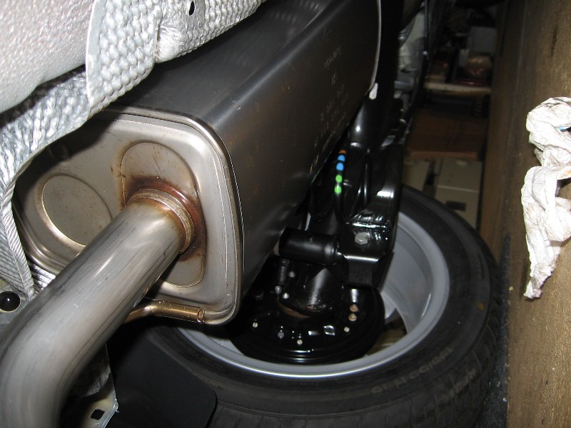

The exhaust on the Tsi looks better quality metal (looks like a stainless box?) and is tucked up nicely out of the way on the estate. Cleaned and oiled it up with MoS2 penetrating oil as far as and including the middle box (wiped of any excess though) - it cleaned any surface rust off nicely and hopefully it will "blue" the metal when it heats up.

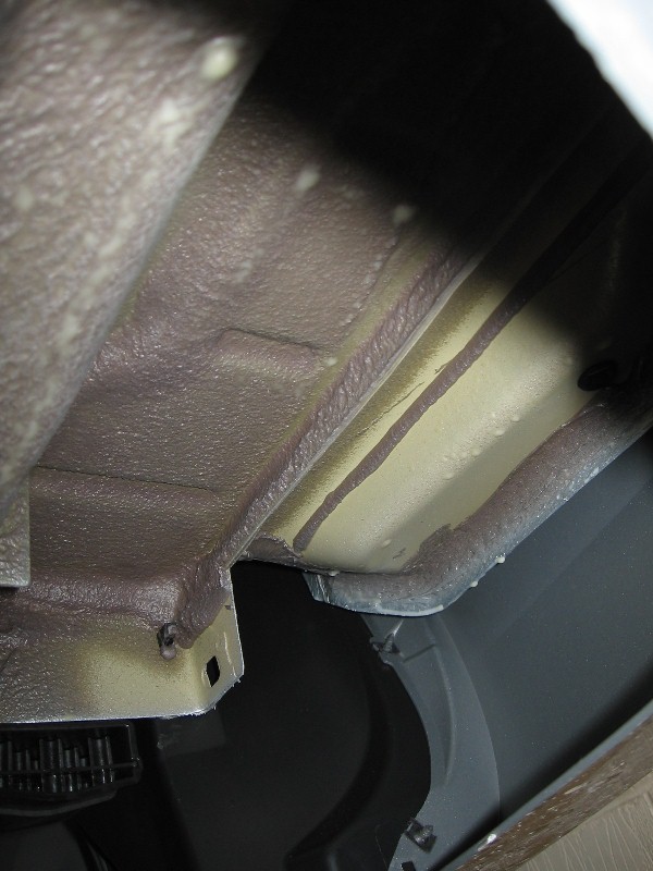

I'm disappointed that my car didnt come with full body under trays, just stonechip paint. - It seems they ran out of stonechip near the back, so I've waxed those areas for the time being. Later will probably get some siver Schutz and do it properly.
Is there a grommet missing here? And why do we need so many holes at the back?
