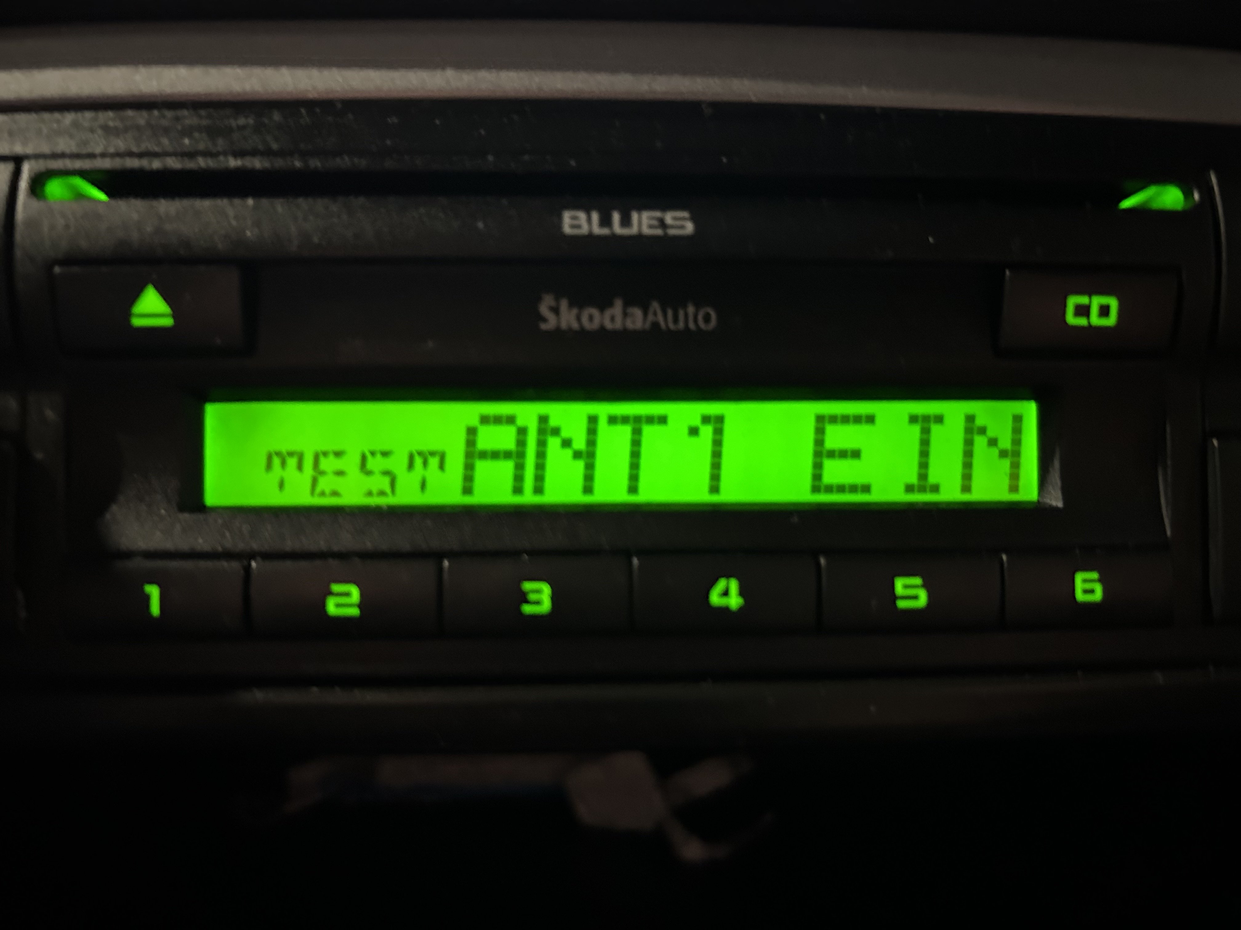

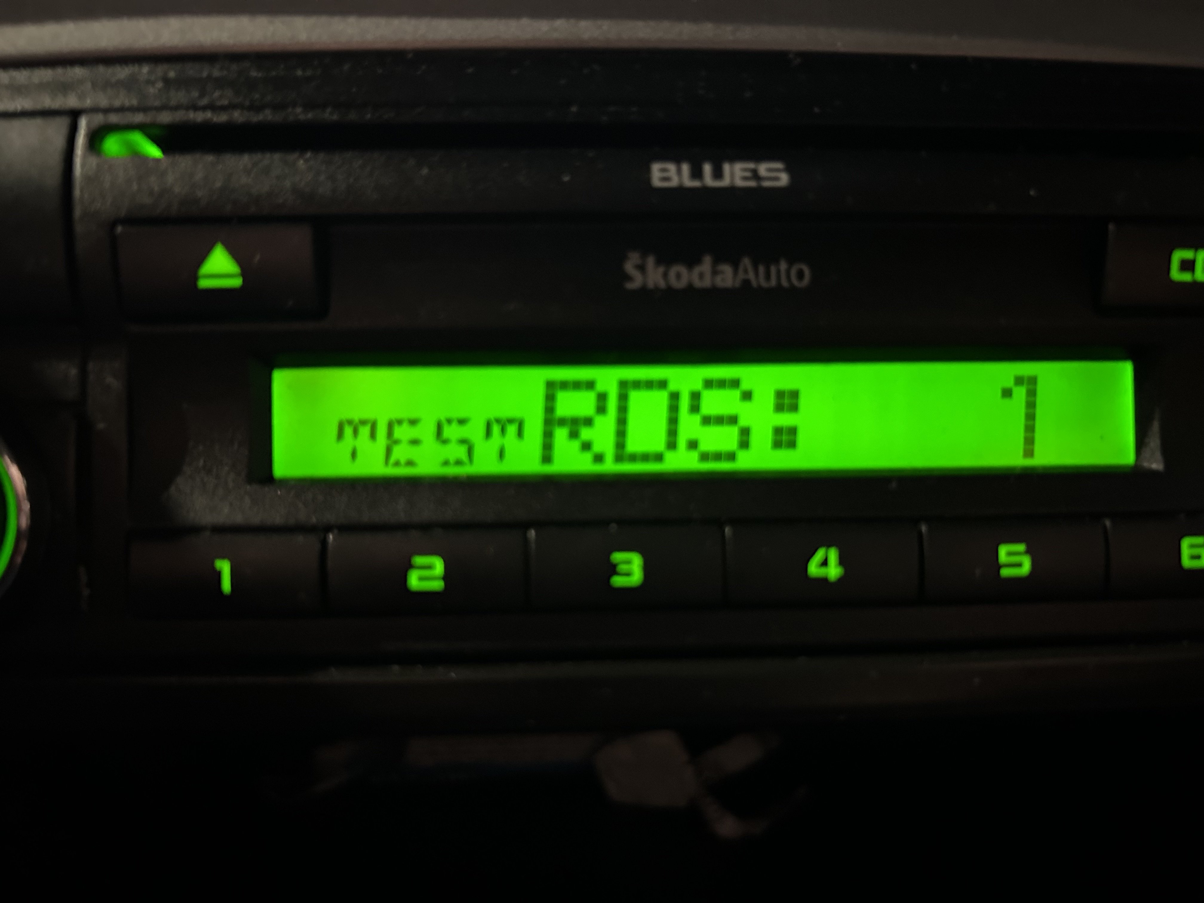

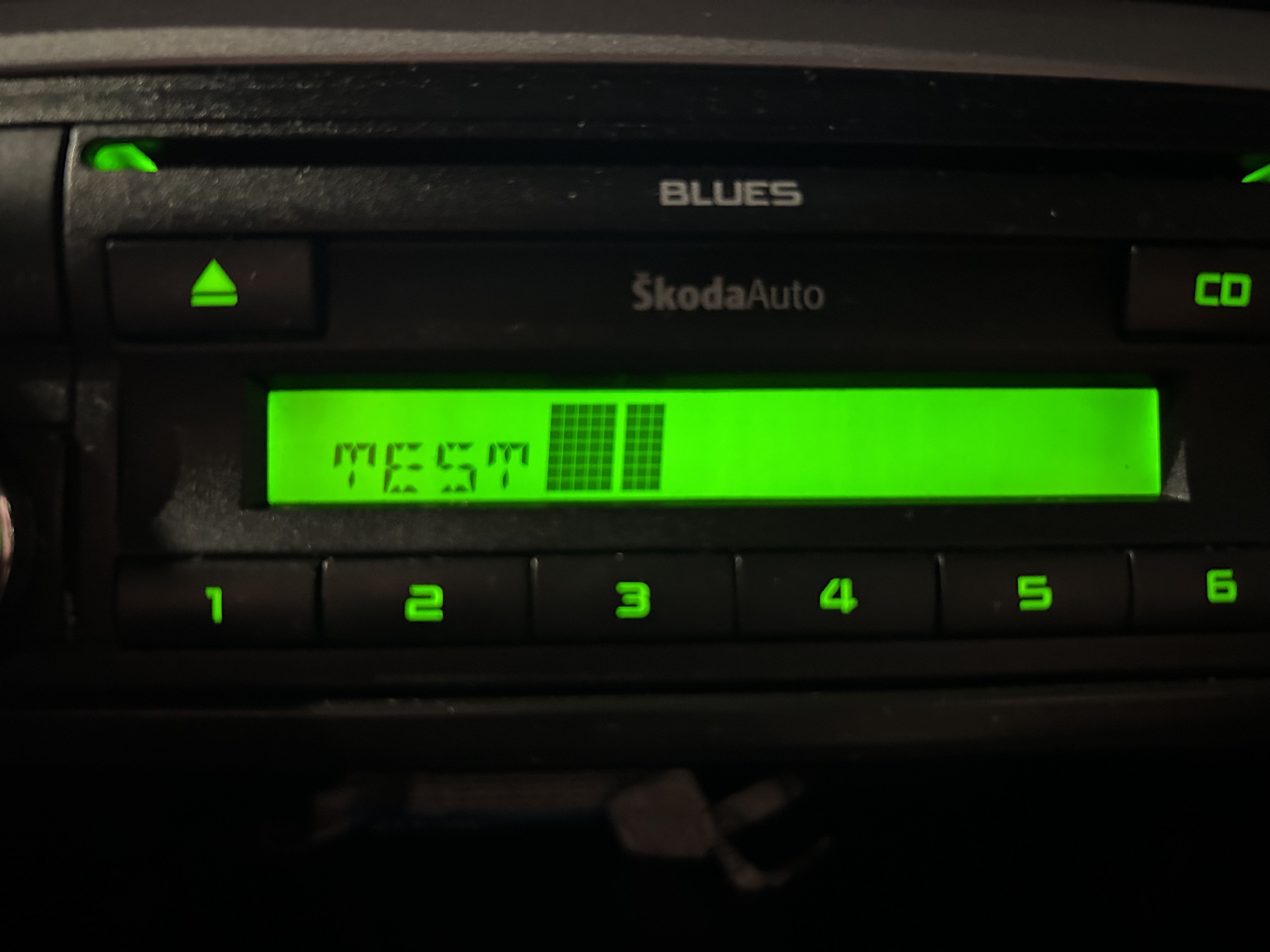

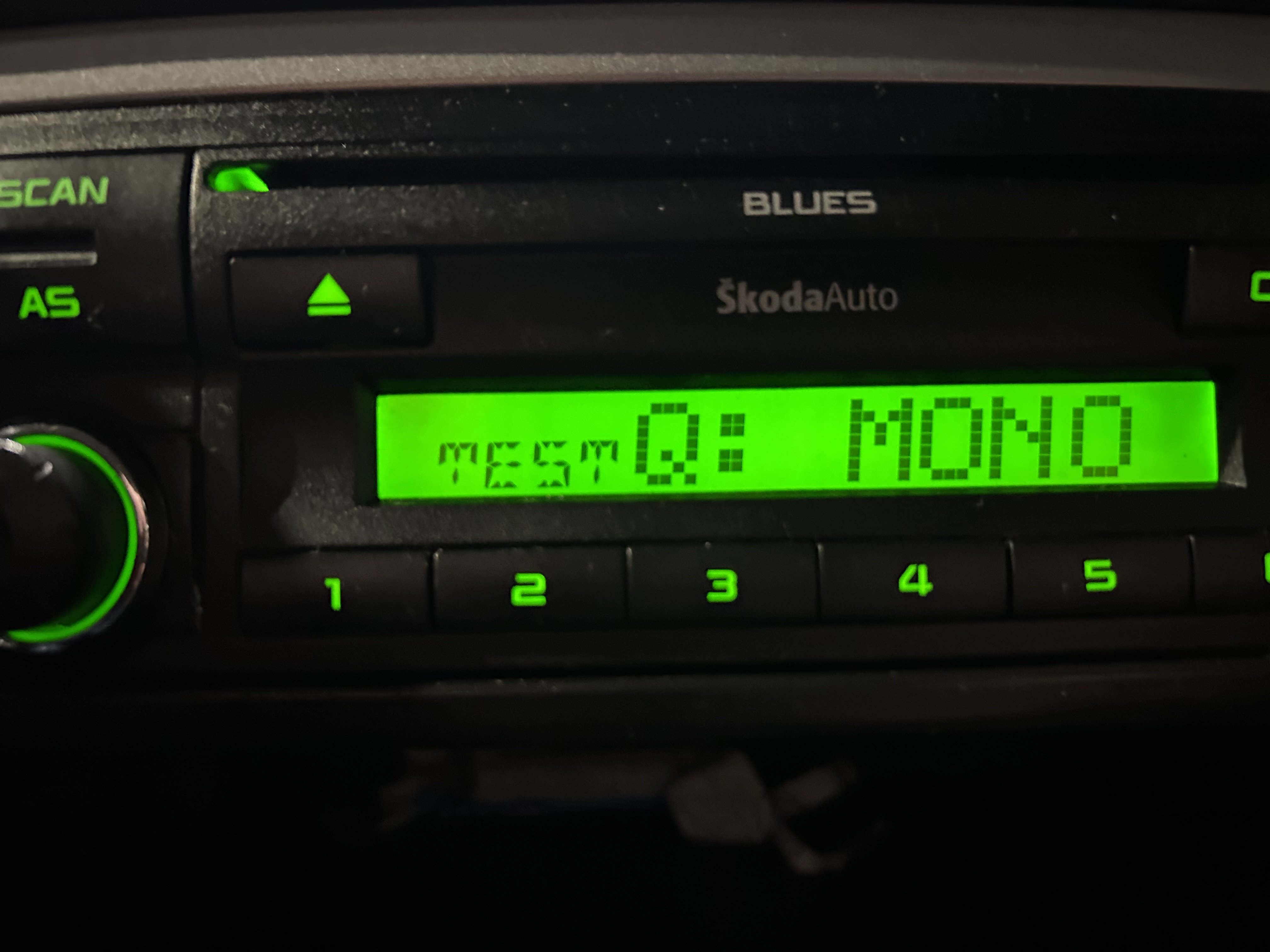

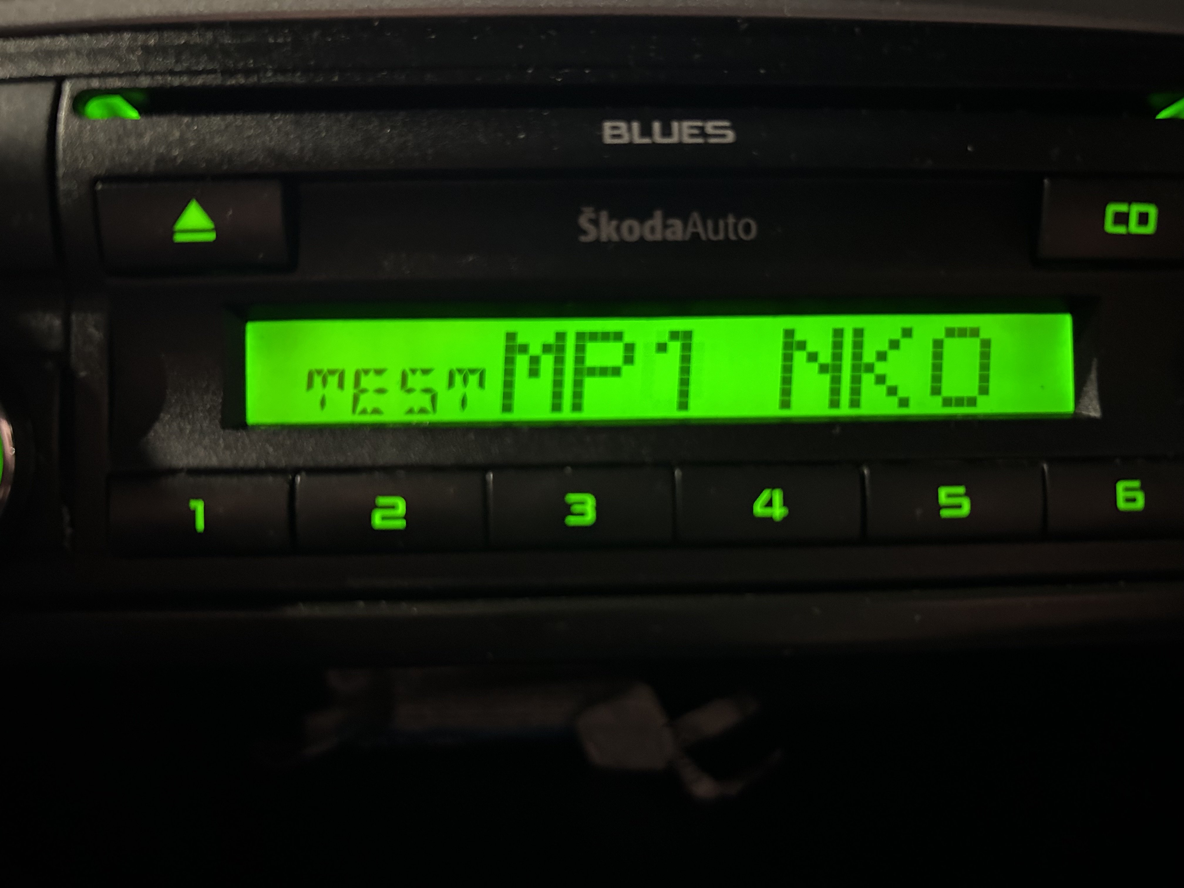

I got the same issue. Few radio station but in city centre, when outside no stations at all
I done testing, please see results in pictures
please advise test results. Not sure what this means (if amp connected or something else. I tried different antenna but the dame results)
