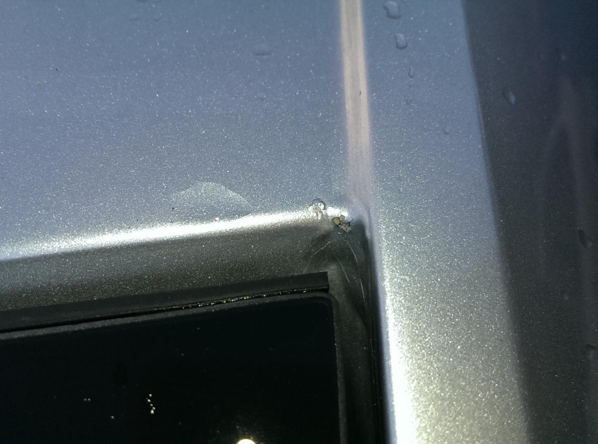

Paint chipping at the roofwelding
Not exactly what I was expecting from a brand new car!

My car is also silver and by the looks of it's the sealer over the joint on yours is similar to mine, ie too much!
Contact the dealer, tell then your aren't happy and want it inspected by skoda. I refused to even let them think about repairing it as it's a brand spanking new car and also respraying that part would probably mean the whole roof and the screen would possibly have to come out too.
My dealer sent pictures to skoda (I had to call skoda and start a complaint file for the pictures to be "attached" to) and skoda sent a chap up to inspect it the other week too.
When I reported mine the paint hadn't chipped but that only took 2 days to happen, and like yours it has cracked so I expect more paint to come off in time.
So, when the new car does eventually turn up the current one might be looking like a Delorean!
That's very poor manufacturing. I would take to your dealer as soon as possible. It's not exactly the easiest of places for repair. So it will depend how long you have had the car for the route you take. If you have only just picked it up then a route of rejection is probable as painting a brand new car is not in my opinion acceptable. If you have owned the car a little while it becomes slightly more difficult justify rejection but is far from impossible. I would inspect the whole car, list any defects and go to dealer. If your happy to have the car repaired, all is fine. If you are not, then you need to decide if you wish to keep the car. Of course all this is my opinion on your dilemma. I wish you the best of luck.
Just too the left there looks like a big patch that's sinking of something?

Where exactly is this detail? Can you please take a picture from further away so it's more clear where this is? (or Mike999vRS since you got the same fault) Only want to know so I can check with my car when it arrives someday...
Looking at the front of the car its the top right corner of the windscreen.

The seam at the top of the rear hatch isn't as bad and isn't chipping yet.
Basically it's the edge of the weld/seam at each corner of the front screen which is why I think it will be a total 'mare to fix properly.
Oh I see now. Damn that really is tricky place but I think it could be repaired/repainted properly without too much trouble hopefully. So far it only seems to effect silver paint or did the same fault showed on some other color as well?
The fault is with the sealer used along the edge of the roof panel, it's just silver makes it a lot more visible, similar faults on darker colours might go unseen.
Got it. Basically that's why the paint can be so easily peeled off - it's not painted over metal but over sealer...  :S
Pretty much. It's probably why a lot of manufacturers "cheat" and cover the join with plastic trim.
