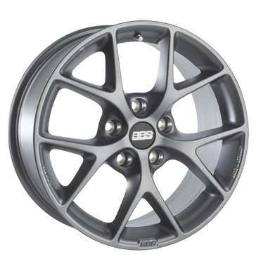

BBS SR on the way, hope they will fitt!
Didn't you check before ordering?
I did, ;)
To fussy and hard to clean lol but will look great
Won't they be expensive as well ?
How? They look dead easy to clean, they're hardly a cross spoke wheel like an old skool BBS RZ.
Almost certainly worth every penny. Looks like a new design for BBS.

I did, ;)
Did they fit when they arrived? What ET were they?
They have arrived, but my car havent...

They are ET48 and should be bolt on.
No i dont think they are expensive 120 euro each isnt bad at al.
