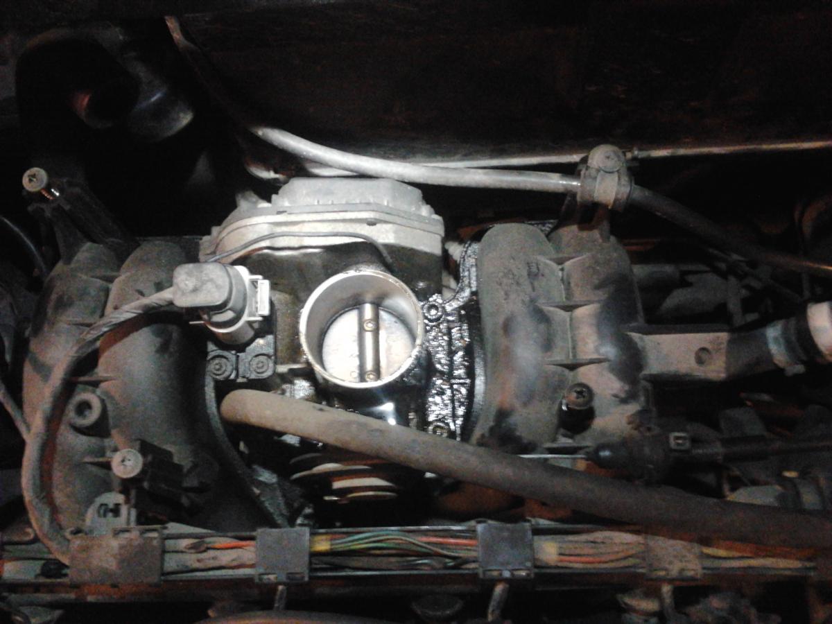

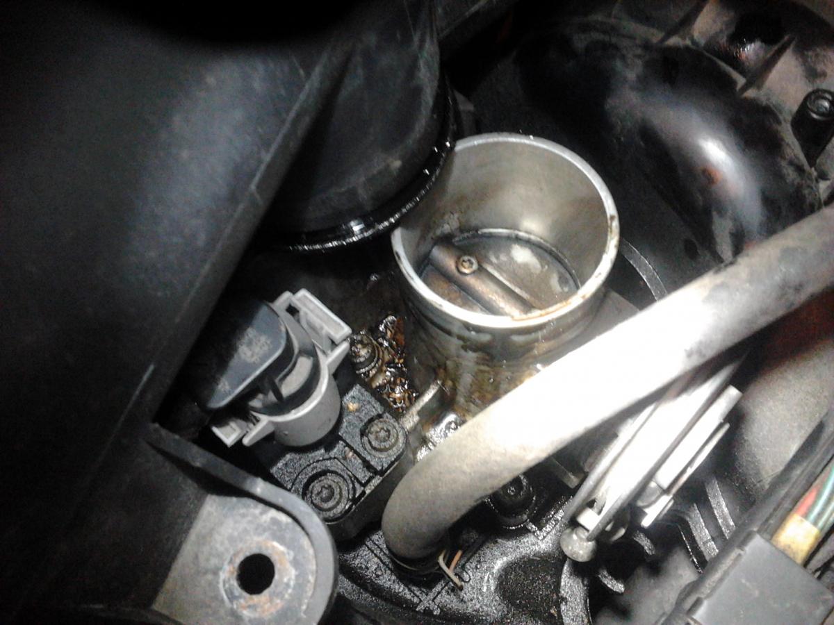

I have checked the condition of the thottle body and it has some oily residue in the valve area and quite a bit of oil sitting on the outside of it. The hose from the crankcase is soft and has sludge in it but its not blocked.
Do i need to do a cleaning of the trottle body and a realignment or can it be another cause for this issue? Petrol filter issue maybe?

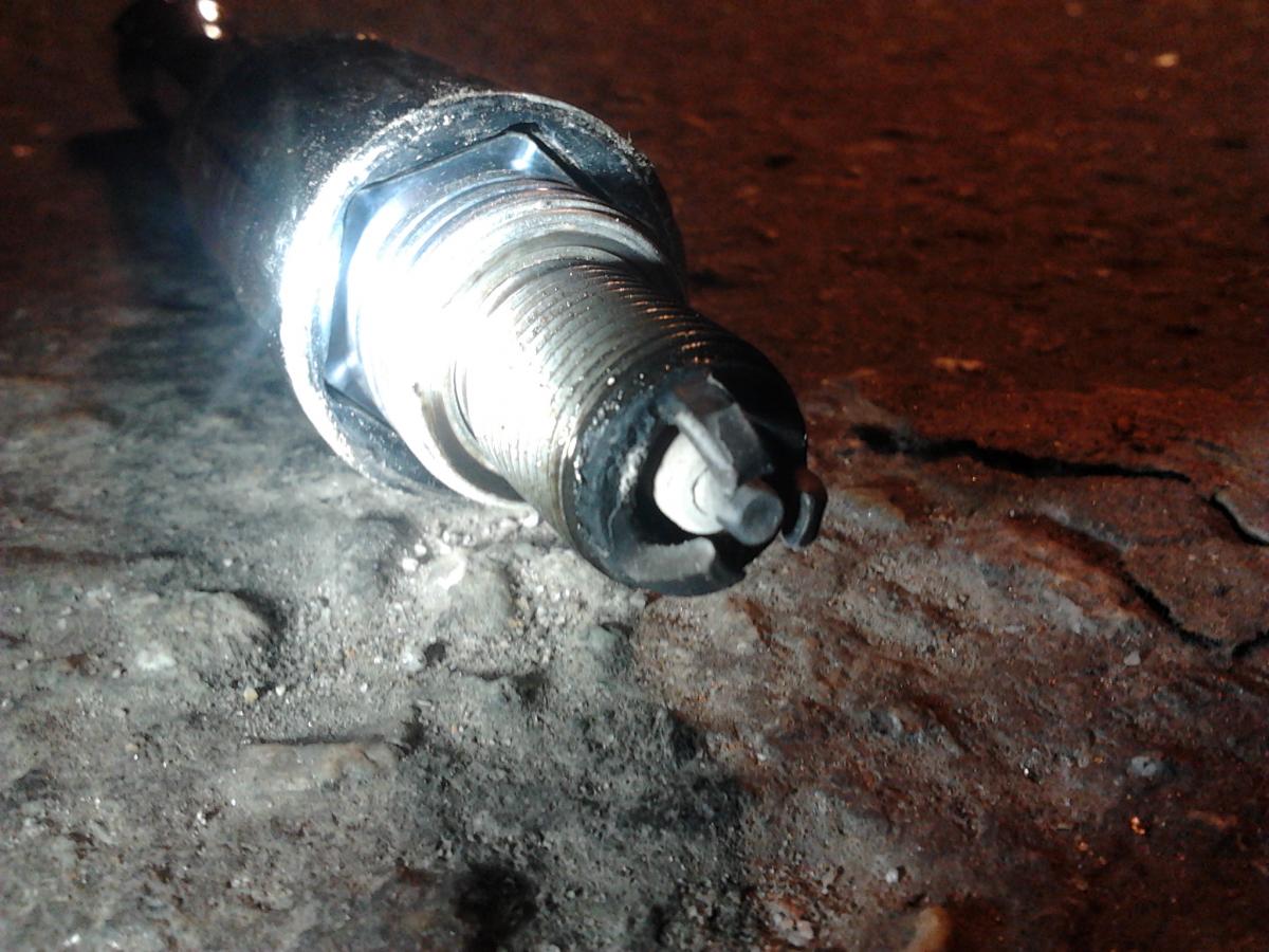

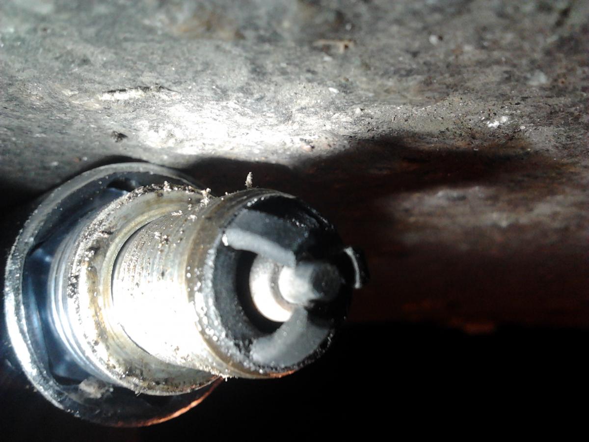

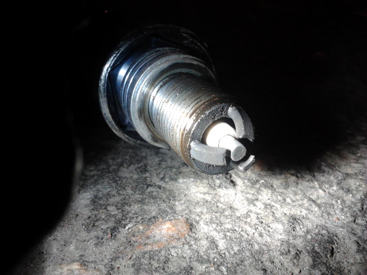

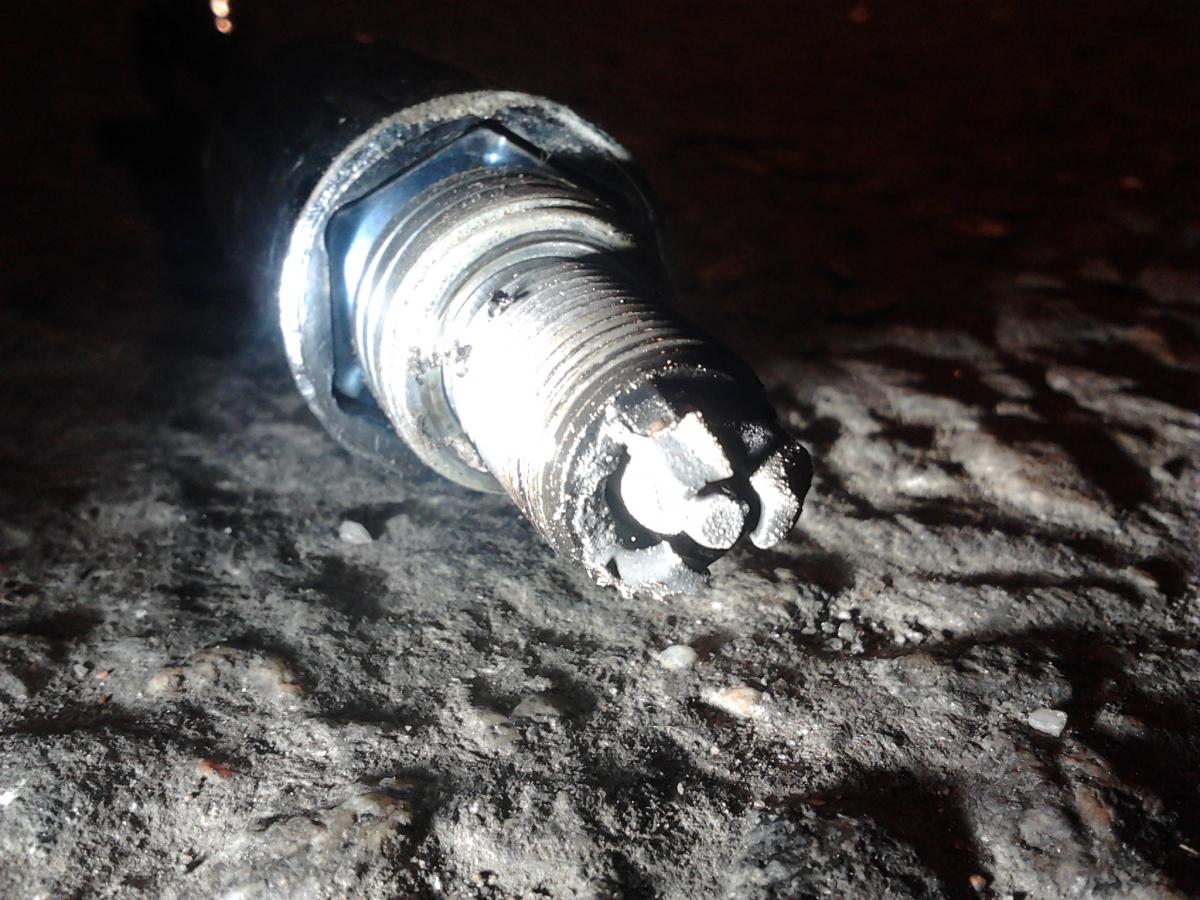

Show us how the spark plugs look like.
They look ok except no 4 (distributor side) that has some buildup.
Did hopefully manage to cure my issue by cleaning up the venturi the lazy way. There was a bit of carbon around the throttle valve which was removed using a little brake cleaner and paper. It now seems to run just fine. Still have the oil burning issue though but its probably the piston rings and i got no time for such major surgery at the moment so it will have to wait. I seem to be lucky considering the tripmeter so i take my chances with it :p

yeah it's burning a fair bit of oil by the looks of the spark plugs, what are you going to do about it? nothing i guess, it's got a biblical mileage and you've said you are going to do no sugery on it, what it probably needs in an overhaul or a replacement engine to cure it
It's burning about half a liter of oil for every fifty liters of petrol, i can live with that for now. New rings would be nice but considering the amount of work and not having a proper garage to do it in, i probably just replace the car eventually (or get myself a garage :D).

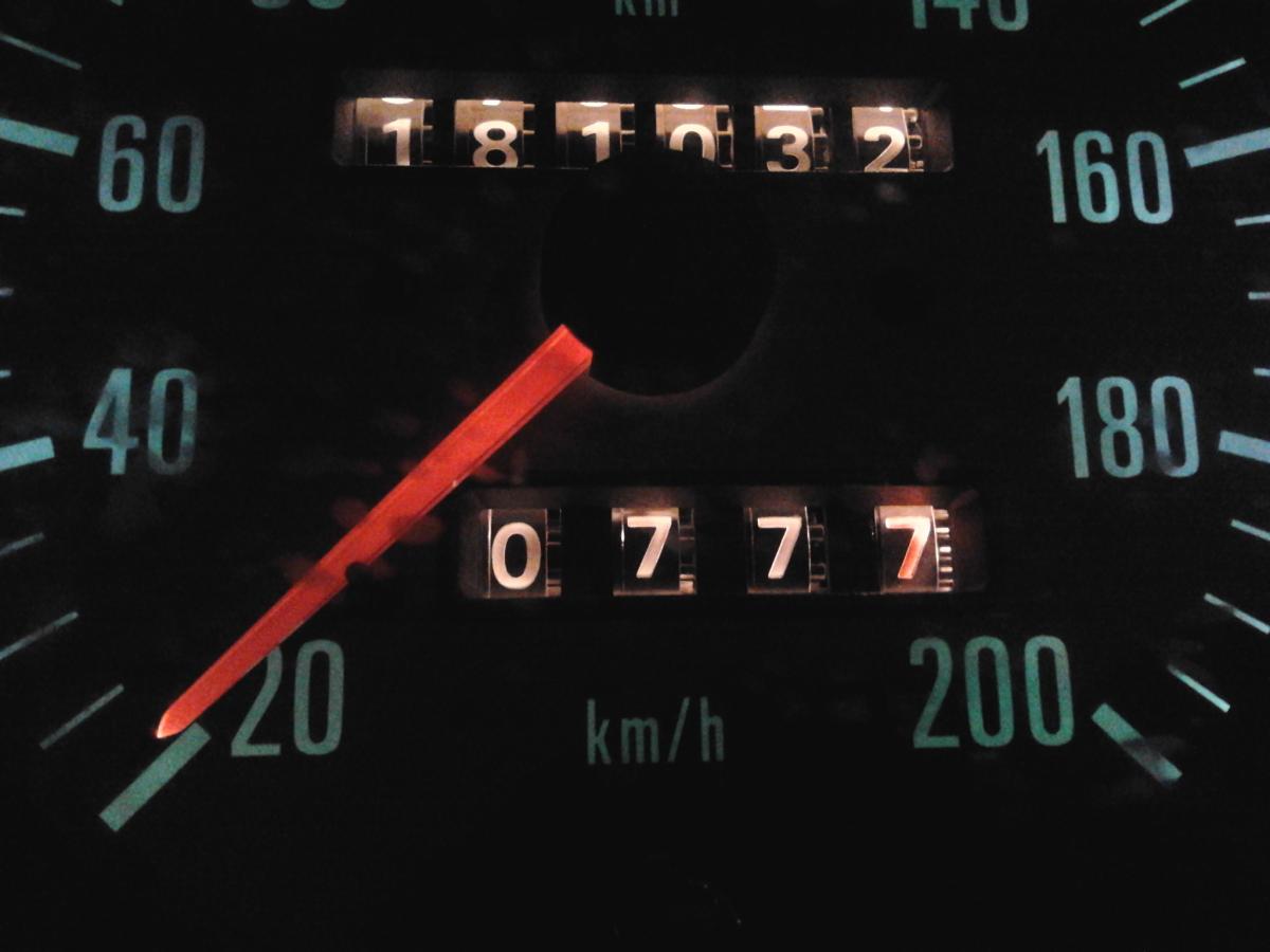

Thats km, not miles.
So 180000km is not that bad of a milage.
