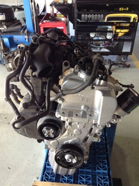

Do you want to know the difference from CAVE to CTHE in 2012, & then the Software Updates since then the Oil Spray Jets,
Or do you want to know what the Parts used were when there were Rebuilds of CAVE engines before they started fitting Short Units then Base Engines?
From 2009-2014 there were several different Engine Management / Software changes and at least 4 different ECU's used.
OEM Spark Plug types were changed, the plug gaps were changed, as was the Oil Filter type, water pump and there were changes with Injectors but this was because of faulty ones.
Up the page is a Pinned thread with links to Lucifers Ultimate Guide.
Also in the forum there is a thread with some of the changed part numbers for Pistons, Rings, Scrapers, valves etc.
http://briskoda.net/forums/topic/279292-cthecave-enginewhats-the-difference
http://briskoda.net/forums/topic/455901-no-record-of-new-engine-fitted-to-vrs-tsi-under-warranty

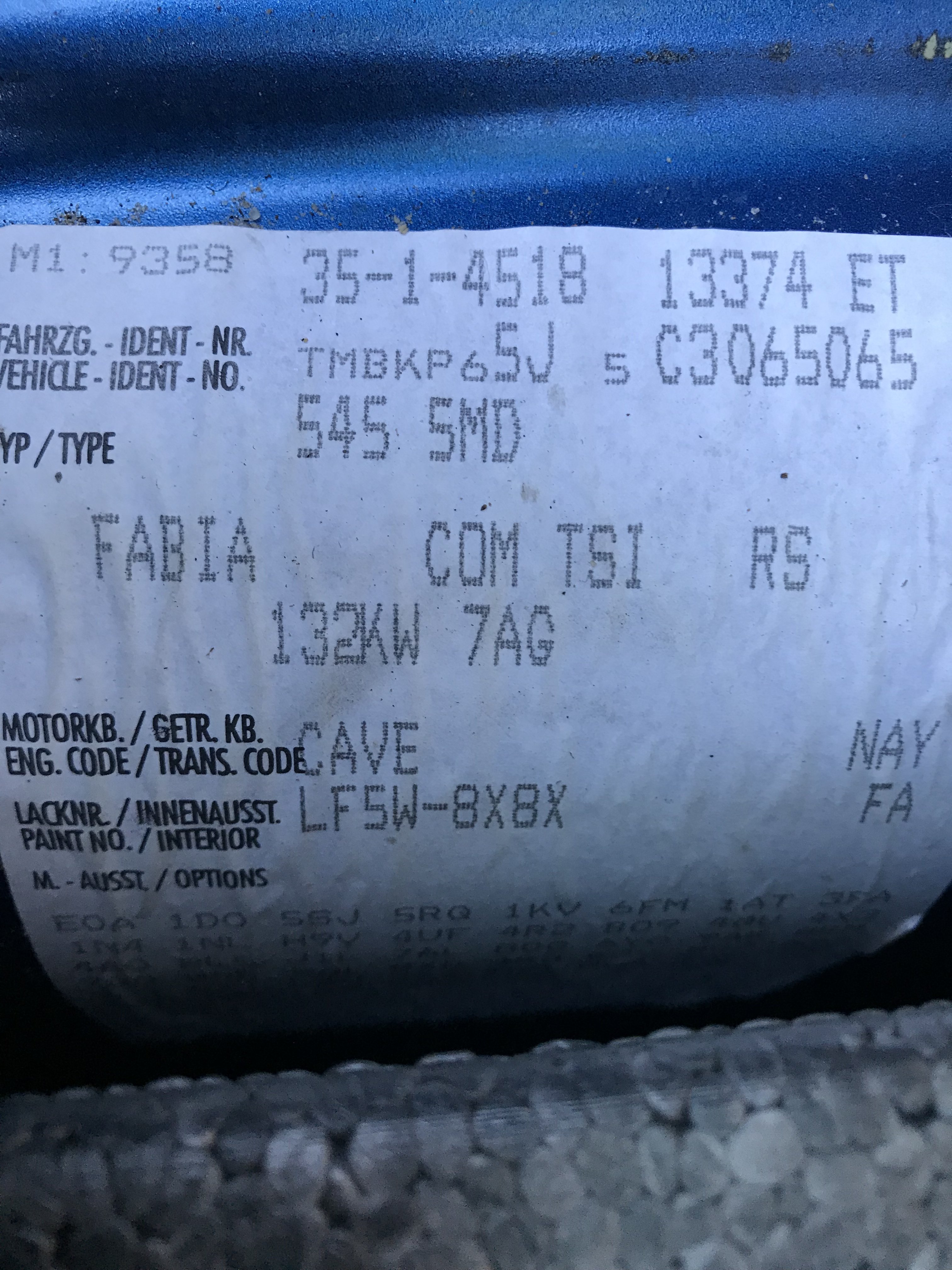

Hi Skoffski, what I'd like to know now is specifically what parts were changed by VW/Skoda when they "replaced an engine under warranty" because of the known problems with the block (pistons and cylinders). Did they only replace the engine block, leaving the rest of the original engine, or did they also replace injectors, pumps, turbo and (most importantly) the ECU ?
I am interested in the case of old engines (2009-2010) which failed post-2012 when all the upgrades had been developed, so all the new parts, if replaced, should have been of the upgraded type (?), including the ECU as you have said. Thanks again for the info.

In the UK in 2011 they rebuilt the block as in new pistons and rings / scrapers, by late 2011 they were supplying short units.
Same head and the rest fitted, new spark plugs (usually) , oil & Oil filter.
Then Base Engines were supplied, Head fitted, new plugs, sometimes new belts for water pump / supercharger.
*Some cars got a new Cat fitted as they were ruined by an oil user.*
Some members here and owners had to fight to get that, but with a Master Techs support often they would.*
then we had CTHE engines late 2012 and some failed early, see pinned thread at top of the page.
Some CTHE that were oil users even had the Breather Mod done which should have already been on, then some got the New Oil Spray Jets fitted and a software update.
Some CAVE engines replaced were exactly as the failed engines and some even failed again.
There were different things happening with 'New engines' off the line and Refurbished engines that look as new from the VW factory.
There were replacement engines fitted to CAVE and to CTHE that would not run on the ECU on the car and new ones were sent out from the factory.
So basically it is all balls, buffets and banquettes but mostly balls.    You need to be a detective to work things out because VW / Skoda / SEAT / Audi will not tell you.

So what exactly did they replace from 2013 onward ? Just the block or also injectors etc. ? Did they leave the same ECU (from original CAVE) or put a new ECU (for upgrade to CTHE) ? Did they communicate what was replaced and (if applicable) new engine code, or did they simply say "it's a new engine" ?
