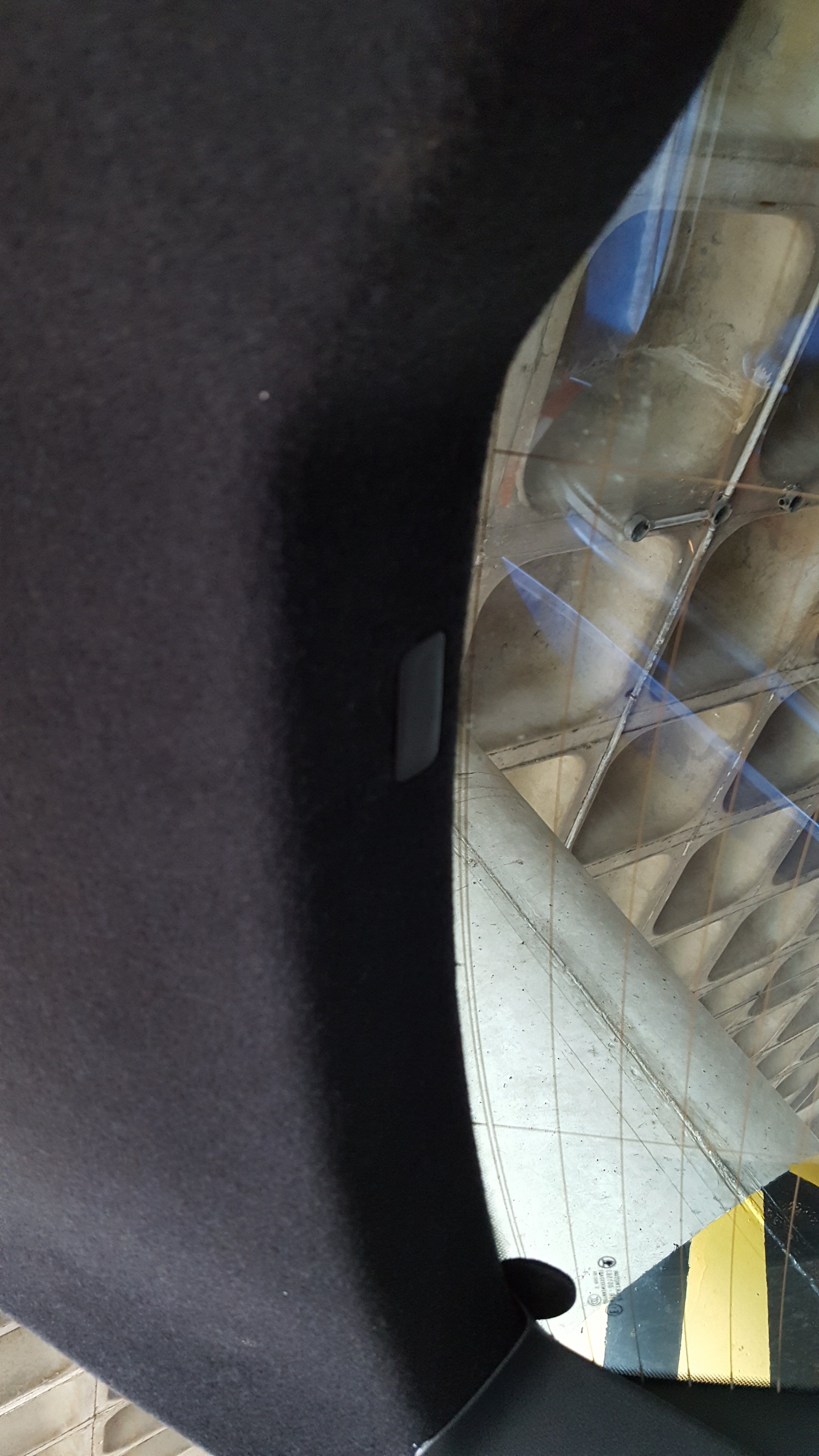

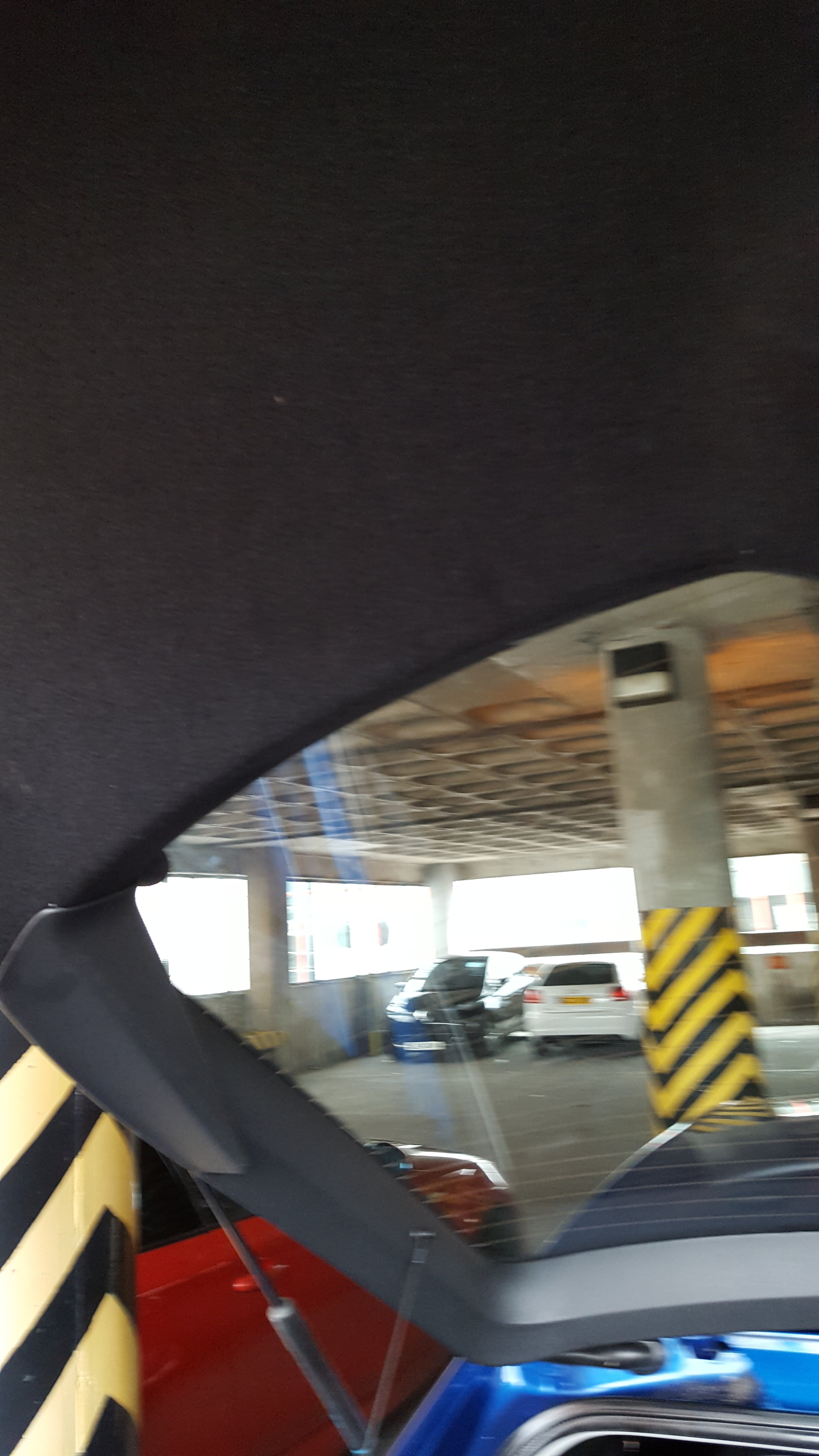

I removed the rearmost plastic trim, as I thought it was maybe resonating against the glass. Had no effect.

So is this the thin plastic trim around the edge of the boot lid that you removed? Just so we're on the same page...

This panel.

Thanks for the pics, those are the panels I was talking about earlier. Shame it's had no effect but thanks for trying
