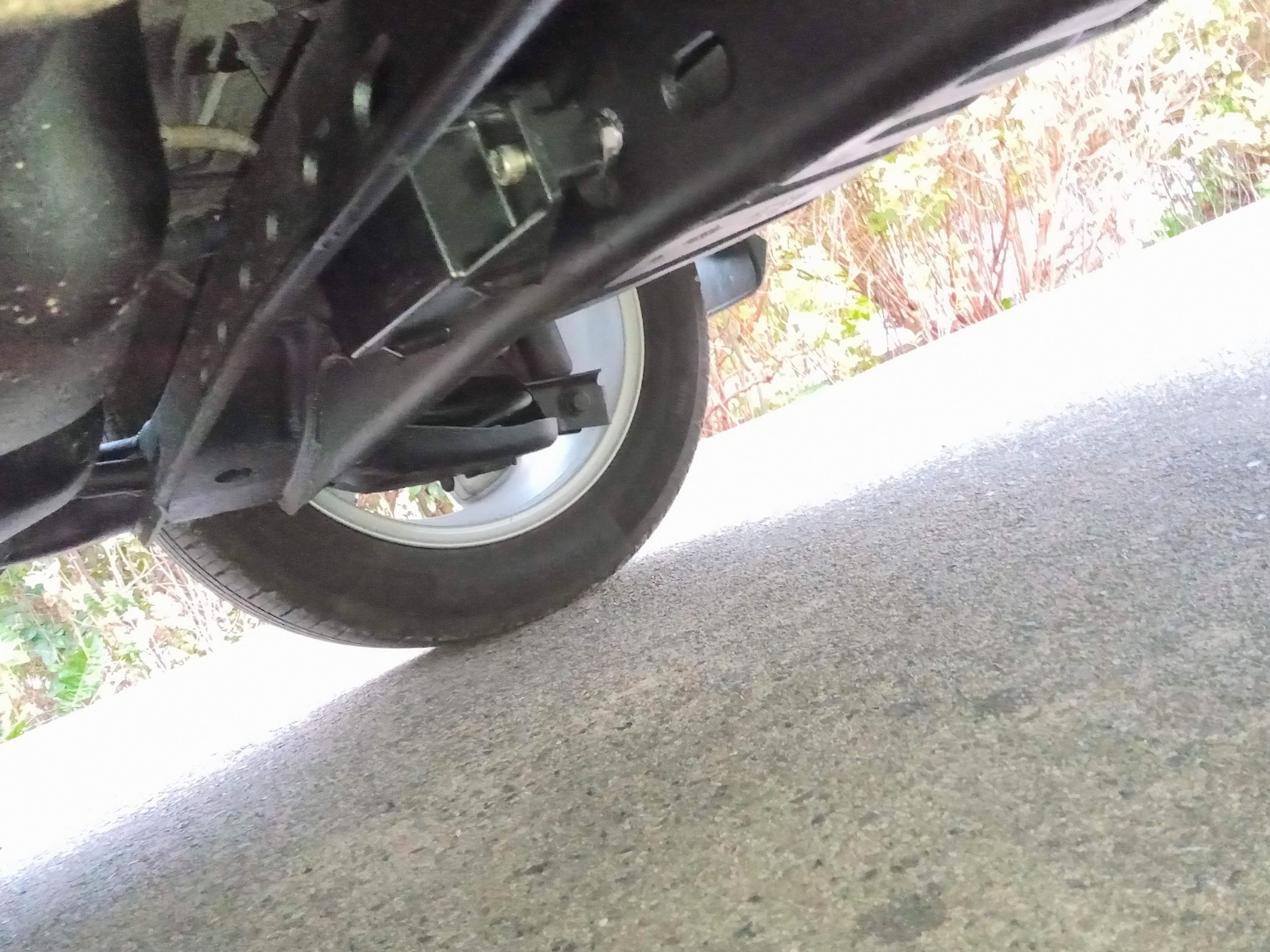

I have a 2015 1.4tsi with the solid beam rear axle. I fitted a Volvo vibration damper which are easily found on ebay, cleaned it up, painted it and bolted it onto the inside of the central part of the rear beam using stainless steel bolts and locknut- photo shows my car with Volvo damper fitted.

And have you noticed any difference fitting it?
Yes I did notice a difference when I fitted it- it was 2 or 3 years ago now. If you look back at this thread I posted details of all the mods I have done- only one more thing to do for me is have my Bilstein B4 front and rear dampers fitted- were scheduled for last summer but my mechanic was too busy so definitely fitting them this summer- I can fit rears myself. Top tip if replacing front dampers always fit a new fixing bolt as the old bolts can stretch and the new ones have factory loctite on the thread- if you reuse the old bolts they will come loose- I have seen it happen!

what was the difference? Less road noise? Booming?
Both - used to hurt my ears now much more tollerable- there is one particular part of road I travel back along every day from work which has lots of undulations and if I drive over them below 30mph the sound of the rear suspension going up and down reverberates through the entire car- I'm hoping the B4 Bilstein shock absorbers eliminate or at least reduce this- never had such a boomy/uncomfortable suspension car in my life! To tolerate this car has taken a lot of time, money and effort- at last count its cost me £670 for all the parts- Inc shocks not yet fitted and  not including 4 Goodyear all season tyres- which didn't make any difference that I could tell

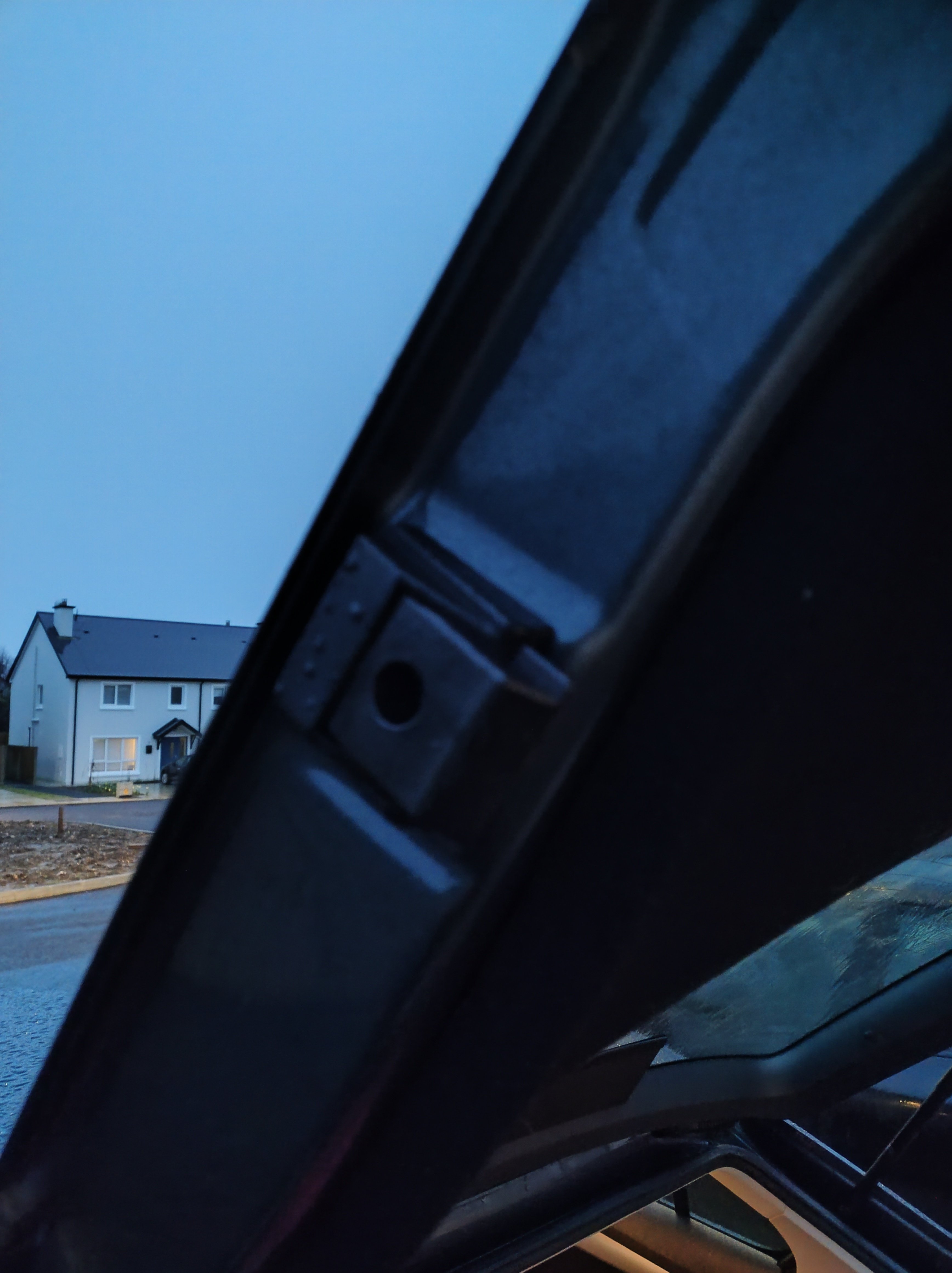

Also, can these be adjusted (left and right side of boot door)? I've adjusted the dome boot stoppers to be looser and that seems to have dulled the boom slightly.
My stoppers does not look like that. I have a 2020 model MK3. Maybe they changed them from 2018.
Would be interesting to know if I could do any adjustments.

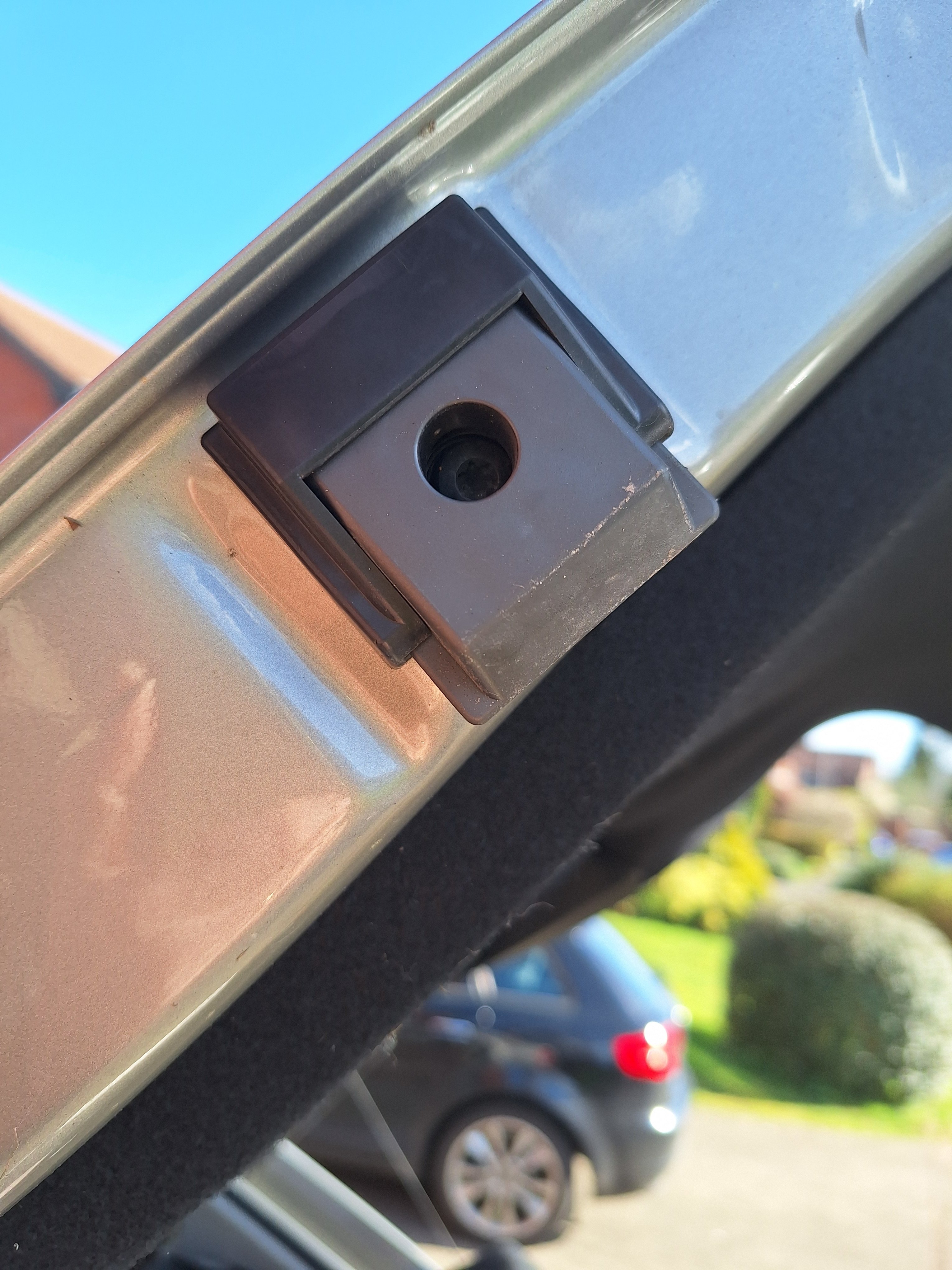

Hi Corcaig the damper I fitted is completely removable- I did fit it with atainless steel fittings and locking nuts so it would never loosen by itself- I have had several mot tests and nothing was said. My boot stopper looks almost the same as yours. I did fit new ones which were an improved design- I don't remember if I adjusted them or not as it was a few years ago- can you push yours inwards- takes some force but mine do move. Best wins I found for noise harshness reduction were torsion beam Volvo damper, lots of soundproofing in spare wheel well- if you have no spare wheel I didn't so I bought one and the fitting kit for it plus a boot rubber liner and finally spraying insulating foam in the drivers side roof pillar- not easy but a good result

Mastercard please read my post on 8th February then you will see about Volvo damper- it fits onto the rear beam of the axle. Also from your photo you have an estate don't you? My car is a hatch/saloon so boot buffer is different and I do not know if it is adjustable sorry.

Hi, yes, my stoppers can move inward, was there much benefit changing them?
  • 3 months later...
When I changed them my boot lid stopped vibrating.
