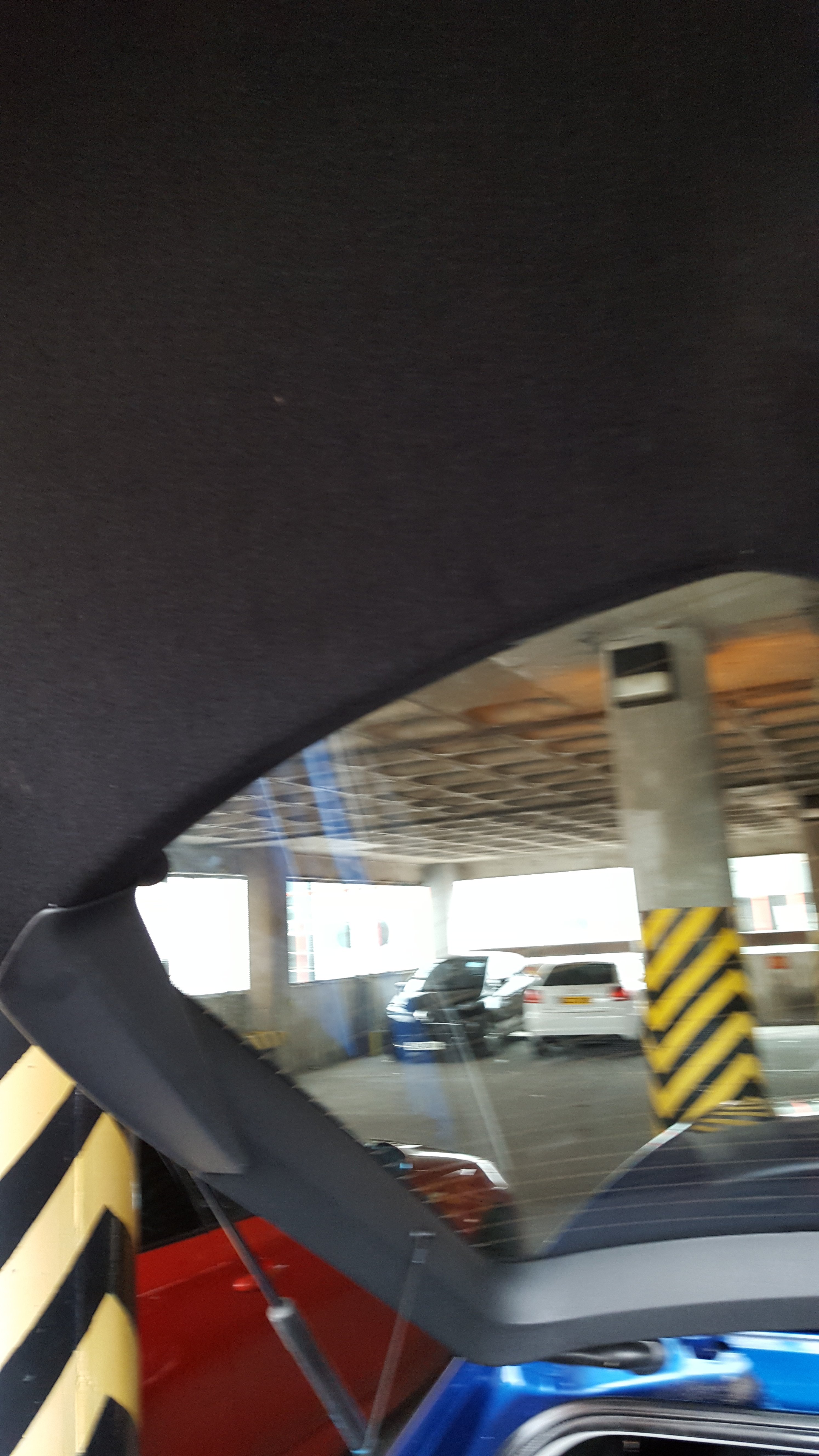

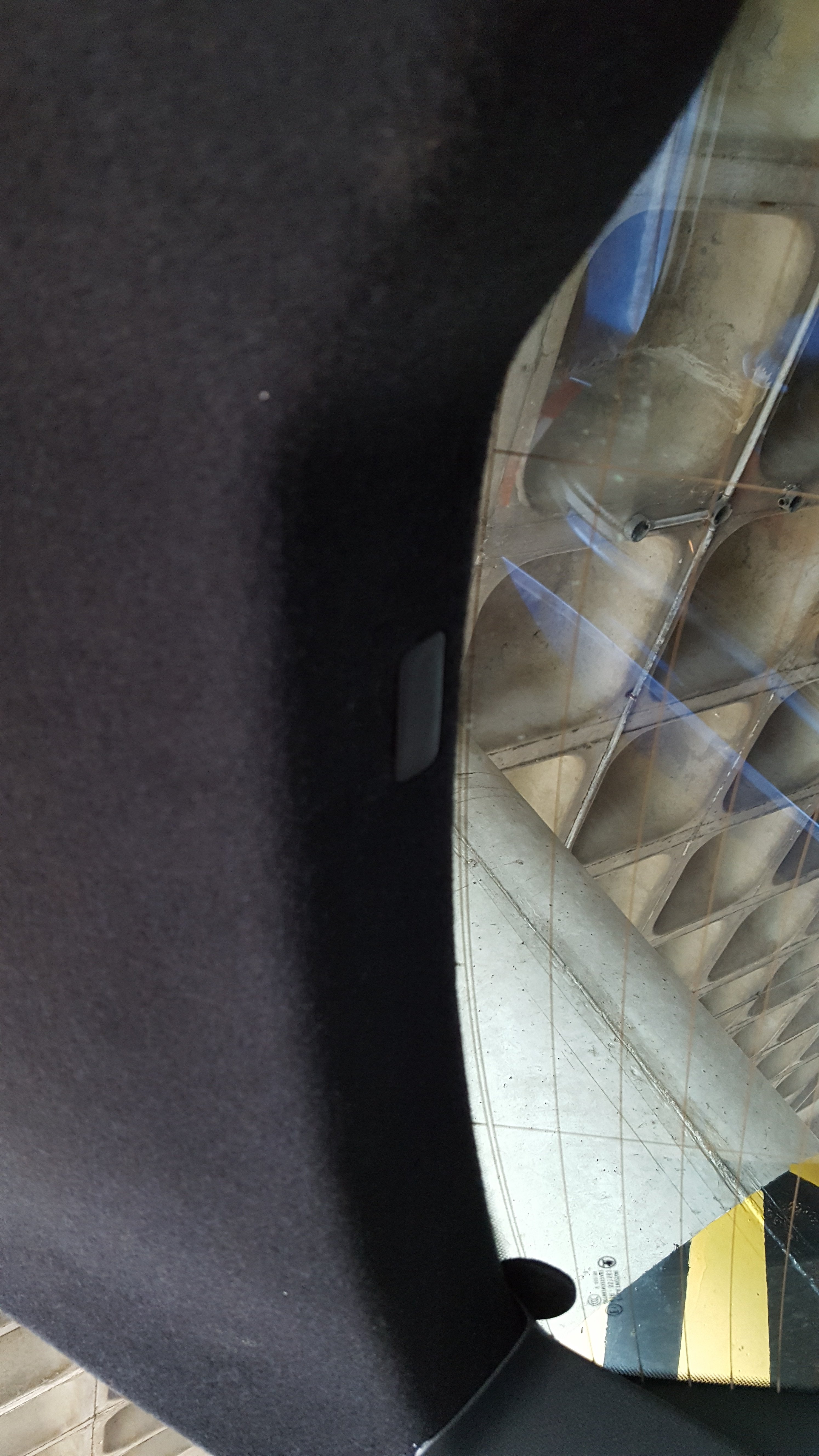

Noticed that the rear interior trim has a bit of play in it, of you push it in it gives off a bit of a rattle.
Padded with felt pads but made little difference.
From driving it sounds like the whole bootlid if vibrating
From the driver's seat it does sound like it is coming from rear left though
