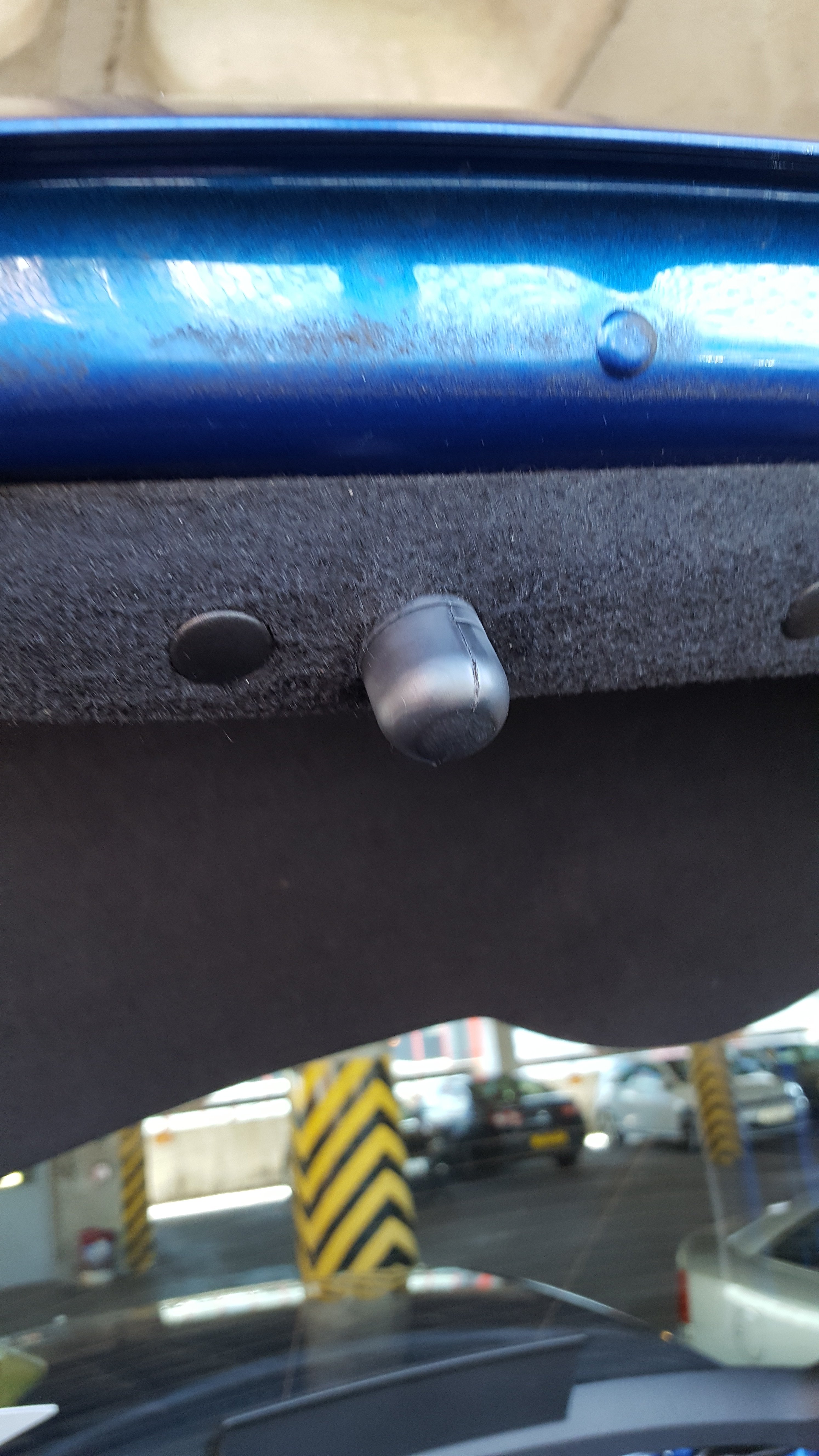

I'd previously only been adjusting these domed stoppers, to no avail:
The domed ones... I've left them now fully screwed in tight.

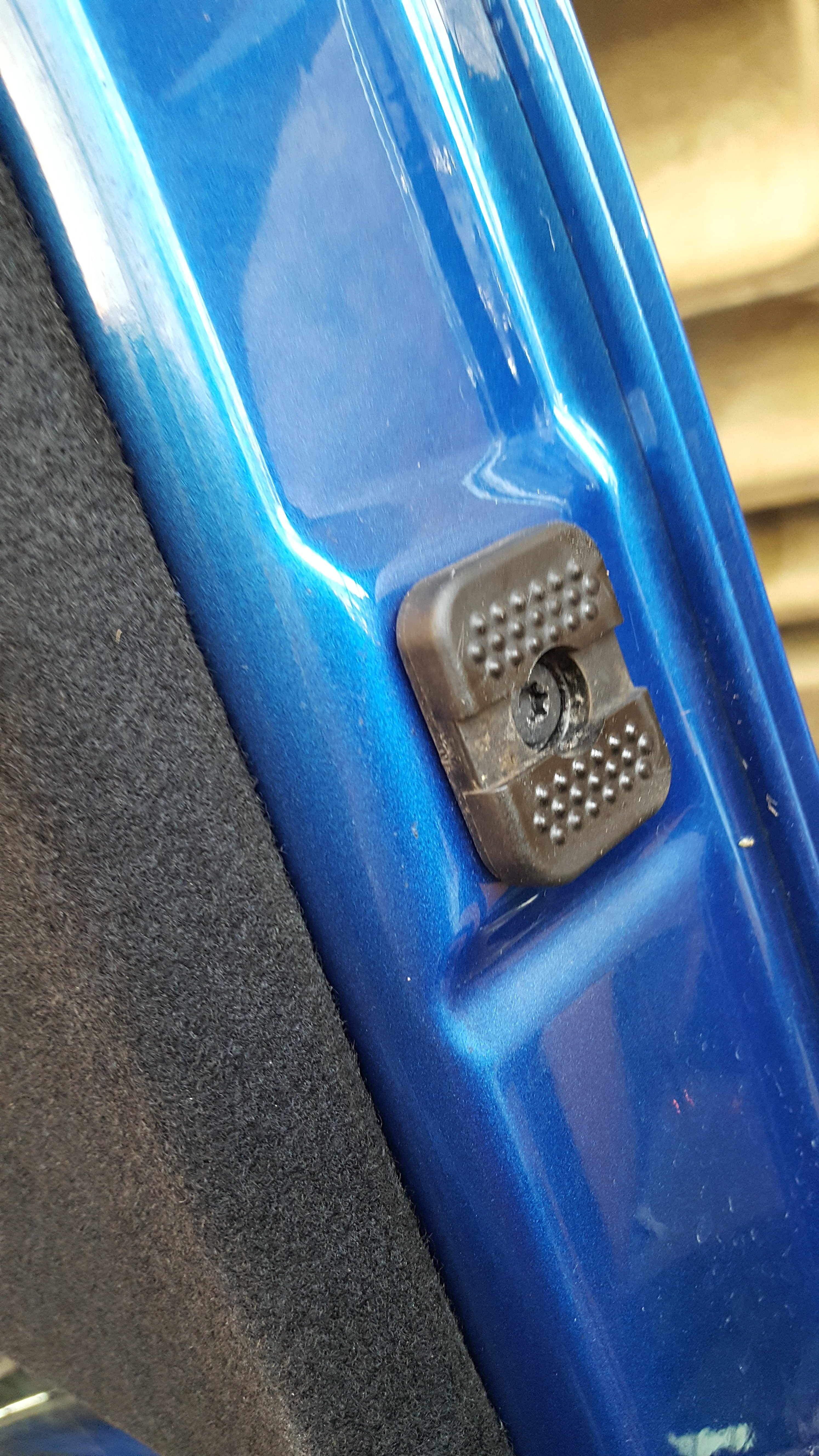

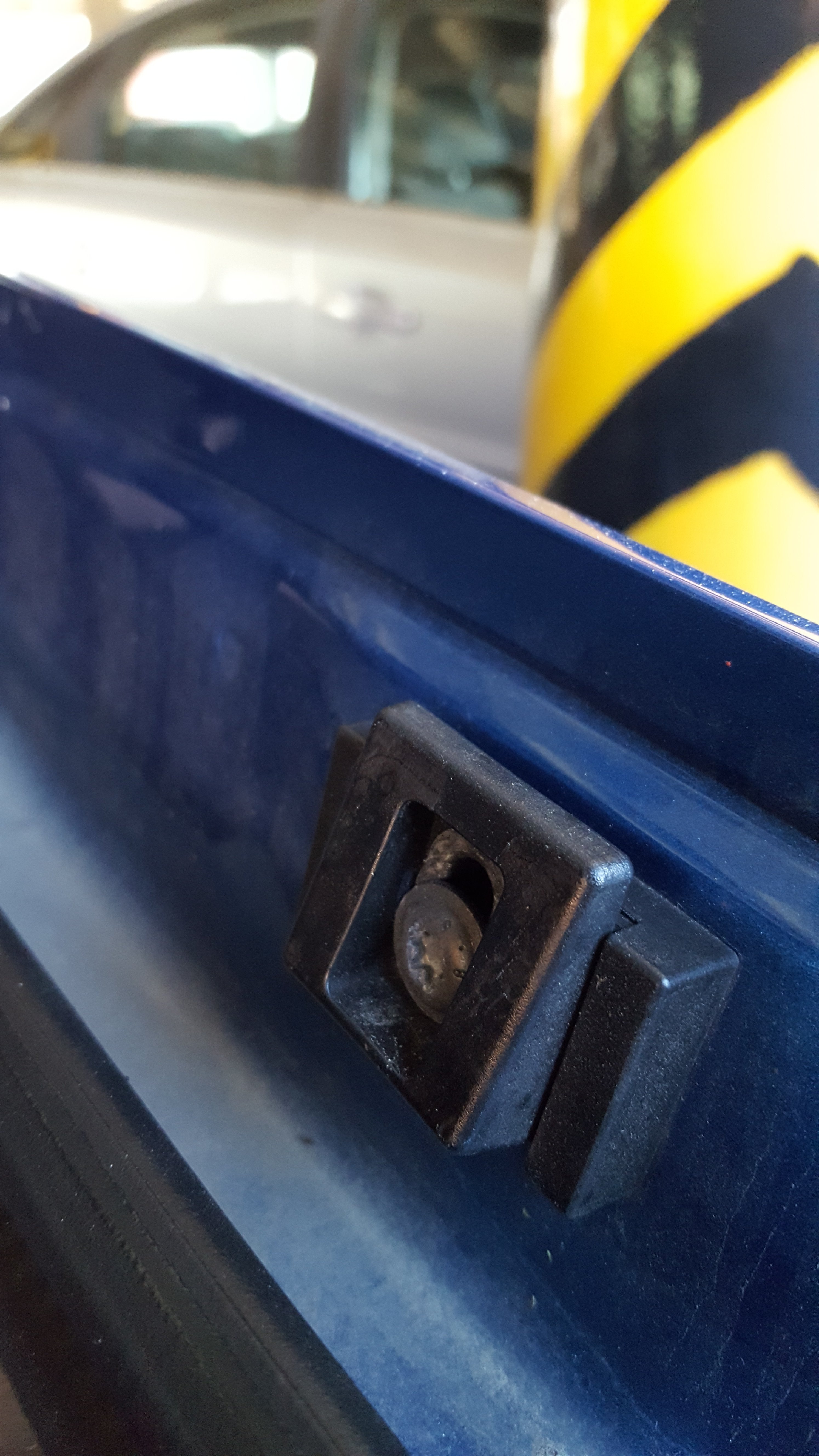

Only last night I was made aware again of the other stoppers on the left and right. Here is the rubber contact on the boot lid itself which isn't adjustable:
This is meant to contact with this part on the body of the car itself:
However I thought this wasn't adjustable... it is!! You need to really give it a shove, though. In the above picture, that's how it is now. Before, the middle bit was lower down, so the boot would have to travel further down in order to contact this. But when I closed the boot, I could almost still see that these weren't contacting - the boot was freely moving! No super-duper rubber tight seal.... So I pushed the middle bits up so that there should now be a connection - too hard to see now but I think I can feel it.
I drove in today and honestly, 99% of the time it was perfect. Still a hint of it over big bumps but I *think* that's the same for most cars. I need to check it over more yellow traffic light non-skid road but I did go over some today and didn't hear it.
Fingers crossed but I think that's it. Might have saved myself a lot of money here...
Please for those with AND without the issue, can you post a pic of how high up those stoppers in the last image are on your SKODA?

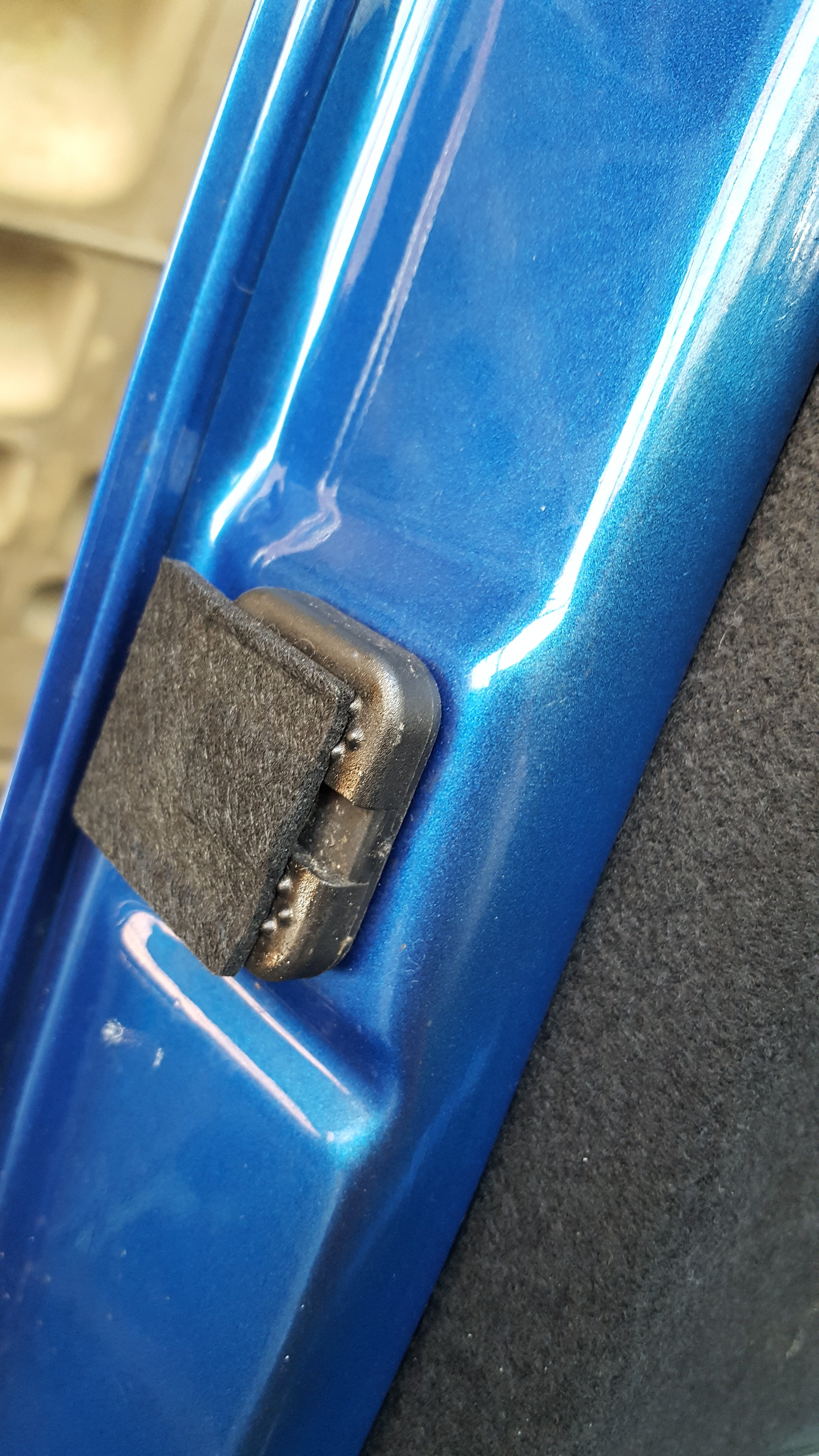

FYI if those stoppers wear away over time I can see how they'd need replaced. Are yours in good nick?
I'll take pictures later, it is just over a 3 year old car - the newest car I've ever owned - so I'd be surprised if they were that worn, at one point had added a self adhesive felt square to the stoppers to try and increase the potential contact, made no difference and they just ended up falling off.

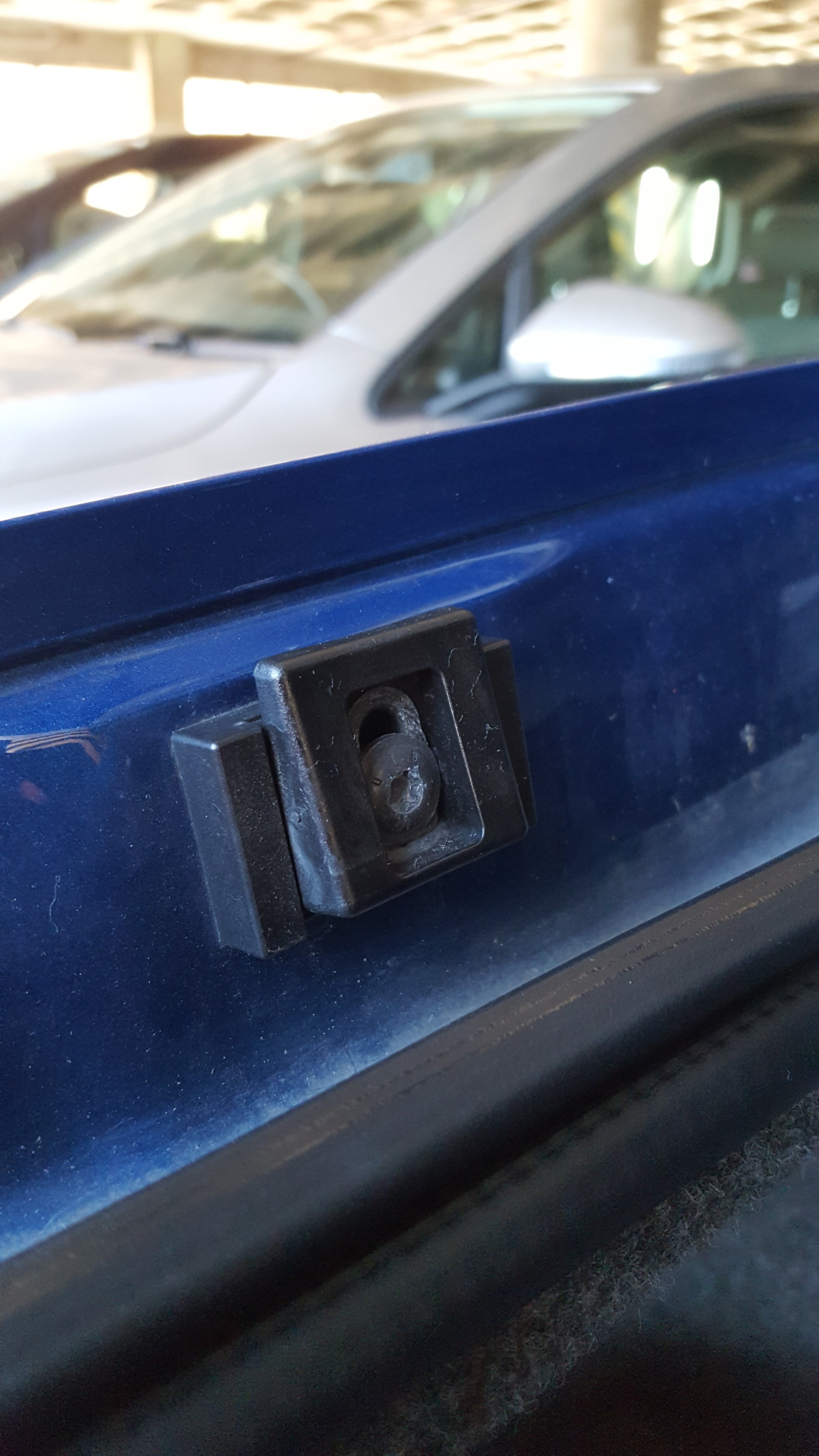

Pictures of my side buffers
One side buffer where the felt square is still in place
