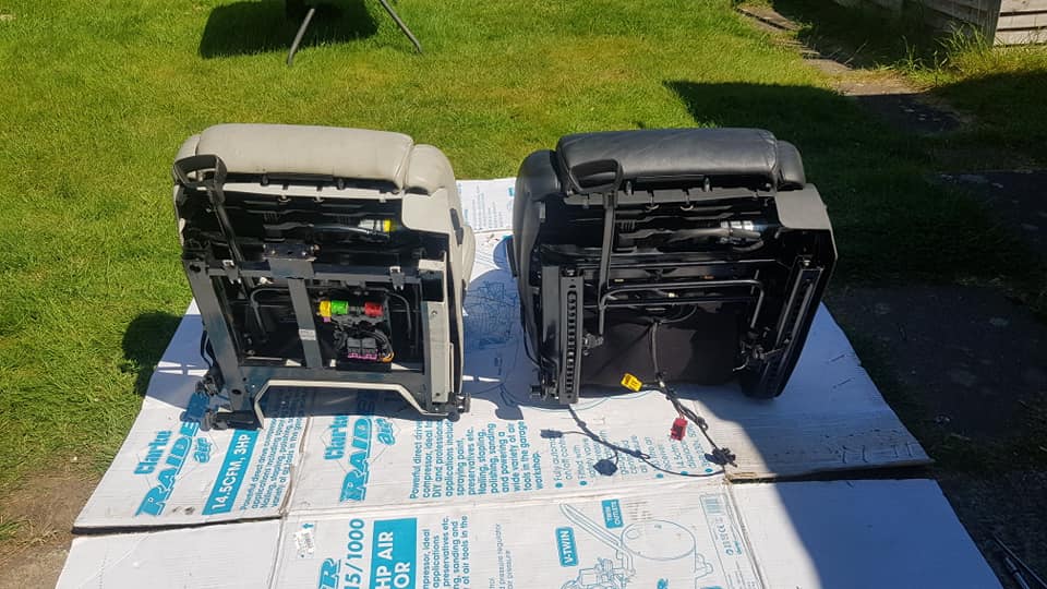

Hello could anyone tell me if you need to buy an adapting bracket for s3 seats to fit in Skoda Octavia vrs mk1 can’t find any answers anywhere.
As long as the S3 seats have still got their original subframes on, they bolt straight in.
See pic below, cream seat has it's original subframe, black one is missing it's subframe.
Right thank you now I get it. My seats are missing their subframe that’s why they wouldn’t fit.
Sometimes people sell the subframes separately as they can go for strong money when you find them. There is a set on Ebay asking £240.

I’ve managed to sort it, the person who I bought the seats of said he forgot to put the subframes back on and he’s shipping them to me.
