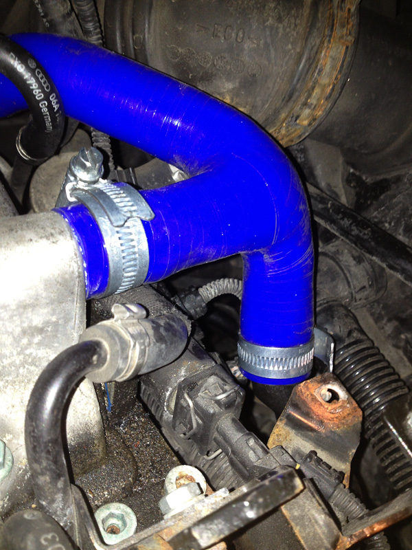

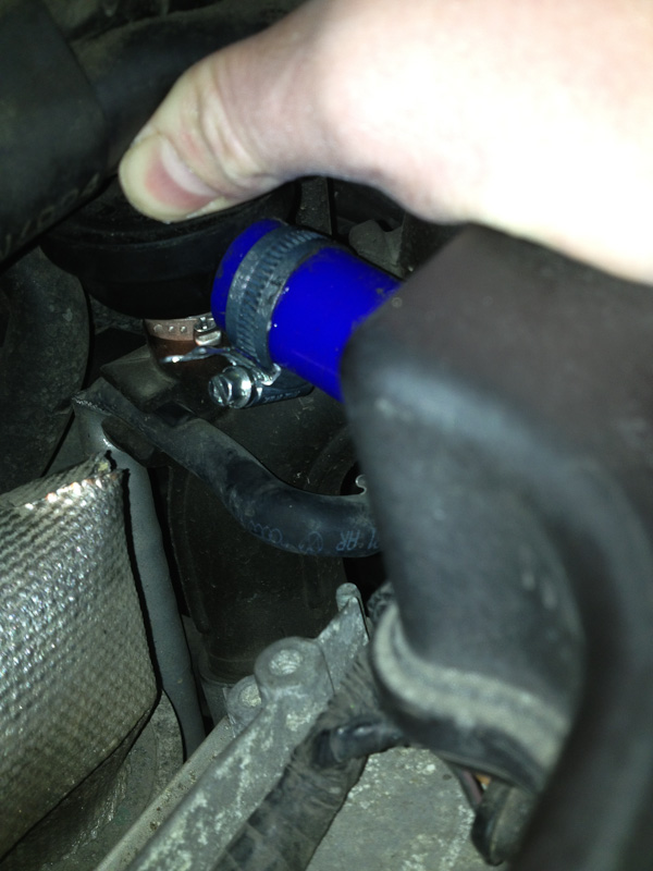

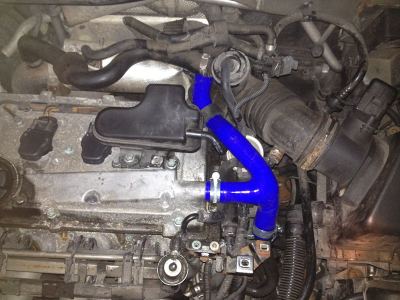

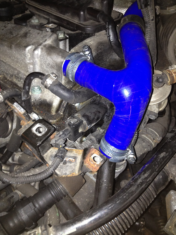

Here are some pics - just to (hopefully) prove I haven't made a complete pig's ear of it!
For the record, I didn't try and fit the casing with the jubilee clip on the 'outside' of the lower join on the Y-section. ;)
