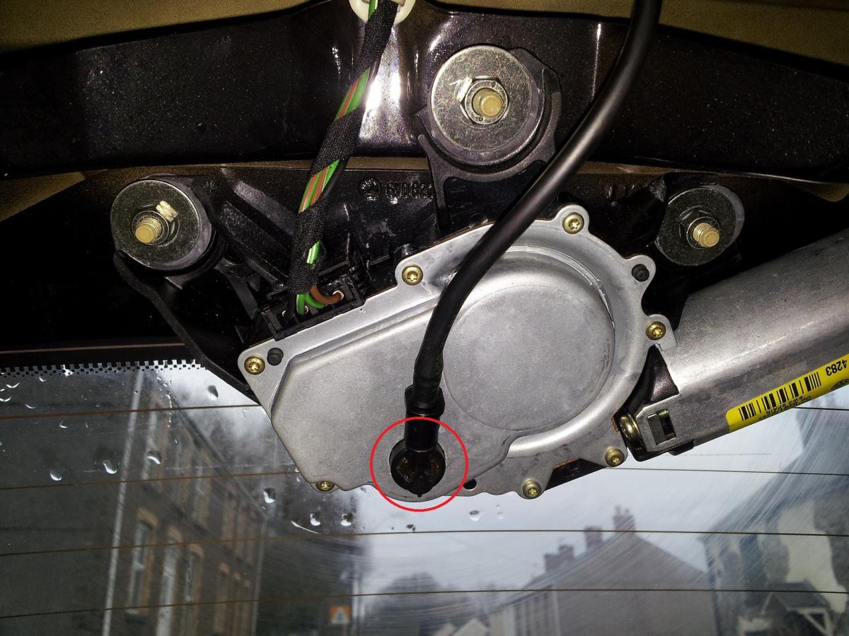

Recently my rear washer has been weak so after some investigation I've found that it is leaking into the boot catch, at the joint between the pipe and the rear wiper motor assembly. Its not leaking where the pipe meets the 90 degree bend, but out of the back of the black 90 degree bend itself.
Can this be fixed with a few small parts or do I need a whole new motor unit?

Sounds to me as if the jet is blocked or (common) it is frozen
Radiotwo
I pulled the jet nozzle out and blasted it through with GT85 and it seemed fine.

'PastyBoy', on 26 Apr 2010 - 19:59, said:snapback.png
if the mechanism is corroded and broken inside you'll find that the washer starts rotating in sync with the wiper arm.
Theres a repair kit available from VW thats about 30 quid - was a doddle to fix mine and replaces the corrodable metal bit with plastic parts so it doesn't happen again emoticon-0148-yes.gif
This sounds like it

Looks like I need the repair kit V8L0 998 711

Did you manage to buy the repair kit from VW?
My local VW and Skoda dealer say they can't supply it as it's an Audi part number.
Well, Audi can supply it.
Part no is 8L0 998 711.
£44.63 :(
I've found TPS will supply it to me, and they have stock :)

It's Lincoln branch
Just be warned of one thing though, different cars use different lengths of shaft/spray pipe etc - this I am very aware of having "lifted" a part number from here and assuming it would fit a Polo 9N! So compare parts for length first before you end up with a wrong kit that you can not return - I had partially fitted mine so there was no way that it could be returned as "unused".
