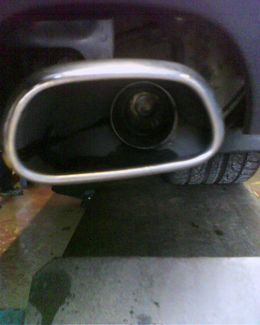

A MOT tester will have a good idea as to whether a DPF has been removed or not.  The photo below shows an exhaust tail pipe from a 21,000 mile diesel car with a DPF.
The inside of it is completely free of soot and it was backed up by a smoke test result of 0.01/m, which in my experience is a little on the high side as usually on that particular type of car I can't get the smoke meter to register anything.
Smoke limits for a turbo diesel are:
upto 01/07/2008 3.50/m
after 01/07/2008 1.50/m
Whats to stop a new substantially lower limit coming into force for cars from a certain date?, 0.5/m would likely weed out cars without a DPF.
If a tester suspects that a DPF has been removed and does pass the benefit of any doubt to the vehicle presenter, there's nothing to stop him voicing his concerns as an advisory, which would then be on the vehicles permanent MOT record.

Also as previously mentioned a sooty tailpipe isn't the for the sole reserve of non-DPF cars. The DPF on my vRS was on its way out and that had a sooty tailpipe.
