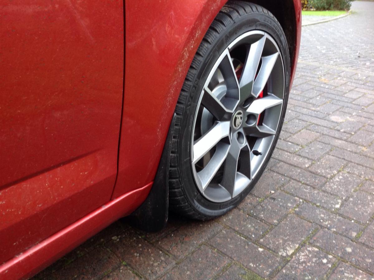

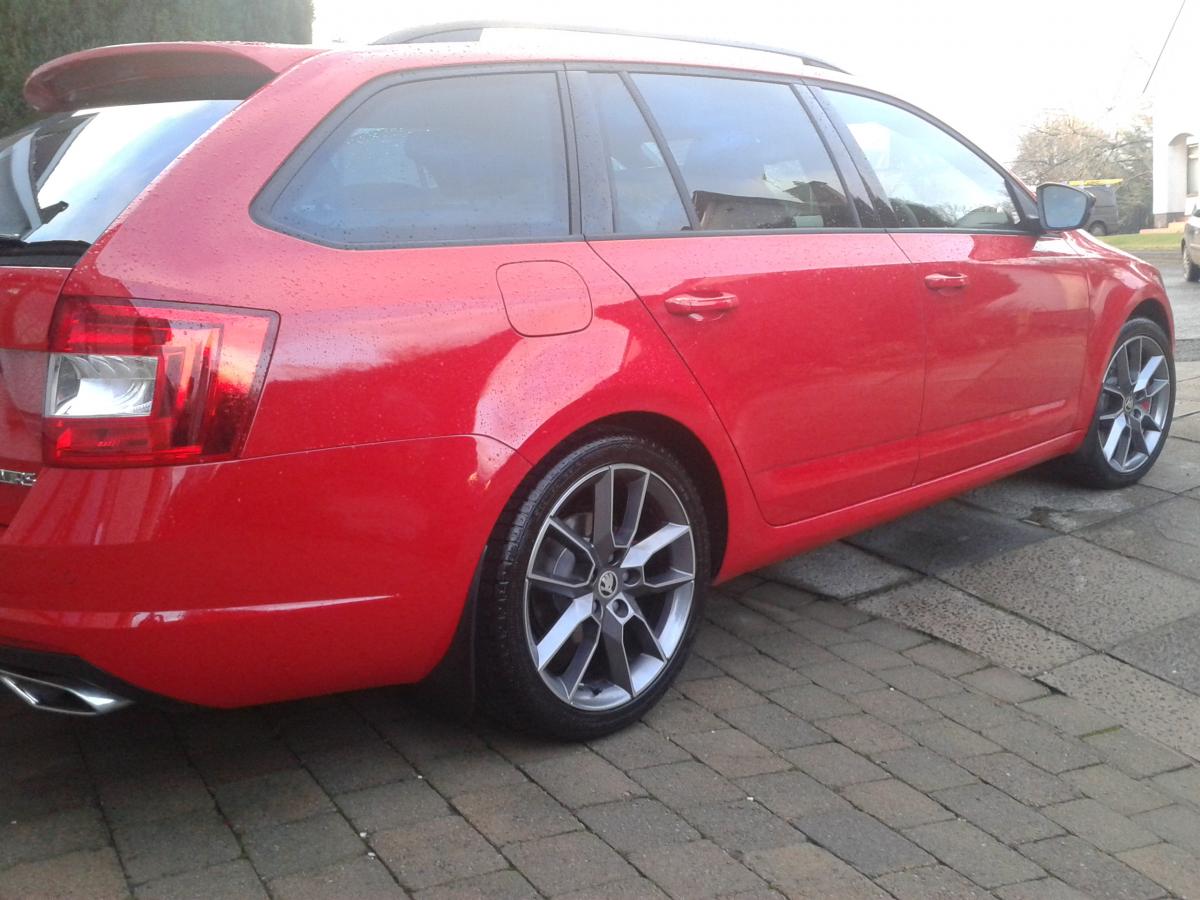

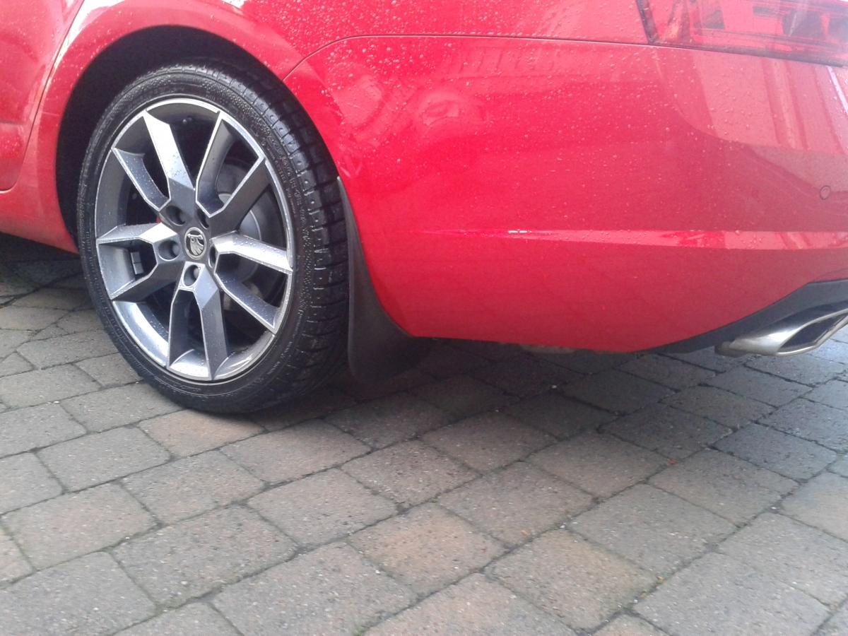

Hi Parsey83,
Just had mine fitted today by Dealer - went straight on without any problems. £110 fitted, parts were £74 I think, fitted the last fronts to my old MKII VRS but for the £36 simply didn't have the time/inclination to fit to my MKIII.
They are pretty inconspicuous:post-106713-0-31787700-1386453828_thumb.jpgpost-106713-0-57247700-1386453852_thumb.jpg
Great thanks, some amount of crud thrown up over the rear of her so fancy mudflaps

Photo of fitment please.

Is there any drilling required for the rear mudflaps, or do they simply fit and its an error in the catalogue?
I have ordered a set from Hortons - we will see if they fit!
FatFudgeKat, do they ever scrape on the ground - like when go over speed bumps?
No drilling, they just fit straight on!

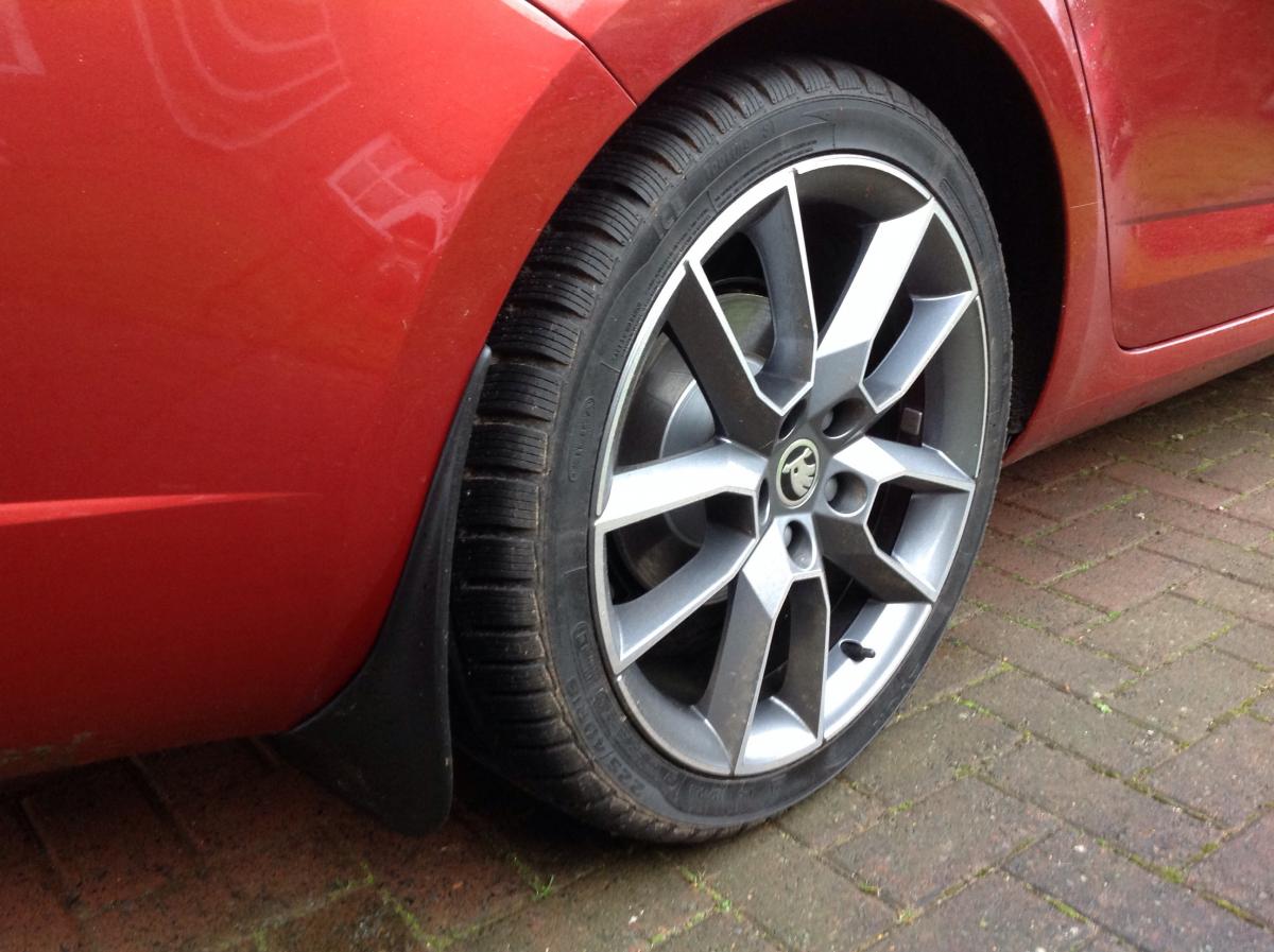

DIY flaps fitted today. Fitted without removing wheels...existing screws fit though instructions state drilling 7mm hole for 3rd fixing to fronts only. I used self tapper instead.
