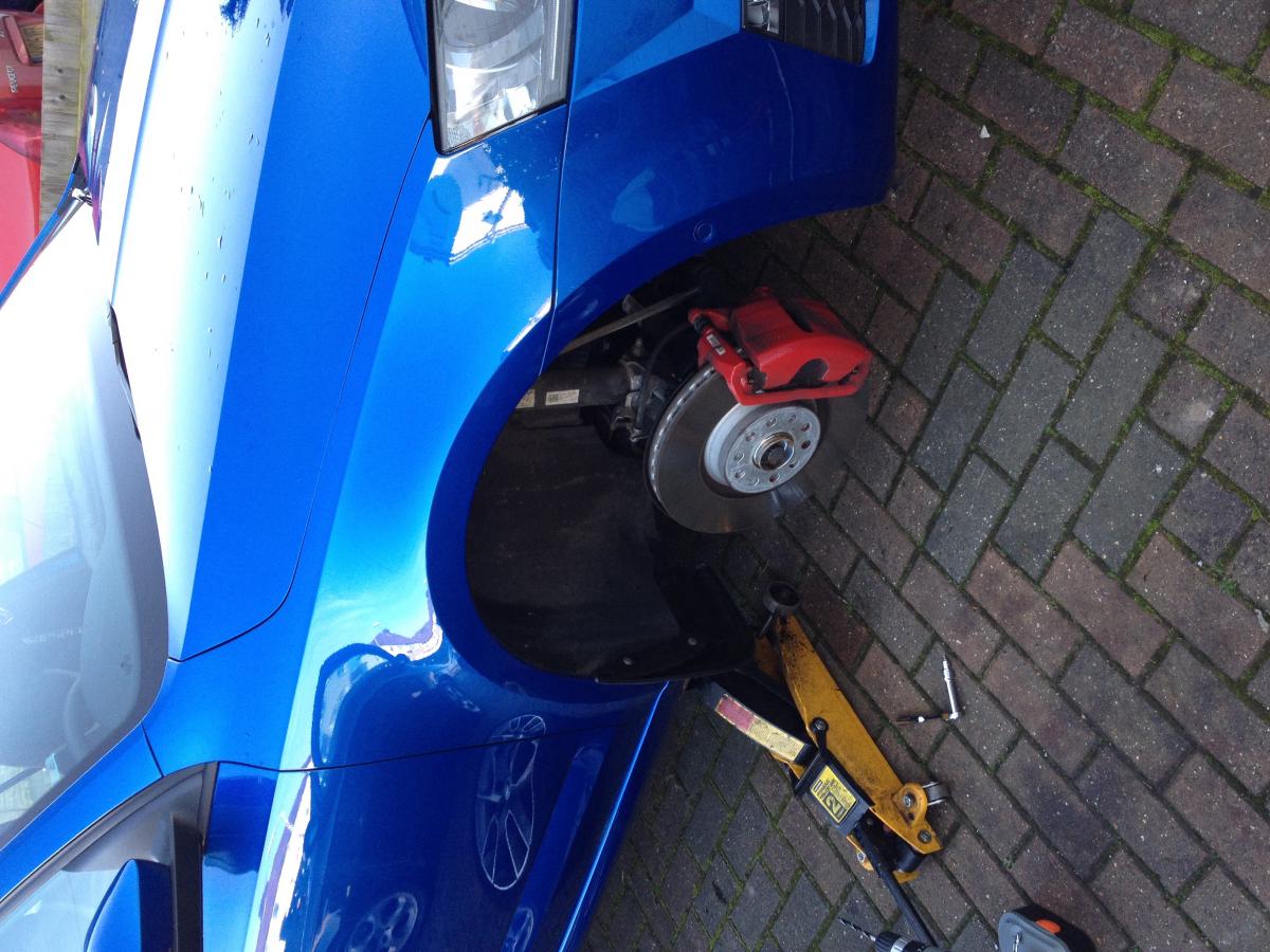

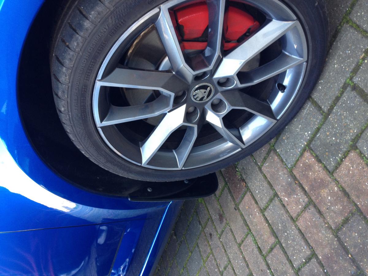

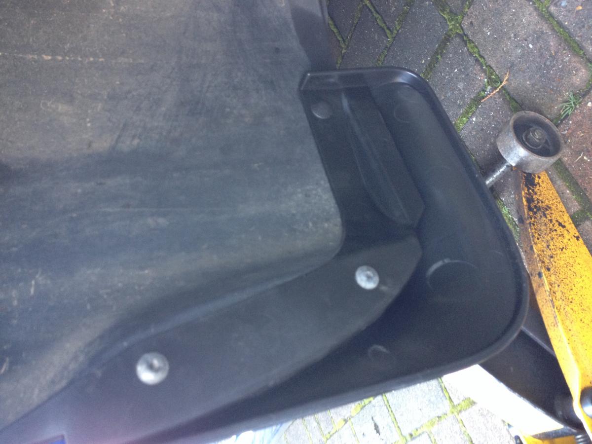

  • I fitted front and rear mudflaps to my vRs estate today. Ordered them from Ireland last week and they were delivered by Yodel on Monday. They're straightforward to fit. Two screws to be removed (hex

Most definitely. If I can do it anyone can! (correct tools required though!)

Fitted mine from Ireland yesterday, no problems. Didn't have to take the wheels off. Although couldn't quite get in with the 7mm drill on the front, but it seems secure with just the 2 screws in place anyway. At some point I may jack the car up and turn the wheel to do it as that should give me enough room.
No problem with the third hole on the rear, lined up perfectly and just had to lie on the floor and reach underneath from the rear to do it.
All in all took about 30 minutes inc a very quick jet wash to remove some of the mud before hand.

Fitted my fronts today - with the wheels off easy peasy no probs. Also drilled the two holes required *shock horror* but was fine lol

Thank you for posting the pics.  I have been looking forward to seeing them.  Very neat job! Just as a matter of interest, the 2 torx screws that came out, were they screwed into taped metal panel or some sort of fixed nut at the back? Did you need to put some paint or Loctite to re-secure them in place? Is  the popper for the drilled hole supplied with the mudflaps?

Thanks am quite please with myself lol. Um not sure what the two torx screw were screwed into behind the plastic? Nothing additional needed to resecure them, they just screwed back in fine. Yes the popper is supplied with the flaps. Highly recommend taking the wheels off if drilling the fronts. Even then it was drilled at a slight angle due to the size of my drill (lol)
The Torx screw go into ‘speed clips’ so nothing is needed to help keep them tight
