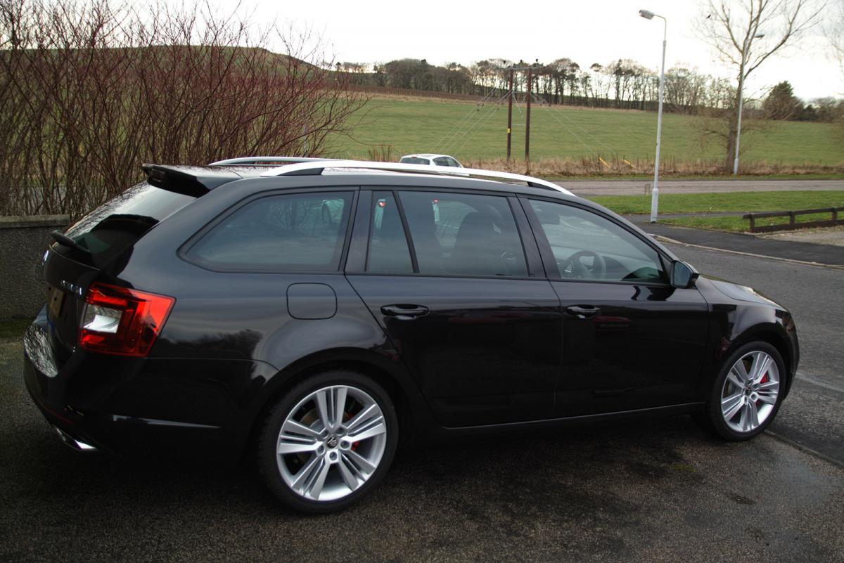

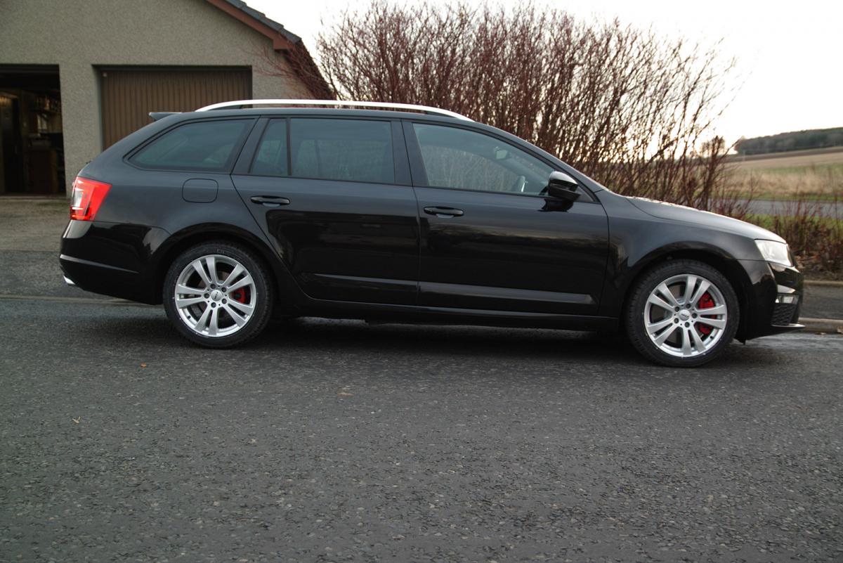

Just fitted winter wheels and tyres to my vRS estate. They're Wolfrace GB DH 17 inch alloys fitted with Avon Ice Touring 205/50R17 93H XL tyres. Here are the before and after pics.
Before:
After:
I chose the Wolfrace because they look similar to the OEM alloys. I've only done a short test drive but the ride seems smoother and quieter than on the 18 inch OEMs.
Edited by Gary_UK

Thanks for that, looks good.
I've currently got Pictoris with Race Blue.
Do like the Black as well

The only other thing I needed were spigot rings as the wheels are for Mercedes hub size of 66.6mm and the Skoda is 57.1mm. The alloy wheel seller forgot to include these, but I bought them from Ebay for under a fiver.
