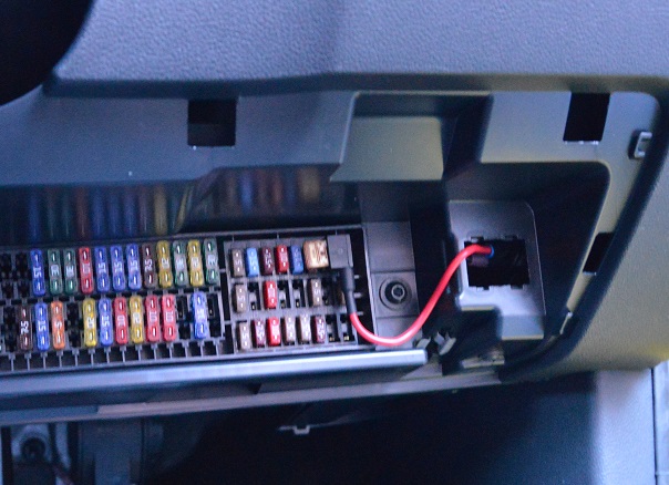

Yes, I have fitted one in a Rapid.
It's very easy once you have an idea what you are doing.
Cable along under the headlining, down the inside of the rubber trim between the door opening and A post and straight into the fuse box.

This is the live to the fusebox and which fuse I used for an ignition live.

You run the cable to the top corner of the windscreen under the headlining, then round between the headling and A post trim (push it between them so you can't see it)
And then go down the A post behind the door rubber.
Like I did on this LEAF. (note LEAF fusebox is on the other side)
Then run round the top of the A post trim, it just pushes in with the lining bouncing back afterwards.
I got the piggy back fuse on ebay.
