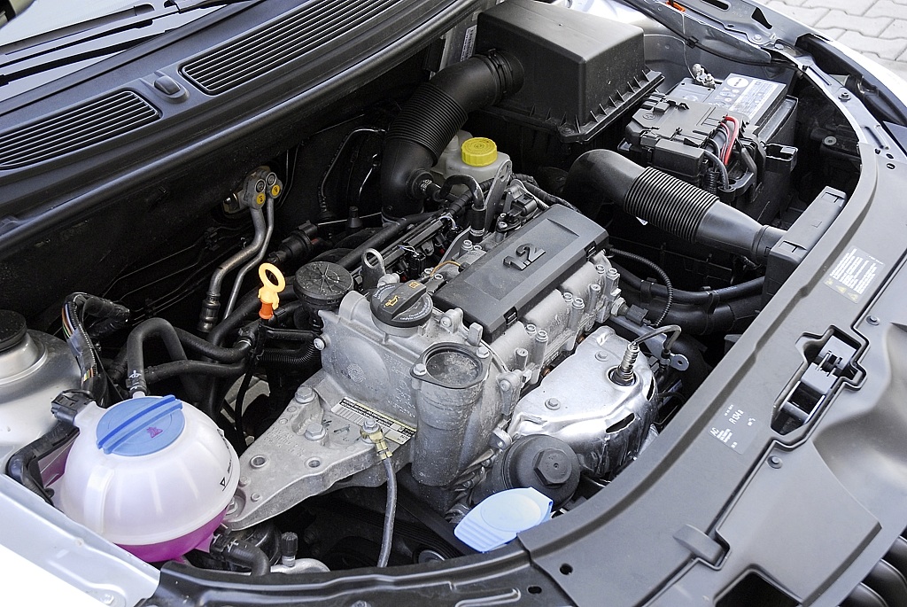

Is anything missing on this engine ?
Hello. I am planing to buy A skoda fabia from 2010 1.2 TSI 86hp with 100.000 km, bought as new, first owner, service history. The price is 3400 euro wich makes me very suspicious. He told me that he would accept any tests... In will go and see the car on monday. He sent me a picture with the engine witch looks to clean and i think something is missing. I'm kinda paranoic because of this price :) The car has the front wind screen cracked and the passanger door is a little bit pushed inside.
Thank you and i'm waiting for your comments.

I don't think that's a tsi engine
No it isn't.  Looks like the htp engine to me either the 60 or 70PS (can't tell the difference just by looking at it).  A good little engine provided you're not a boy racer but certainly not the TSI engine.

It is a 1.2 16v, 60 or 69ps 3 cylinder is it not!
Looks nothing like my 2011 1.2 TSI engine.
Thank you for your response. So i should stay away from this seller. I dont understand why would be bother to make a test at Skoda service if he new that the engine was damaged...
Not damaged,
a 1.2 tsi is a 4 cylinder, 4 piston engine, that one is a 3 cylinder engine.

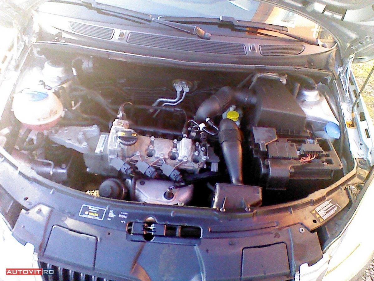

Thats the same engine as mine. Only its missing a cover. Its a 1.2 htp. And looking at that second picture the spec is an 's' so the engine will be the 6v 60hp version.
The 1.2 tsi is a Cracking engine, but that isnt one. So id keep well away mate. Makes me wonder what else hes hiding

Id also be curious as to why its missing an engine cover. Somebody been messing with it? I may be wrong, but im sure it should hsve a cover. Mine has.
Also, is it the prefacelift? Because a few things look in a different placw than on mine. So makes me think its the pq24 platform prefacelift

The engine shown is the base 60ps 1.2 htp 3 cylinder engine 6 valve version (pre facelift) i. e. the lowest powered engine found in the base model.
It is NOT a 1.2 tsi 90ps engine.

Does the 6v usually have an engine cover do you know? I know the 12v does
Engine covers (with in built air filter housing) disappeared on the 3 cylinder petrol engines when the mk1 finished in 2007. It reportedly saved Skoda around 18 euros per vehicle iirc.
Iv got a 2013 12v an it has a cover on the cylinder head, and the air box is separate.
I was just curious why this 1.2 htp 6v has no cover on the cylinder head. Whether its never had one or somebodys taken it off

That cover is only for the 12 valve variants (dohc), needed as the plugs/pencil coils are located in the centre of the head down long tubes in the rocker cover. These presumably could fill with water.
The old 6 valve (sohc) version didn't require it as the plugs are forward of the head. From 2010 the 6 valver was dropped and replaced with a detuned version of the 12 valve.
Ooh. Thats the answer i was looking for. Thankyou very much :).
