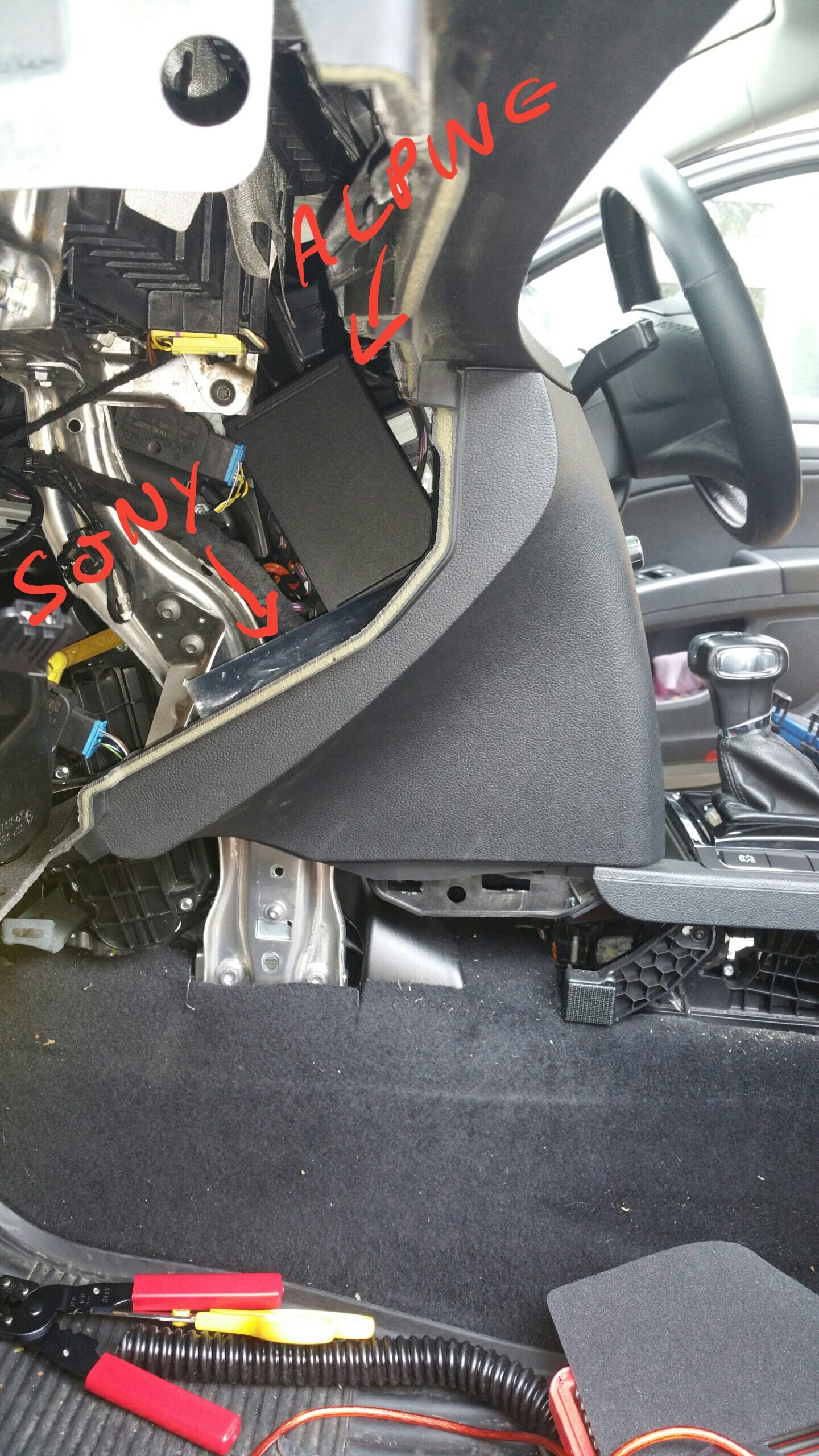

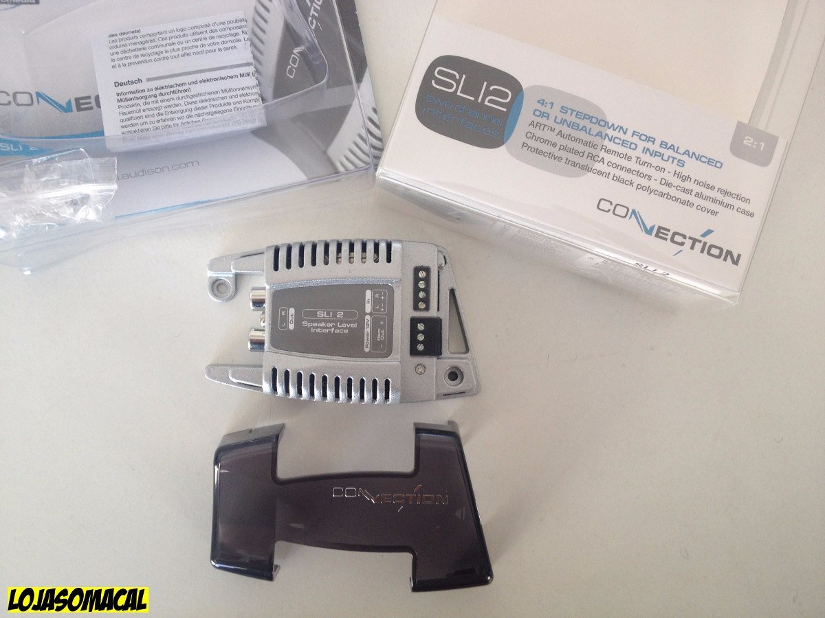

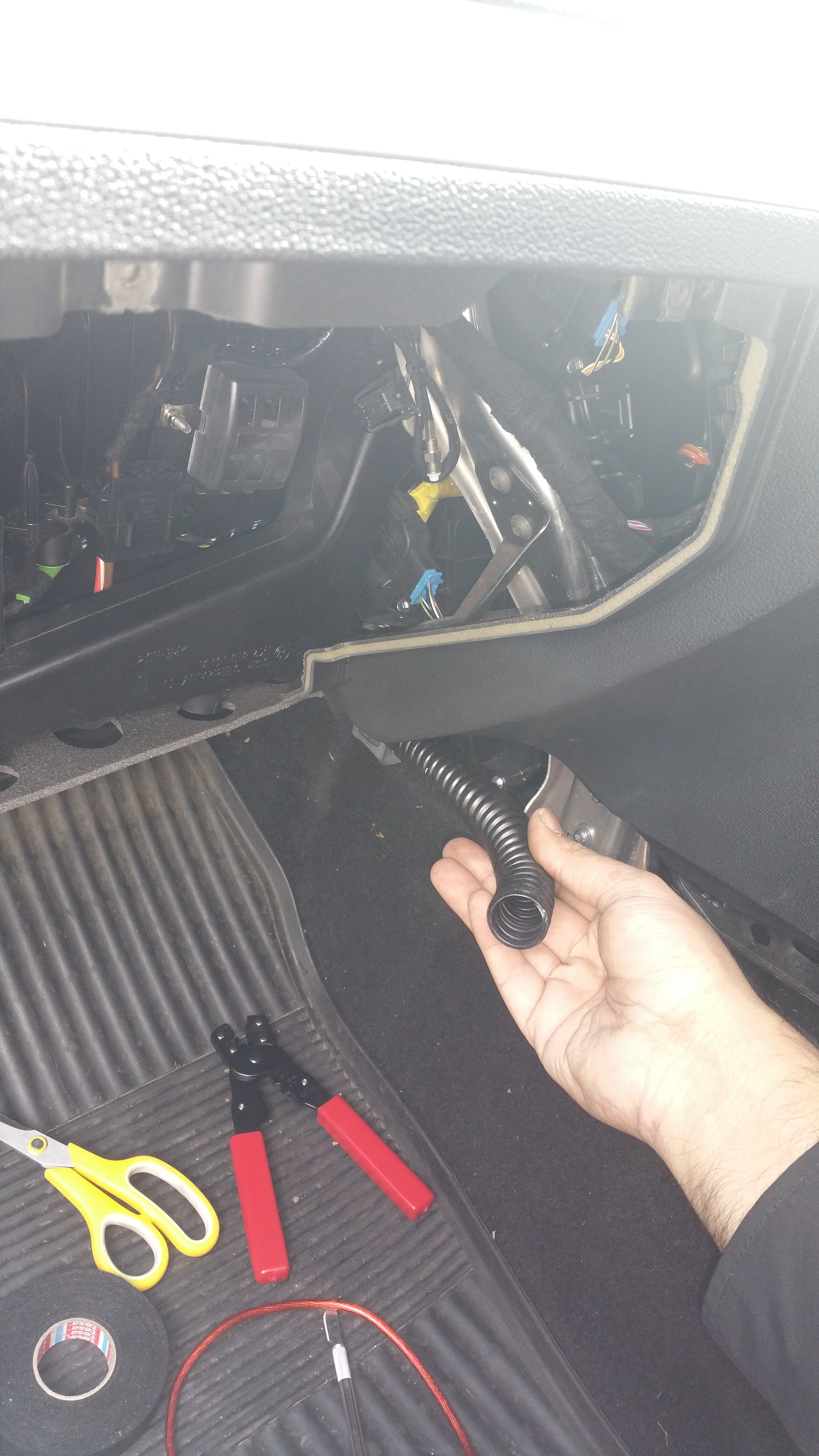

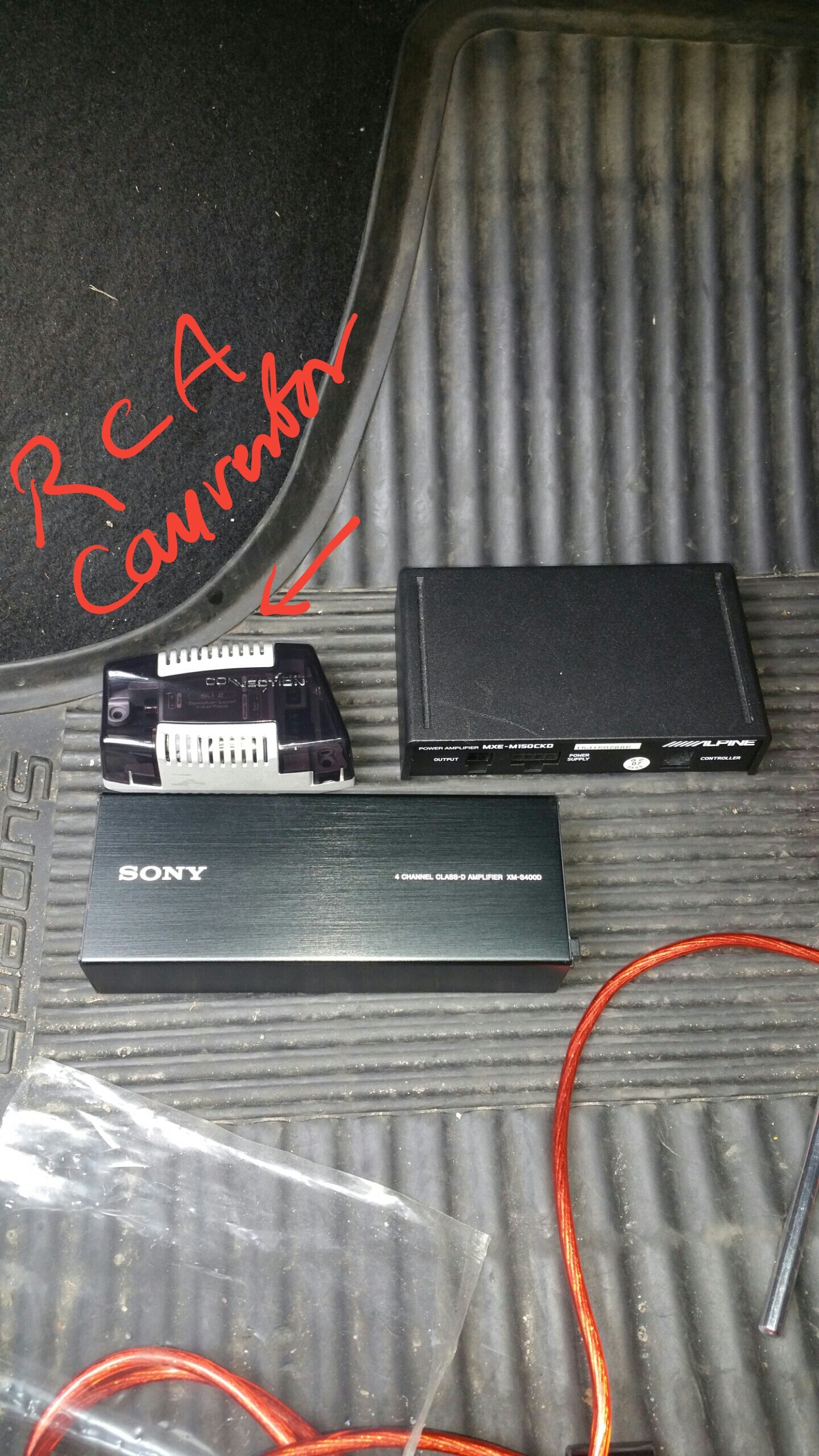

On my bolero there is no factory amplifier so ,  I tap in to speaker cables at the back of the stereo with a Denison SLi2 RCA converter around £50. ( if you have factory amplifier running speakers then you need to tap in at the output of amplifier with this converter.
This converter has no remote IN but it does has a remote OUT . It powers on ITSELF after detecting signal from speaker wire and triggers your Sub AMP ON.
I have pinched a tiny mono amplifier from an alpine SWE 815 ,70 watts RMS to run a mazda 6 wheel subwoofer .
Also a Sony xms400D 4 channel 50 watts rms x4  running Panasonic EAB component speakers all around.
The amps and RCA converters sit comfortably behind glove box on to the side and I am happy to report that the system ROCKS
The glove compartment has a pipe running into it blowing cold air (  I think it's there to keep cool whatever you may have in the compartment )  I cut this pipe at the back and point it onto the amps to keep them cool

Make that an Audison SLi2
conversor-rca-2-vias-connection-audison-sli-2-D_NQ_NP_236321-MLB20767110089_062016-F.jpg

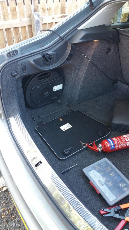

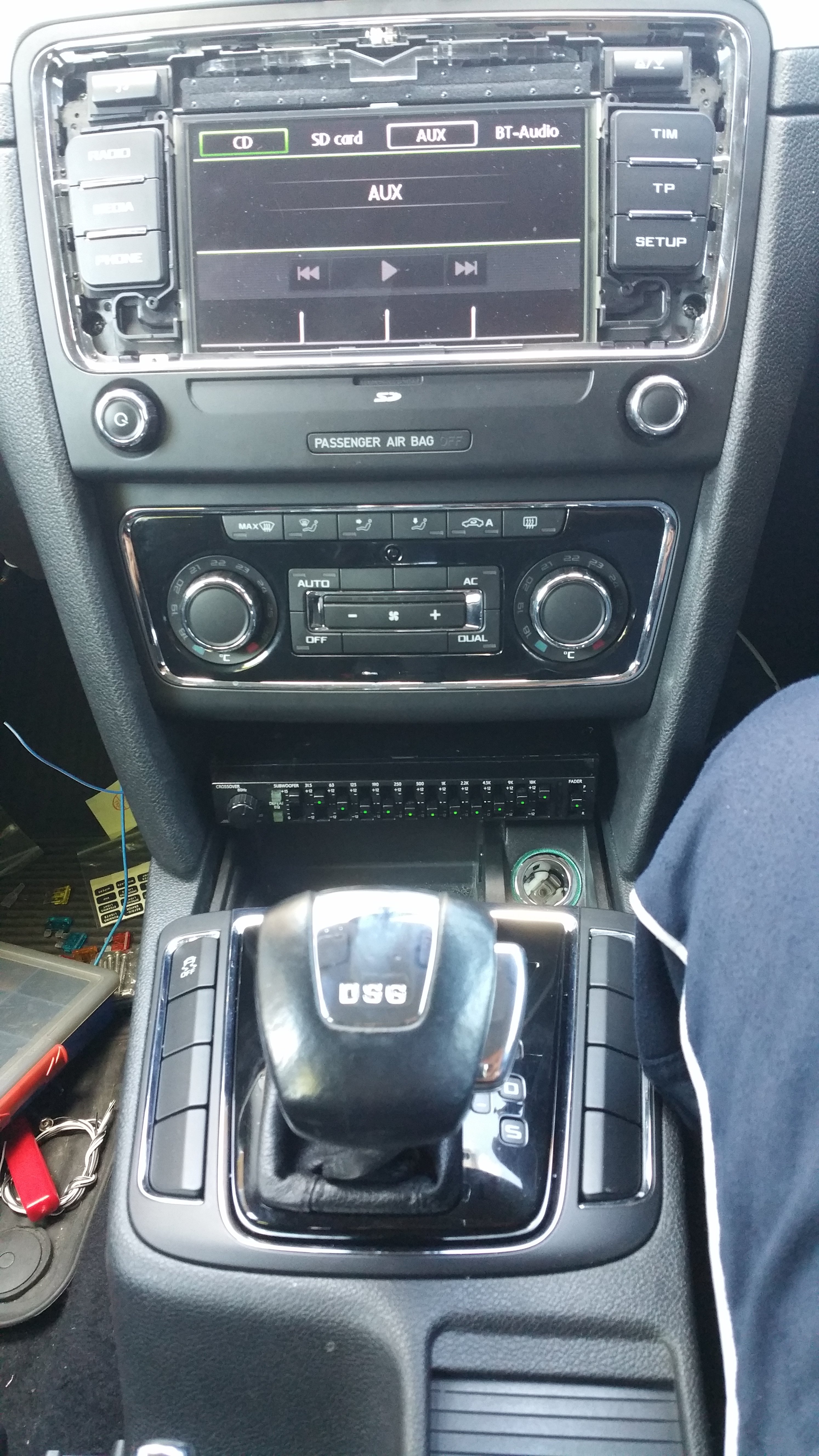

G thanks.  Also added an old school alpine equalizer and the highs are so warm and smooth. Bose subwoofer hides perfectly in the boot pocket  :)
I'm bragging now ain't I

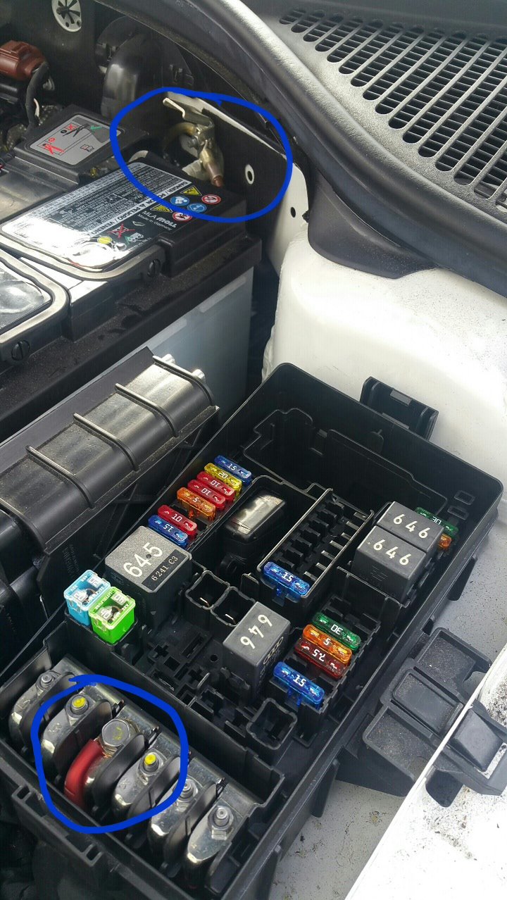

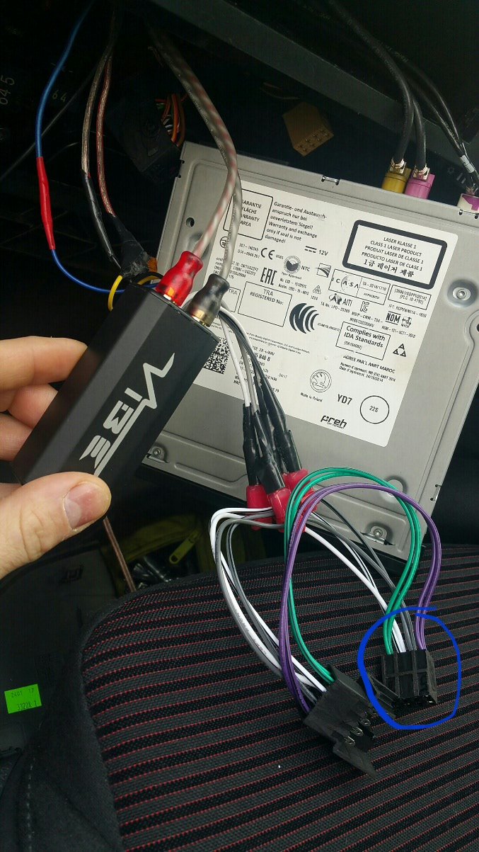

Hi I'm new to this forum. I have 2017 octavia 1.0 tsi start stop. I decided to add sub and amp. Combo to the stock bolero head unit via line level converter. Everything is working fine my loc is turning on with ignition on (powered from fuse n 48 acc power)and providing remote turn on for amplifier when head unit is turned on. I run my power from connectors in engine bay fuse box and ground wire from main ground point in engine bay behind battery control module. My only problem is start stop showing error message when amplifier is working. When I disconnect feed to the amp start stop works fine. (I checked the battery and is fully charged). Thanks for any replies and help. Hope that I posted in right place.
Would you share pictures of all the connections you have made to run the sub.
Also can you undo all the connections for sub and see how that effects your start stop function
Edited by 9@zA
Hi thanks will take some later. When I disconnect the power going to subwoofer amplifier start stop is fine.
So I made adapter to extend speaker wires going to head unit as I dint want to splice into the originals conected the line converted and rca to amplifier. Power is coming as on the pictures. Ground on main ground point behind the battery and power in fuse box. The highlited connector  go to quadlock on the head unit. 1362490642_2018-10-2512_41_48.thumb.jpg.29bc4167429b3e3fec7bf59817f61c73.jpg634394706_2018-10-2512_41_09.thumb.jpg.1984e38936fe10e66f9275fa29a6b844.jpg

Running the power from the battery was a PITA, i was planning the same as you have done as there's no easy way to safely connect it to the battery post. what fuse holder did you use?... i can just see it poking out.
Fuse holder is the one which came with cable I just stick it in the empty space in fuse box. You can fit cable strait to the battery terminal you just have to undo the screw but it has some kind of safety washer which I broke and then I had to cut new thread but now I can fit o ring terminal there if I want but wanted to hide the cable. In few days I want to add fast plug for amplifier so I can remove it fast when in need for space. My only problem is start stop which doesn't work when amp is connected. Will add few more pictures later.
