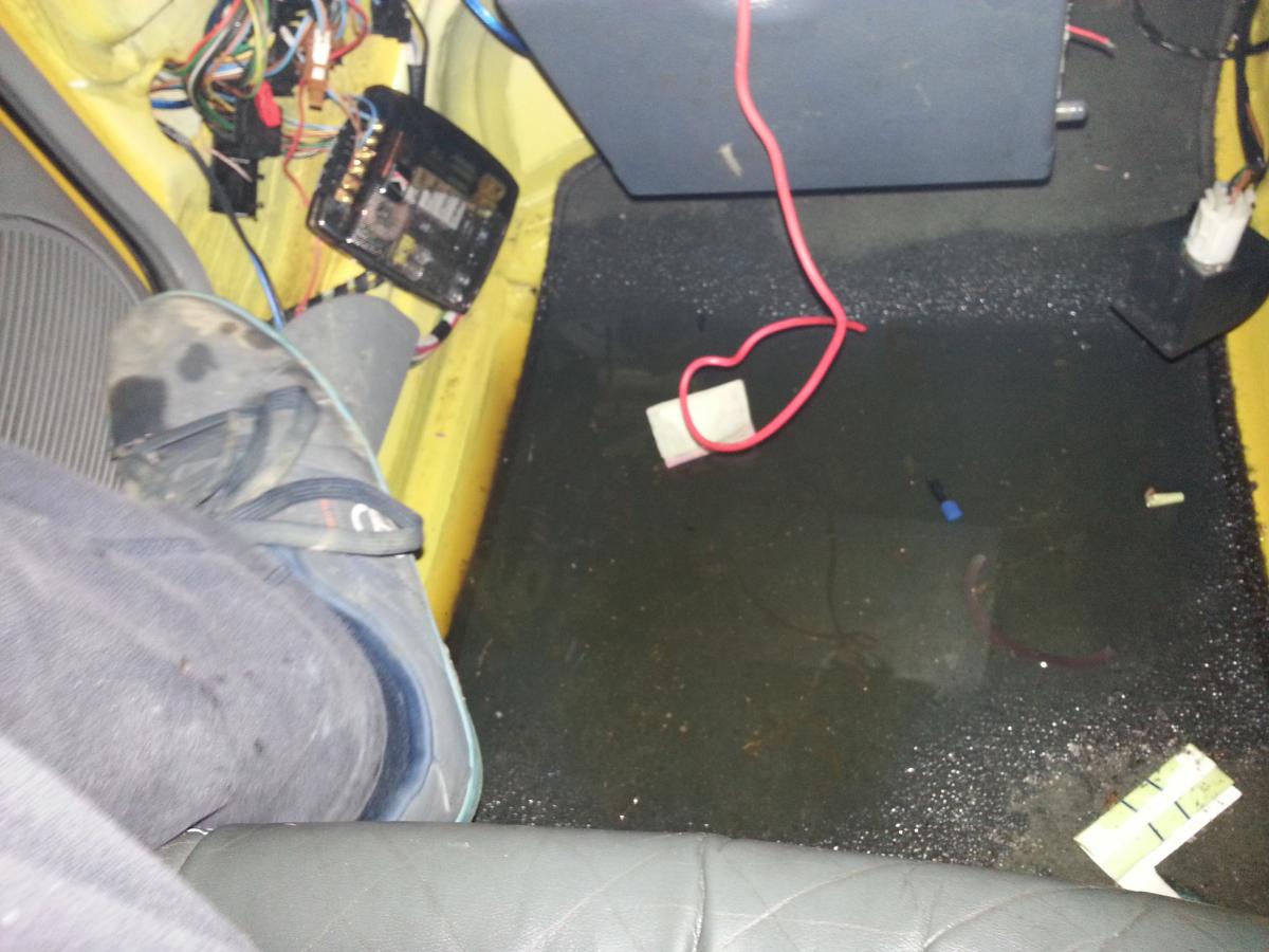

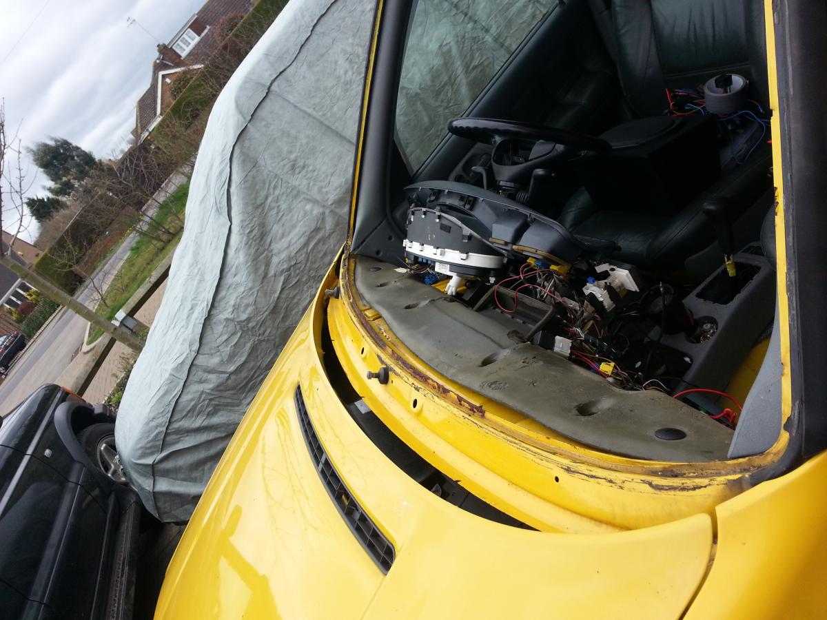

I've had an ongoing problem with this - mainly on the passenger side.  Over the last 6 months I've had two different windscreen companies refit the screen with a new rubber seal on each occasion, but the problem still persists.  The water seems to be coming into the cabin at the bottom corner of the windscreen, then running down the inside of the panel below the windscreen and then down the outside of A panel in front of the door.  It ends up dripping onto the multi-way plug shown in the top of the 1st photo above.  I've removed all the carpets and as a temp measure drilled a hole on the floor at the lowest point to let the water run out.  What's odd is that where the water is coming in at the bottom corner, it appears to be coming through between the glass and the rubber seal and not between the bodywork and the seal.  I can see the water seeping up behind the glass and then running down the inside lip of the rubber.   I have a feeling the initial source of the problem may be (as has been mentioned above) a problem with the rubber seal on the roof above the door, with the water then running down the inside of the pillar/seal.  When the weather gets a bit better I will have a closer look.
I have just broke my window screen lol brand new rubber and screen being fitted and this rust being fixed of its still coming throw rubber then it needs more sealing my slxi felicia leaked had that screen out no rust and a hole tube off sealer used and thats leak free mine comes throw the metal where rubber goes in the middle and passanger side...
the rust it has on the metal skins...
