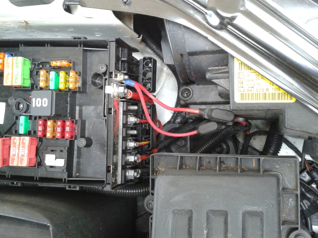

I would like to use one of the vacant fuse locations in the front fuse box but can't work out how to even get access to it.  There is a bolt in the center of the fuse box that is captive indicating it might be used for jacking the top plate off, but I'm frightened of breaking it if that's not the intended purpose.
This will be for the 20 amp charge wire to the Anderson plug on the van and will be taken off an ignition "live" supply or have a relay to isolate it when the engine is not running.

Brijo Thanks for the link on the DSG - very reassuring Our van has a maximum weight of 1600kg so do not expect any trouble Have no intention to go "off road" so that won't be a problem either Jurgen (originally from South Africa) are the only local builder here to have less than 120kg tow ball loading so for the Yeti, it's about the only horse in the race Fireblade thanks also Will pick up the supply wire for the power socket behind the fuse box, then double up to an an empty fuse slot for the brake controller The Electrics kit I got has a stack of wires and connectors that weren't required with the towbar prep, so I will just use some of them a65rocket I was hoping to use one of the spare fuse slots inside the front fuse box to avoid having the inline fuse holder floating around at the front of use box. There are plenty of them so a pity one can't be used Do you know how to get the inner top fuse plate out of the fuse box to gain access to the cabling underneath ? The screw in the centre of the plate (red arrow in photo) has a captive cover for no apparent reason I'm hoping it is a jacking plate to lift that top plate, but I'm not game enough to try in case I'm wrong All the fuses will have to be removed first but a close photo will enable them to go back in the right spot

Things are very different to the uk
Here is a picture of 2 wires and fuses. One goes to the three way fridge in the caravan and the other to to charge the caravan battery when travelling. I assume both are only live when the car engine is running
Thanks a65rocket
