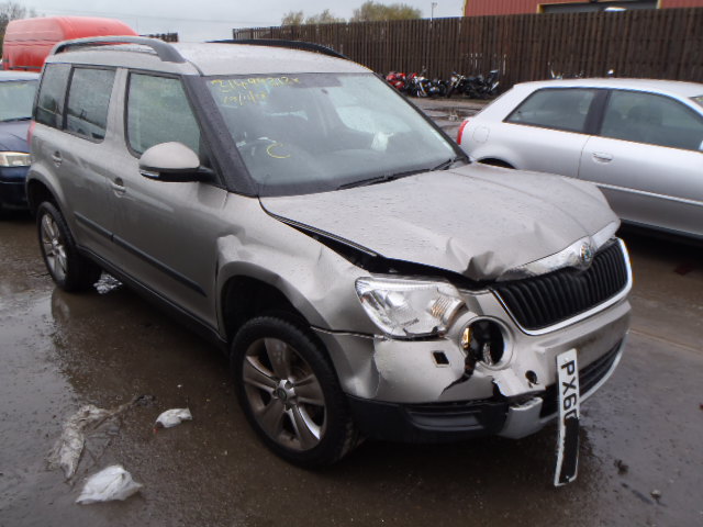

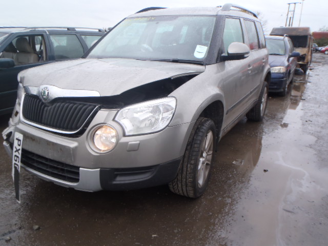

Hi this my new project I got it from a salvage company with only 18.000 mils
Interesting.....
I would say the biggest problem is going to be checking the suspension and steering geometry is spot-on. Other than that it is probably just panel damage and new air bags. Won't be cheap though!
The suspension is good steering is fine the damage was just above the chassi. It needs front bumper,bonnet,front inner panel,o/s front wing washer bottle and headlights

Damage looks quite mild to me, certainly nothing that'll be tricky to fix.
I would still get it properly checked and aligned.
It is surprising how easily a front chassis leg can move even if there is no direct damage to it.

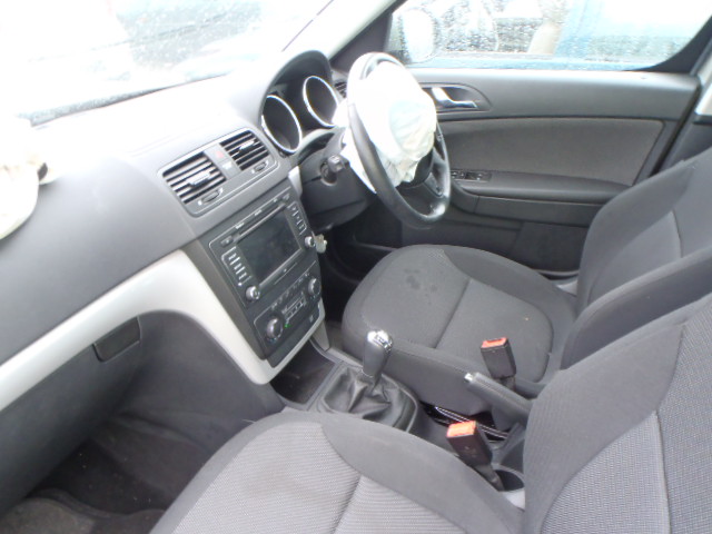

This is going to interesting. And a very steep learning curve I think.
