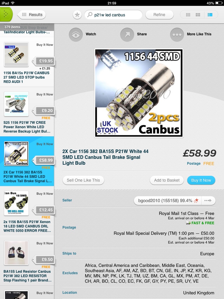

These look impressive ;).
Almost cheaper to pay your insurance excess when you bump something thsn buy these though
But there is no p&p so its a bargain ;-)
Didn't see a reflector but tbh didn't look. I wouldn't have changed it but for the fact I had one knocking about.
Sent from my GT-N7105 using Tapatalk
Free p&p makes everything a bargain!
These are almost identical to what I have in my DRLs but I only paid £9 and they're Canbus error free.
But did you get free p&p mate? ;).
Sounds like you got a bargain then. Aslong as theyre half decent quality, and work every time, your onto a winner :).
