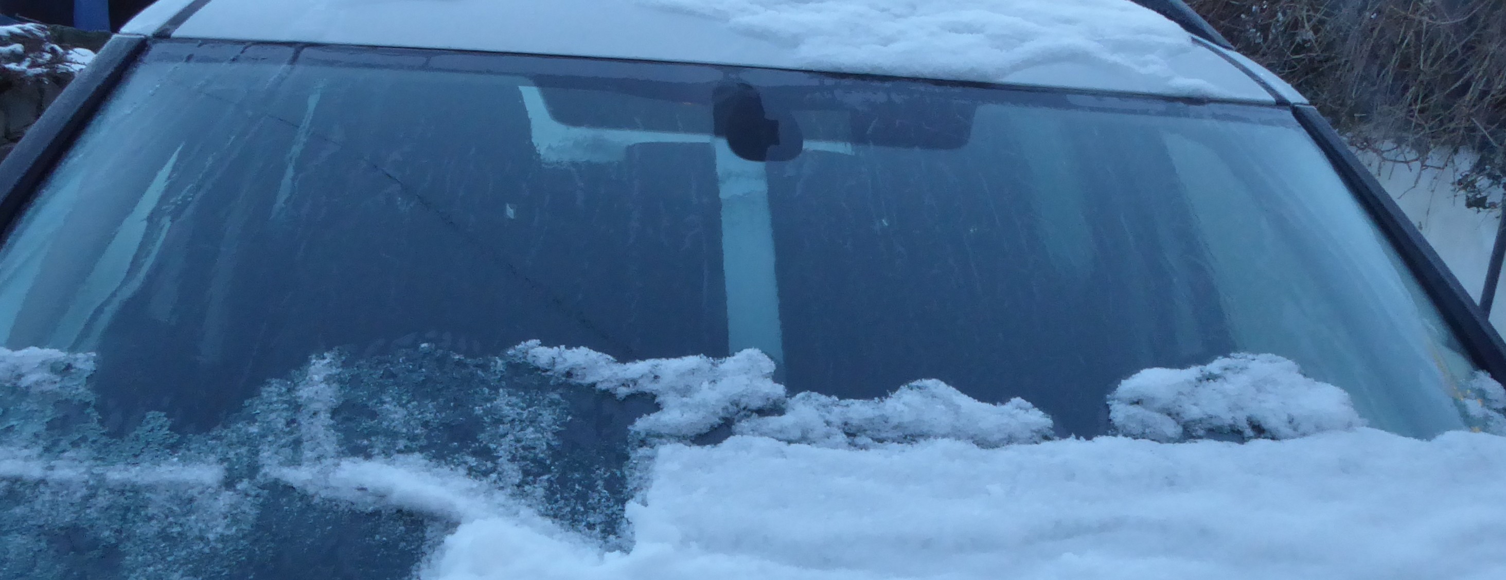

Heated Front Windscreen operation.
Having just had the chance to test this properly -
Is it normal for there to be a gap in the heating down the centre (vertically) of a few centimetres ?
Edited by rarrar
Not on either of my Heated Screen versions. Think there must be a partial element failure.
Nope, not on our heated screen.
Edited by TruckbusUK
Thanks guys, will raise the issue with my Skoda Dealer before the lease expires ; will get a photo as evidence.
There is a slight gap in the centre of mine but the gap is because of a gap in the elements, all elements work fine.
Not too concerned as in practice it doesnt make much difference and the 90 miles round trip and a 1/2 day in Carlisle is a bit of a pain.
Think this is the first time since new its ever been needed.
Some elements are definitely not working !

I think this one is very easy to explain. Your car had had a windscreen replacement and someone ordered the wrong windscreen and decided to fit it regardless. The Yeti has many front windscreens - with no rain sensor, with sensor, with rain sensor and heating, etc.
You could probably wire it to a separate "secret switch" somewhere but I suspect without the associated VCDS changes the car won't know the windscreen is there to make it work.
I bet it is more difficult than that as there will be no wiring to the screen to connect to, no relay or switch fitted or associated wires in harness etc. And probably needs to be coded to car for switching off after a set time impact on charging and more.
