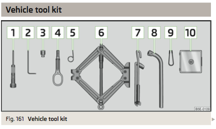

Putting the wheel back on is indeed a painstaking task. It has a very thin mounting support so you have to apply a lot of pressure from the front of the wheel, but also from under it. I've never had a car with such hard to mount wheels. A mounting stud would really help but it's not included. I never knew that thing existed but for cars like this it is surely needed.
But a stud cap plier is included in the original toolkit and it works very well. If you don't have it you should talk to your dealers. I have it and the manual also shows it.
9. Extraction pliers for wheel bolt caps
