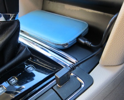

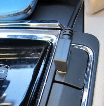

I modded one blank on mine to carry a std USB Socket. Just have a short lead plugged in and my phone lives on the sliding lid of the ash tray. No need to access phone once twinned as can make/recieve calls & text without touching phone. Its also charging continuously. USB is a power feed only when ignition is switched on.
Sounds great!
Can you describe how you did it or put up pics?
RBurke, see pics below. Ran a fused feed from Fuse Box, which becomes live when ignition is on, to a std USB charger, and linked this to the USB socket I fitted into the blank at the front drivers side of the gearchange. Got a short USB cable from Fleabay and charges whilst on the go, with phone secure but handy!
Thats excellent Napier  :clap:
