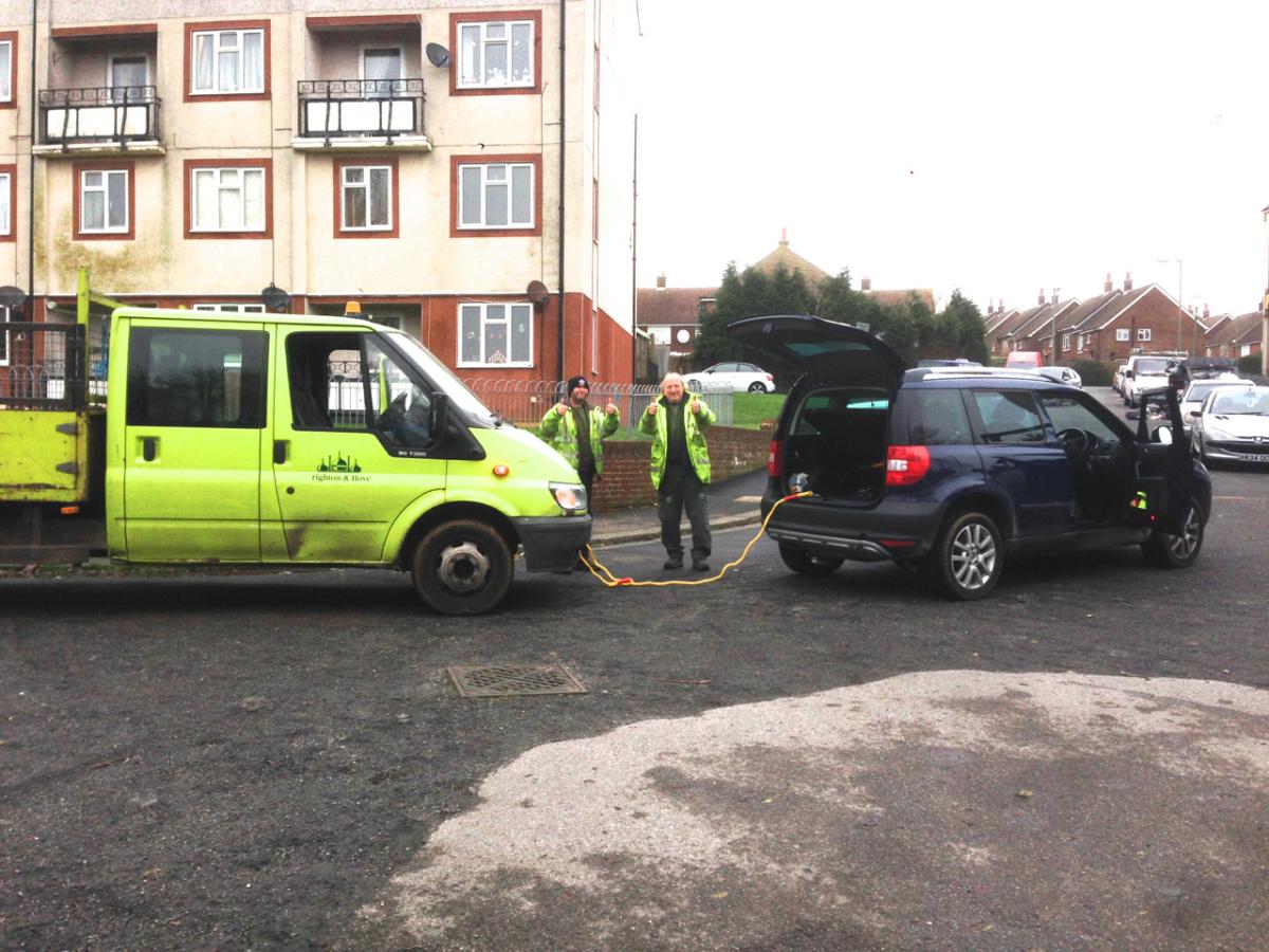

I have never towed a caravan, but some months ago my local council got their n the mud in the local park, and Ivor made easy work of towing them out :)

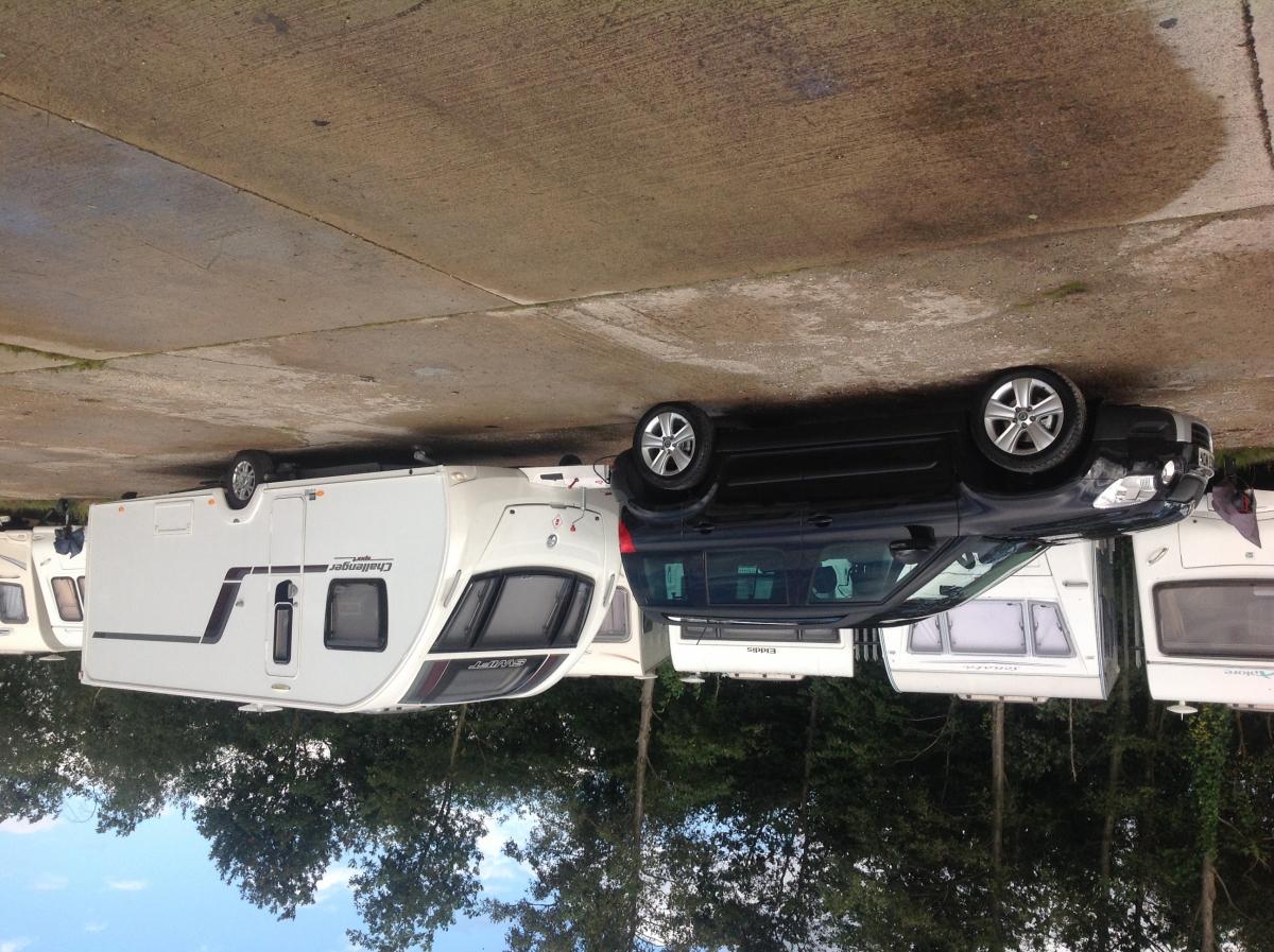

I have to say the caravan (24' MTPLM 1461kg swift challenger) behind the yeti looks good, tows great and even in a gale force cross wind that was pushing lorries around was manageable.
