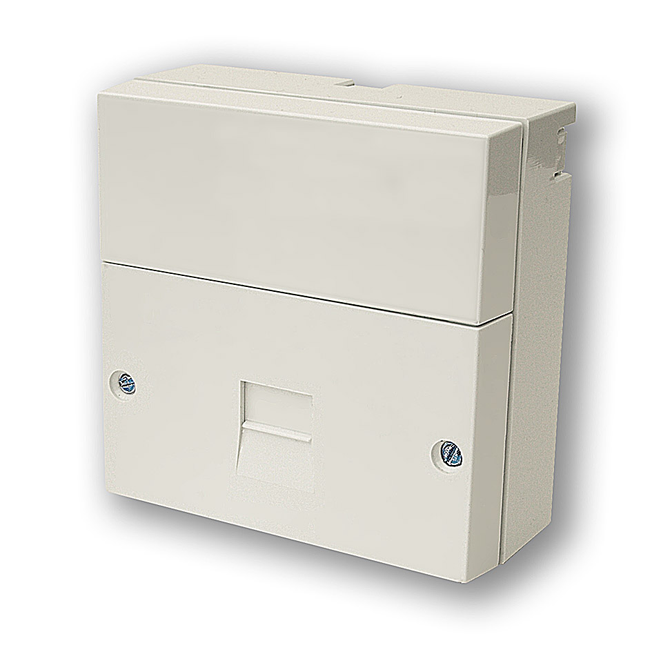

the 'main' socket should have a lower cover on it.post-73816-0-62003100-1398698916_thumb.jpg
This is the socket your router should be connected to.
You need to test it with a known good filter in the test socked - which is behind that removable lower half of the master (you will see what I mean).

As above really - need to try and find out whether that is the master or whether the other socket is the master. I can take the cover off the other one.
