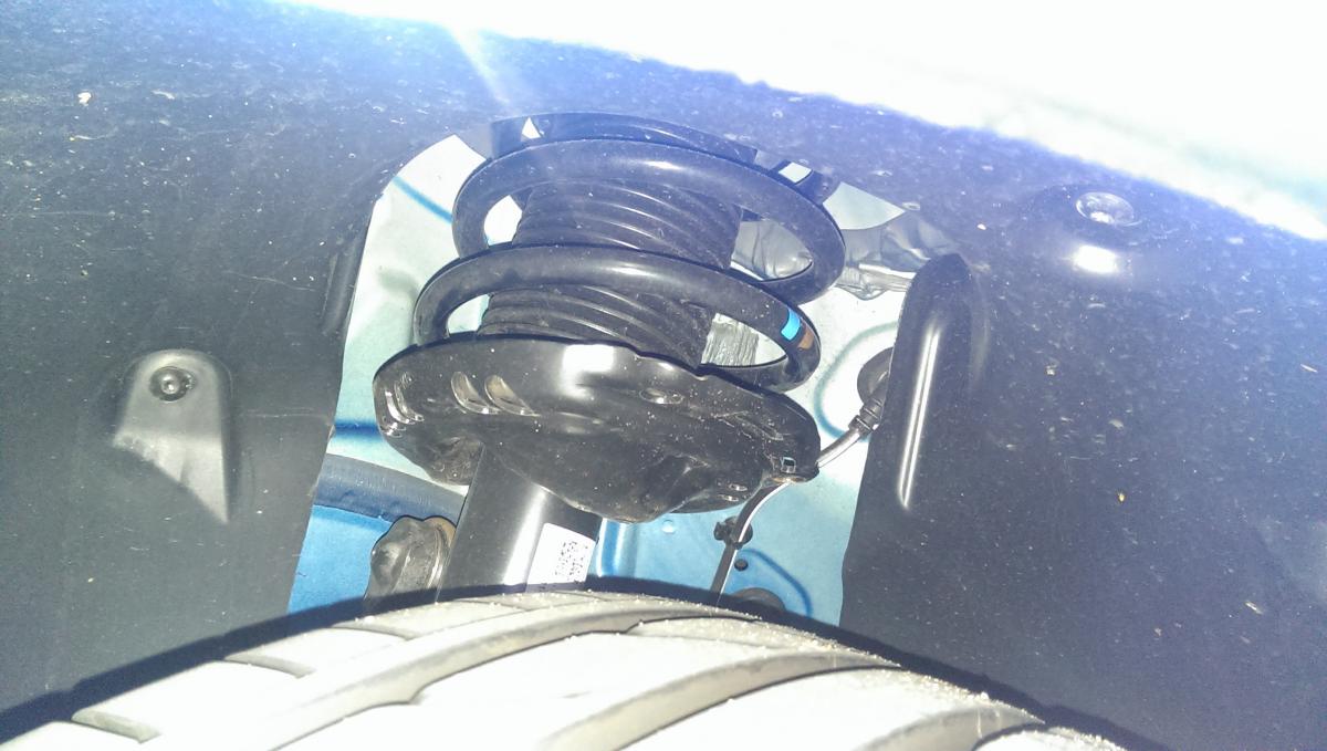

A month old. Here's the pic with the saucer thing at the bottom that is preventing me lifting the gaiter more than a few mm.

Looks OK.

Yep, the corrugated plastic is the shock absorber piston gaiter. You should be able to lift the bottom up a few centimetres if you put you fingers between the spring coils.
It will only lift a bit. Don't want to split it. Oh well better just leave it. Thanks for the help :-)

Fair enough, no worries. As andyvee says, if you hit a bump and there a knock from the wheel then there may be a problem, but if not then I shouldn't worry. Of course, failing that you could always ask your dealer to check?

The saucer is technically known as the lower spring seat :)
The corrugated bit is quite flexible, you are unlikely to split it. If you lift it up a few mm and can see the stainless steel piston rod right at the bottom going in to the 'saucer' then the spacers have been removed.
The bit I can see under the sheath isn't stainless steel just black on both sides.
Plastic or painted steel?
Plastic like a clippy bit but not like the bits on the photos on this thread.
Is there enough room to get a piccie??
It's hard to hold the phone and push the gaiter up. Will try tomorrow.

Jacking the car up does make it a lot easier and you'll need to do it to remove them anyway if they are there. I did struggle a bit with the gaiter myself before jacking it up, I think it was sticking on the blocks so had to push it straight up instead of pushing one side.
