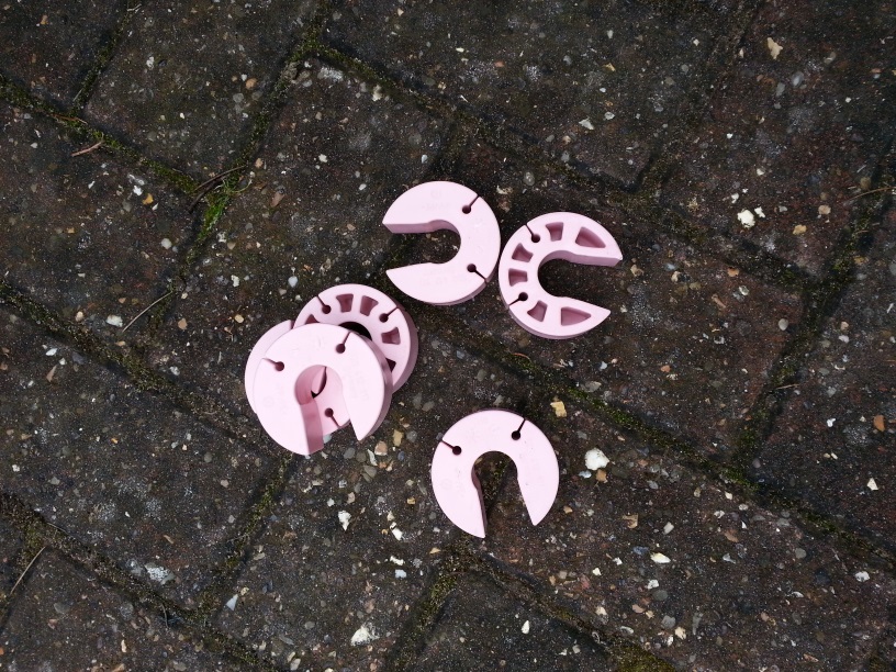

Hi all,
Just posting this in case you are interested. I had the front wheel of my car off today, but found these underneath the dust gaiter of the shock absorber. I have now taken them out (as they obviously aren't supposed to be there), and the car rides much better. Before the ride could be very clunky, but I am not surprised now as the shock was obviously being restricted. I wouldn't like to think how long it could have been before they were found!

  • That's not a warranty repair. That would be at the cost to the dealer, skoda would wash there hands of it and then give the dealer a roasting.

The PDI should have had these removed after the car had been Transported.
Why you need to go over everything yourself when collecting a new cars,
If the tyre pressures are no set, that is a good indication to look closer.

Wow that doesn't look good, I would be having words with the dealer over this, that is not acceptable and shouldn't have been missed.
I'd speaking to SUK as that's just not on.
I agree, it should have been picked up by the dealer. They were only in one of the front shock absorbers so I assume they had been taken out of the other side. Needless to say, the car is going into the dealer next week so they can have a look so I will see what happens then about whether I get in touch with SUK.
My only worry is that some damage has been done to the shock absorber when it has been hitting these. But if any damage has been done, I shall get it done under warranty :)
Yes, that's a fair point!
I would contact SUK and get it logged, I suspect the dealer will just say no damage caused.
The problem is not just the side that had the transport block left in the other side will have been effected as well.

Quite right - £25k+ on a new car and a PDI monkey misses off parts of the PDI - makes you wonder what else they have missed.
I would be demanding the whole car checked over by another Skoda dealer at the supplying dealers cost.

I must admit checking for transport blocks was one of the first things I did when my dad got his Yeti.

I've seen this a few times, (I work at a BMW/MINI dealership) no damage has ever been done. They aren't made of a particularly hard plastic.
However, I do think you'll be able to get something out of them. Good luck.
I am hoping that they haven't caused much damage but I will make sure everything is as it should be. Hopefully I get something, they are already compensating me for the late delivery of the car! :rofl:

I took the car back to the dealer, and after an hour of faffing and making sure they looked at the right thing, they couldn't see any damage to the suspension components, but agreed the gaiter on the shock was ripped. So it is going back in next week when they have a new gaiter.
I am going to have a good check over the weekend, but I couldn't see any damage last weekend, and the car drives absolutely fine, so I am hopeful I have had a lucky escape. I will keep an eye on tyre wear though in case the alignment is out. However I am pretty sure that I am not going to use that dealer in the future, there is a dealer with good reviews from other Briskodians in the dealer section which is not much further to go so I will use them instead.

No Neil, they didn't. Hence me thinking I won't use them again. I told SUK about the whole thing, the lady I am dealing with there said she had rung the dealer and told them to make sure they checked it properly but that message obviously didn't get through as they had no idea who I was. The lady at SUK did say that having asked someone else the blocks aren't designed to cause any damage, and said she would ring me on Wednesday to ask how it went today so I will tell her what I thought about it!
Only covered 200 miles in my car so far but the suspension is REALLY stiff and my car is making big boom / clonk sounds when going over speed bumps or potholes. Decided today that I would check for these blocks given its the first day since collecting my car that it hasn't rained.... guess what I found!
Going to be having stern words with the dealers soon, also is it likely they are still in the rear suspension too? I have 4x4 so that has the multi-link same as the VRS. I would check the rear but there are cable ties over the piston sheaths to hold them in place.

HHmmmm I'd better have a look at mine as this might explain why my VRS suspension feels terrible compared to my 2010 FL VRS
Called up dealers but no service department today as it's a bank holiday. Guy who answered was asking me if I was definitely sure it was transport blocks and perhaps I shouldn't be removing bits from my car if I don't know what they are  :S
Will call again tomorrow and get my rear suspension checked and also make sure the suspension hasn't been affected in anyway.

Just looked to see if i could check mine, but dont reckon i could get my head behind the front wheels without jacking the car up.
I managed to check without jacking up by just lifting the sleeve, but jacked it up to remove them as it was a bit tight otherwise, I would guess with a VRS being lower that it might be harder to check without jacking though.
