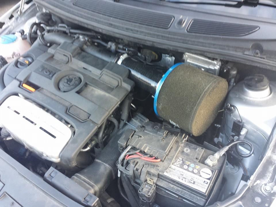

Hey guys as you know, I was making a homebrew induction kit for my fabia heres a copy and paste from facebook.
Induction kit with results fabia mk2 vrs. With results!
Just fitted my homebrew induction kit i've been gathering bits for over the past few weeks.
Huge dump noises, supercharger whine, hear the turbo spooling, not much intake roar but it is a turbo car...

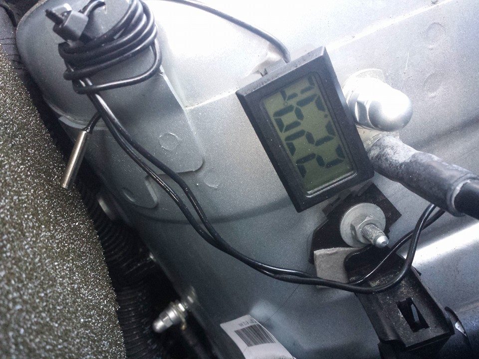

I've just taken it for a 15 minute beat, stomping on throttle, coming off and stomping on it again. 20, 30, 10, 50 mph constant on off throttle to get temps up! Stopping in traffic, Got home and checked the temp gauge it read 22.9oC.
This is what the kit consists of.

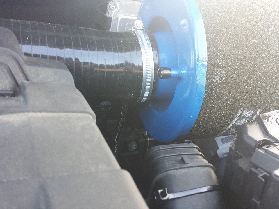

A huge ramair 'monster' filter
76mm Silicone hose with a 70mm inlet reducer. (you will need 70mm if you use a smaller filter)
8mm Barbed fuel connector for breather hose.
330mm Stainless steel bracket.
First impressions, throttle response was unreal, it was instant, very impressed. car also felt a lot faster round the back roads. definite improvement. did not suffer really any heat soak in traffic.
Dont get me wrong, this is a class kit and very well put together, but after driving with the kit for a few hours feeling like a tit, due to constant overly loud suction noises at even part throttle, and what can only be described as a bus braking system going off every time i lift off the throttle i have removed the kit, the supercharger noise was amazing, but the constant annoying hiss was too much for me, some people are into this, i guess its just part of installing an open cone on a turbo car..
this kit will be for sale if somebody makes me a decent offer, if not i will keep it for when i get a NA track car next year. :)

Im glad there are finally some results on this, this was a small price to pay for real life results,
notes since installing airbox, much nicer to live with especially around town and long distance driving, a lot slower, throttle response is gone, can finally hear the exhaust.

there was definately a huge power boost, but as said, no dyno, no proof.
if it wasnt so loud and annoying i may have dynod it in the future. but instead removed it only hours after installing it..
