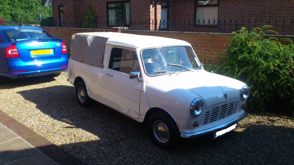

This is mine....... :love:
Have you checked the front knuckle joint that fits in the bottom of the trumpet as the plastic cups are prone to wear.
That's gorgeous :)
I love the pickups, but will never have that kind of spare money.
Looking at it, I made a custom illustration of a very pickup looking just like this one a few years back:
http://www.richardjmason.com/#!cars-digital-work/clkm  <<bottom right on this page.
Guessing it's not yours as that one was on minilites.
